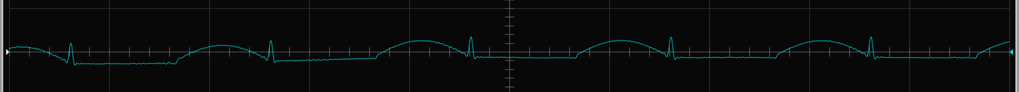

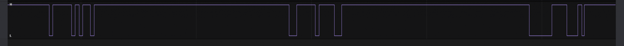

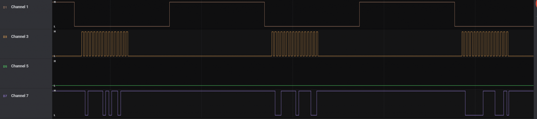

Finally caught some time so hooked up @xaled 's board.
Taking it slowly and double checking everything, looking at pcb, seeing what's what etc.
First looked with logic analyser, everything seems ok.
I connect it up, eureka, we have sine wave...or not so fast 🙂
There is digital buzz sound, i mess around with everything, switching between dacs, but when a setting is not correct it is immediately noticable, and the setting that should be correct is indeed something close to a sine, but with some square wave overtones.
We are playing a pure sine wave, so the signal should remain constant. But look at the data line (purple).
The data lines are fairly "jittery" and change their pulse widths all the time. Since the signal is a constant sine, the data lines should be constant too, right? Well, this was a red herring for me because my working simultanous mode Jlsounds board has a similar jittery data line behaviour but sounds just fine. 100 megasamples per second on the logic analyzer, so i dont know if its to blame.
DAC IC uses one channel for positive, other for negative half wave, so the two must follow one after the other carefully. Connecting DOR+ and DOR- would be this, but how about connecting DOR+ and IDOR+ for example (i.e inverted version of same signal)?
Well, now they should perfectly cancel out, it will clock in same but inverted signal in both channels at the same time, output the signal, they should cancel and silence should be the answer, right? But actually what we get is something similar to the distortion that is present when normal listening.
There is an exact 20 nanosecon delay between the line and its inverted counterpart, ok, this is due to logic speed. I am not sure if this sort of precision will matter for clocking in I2S.
But assuming it matters, and so it will not combine correctly, i.e due to timing mismatch the other does not "hand off" the signal at the right time. So it would look something like crossover distortion.

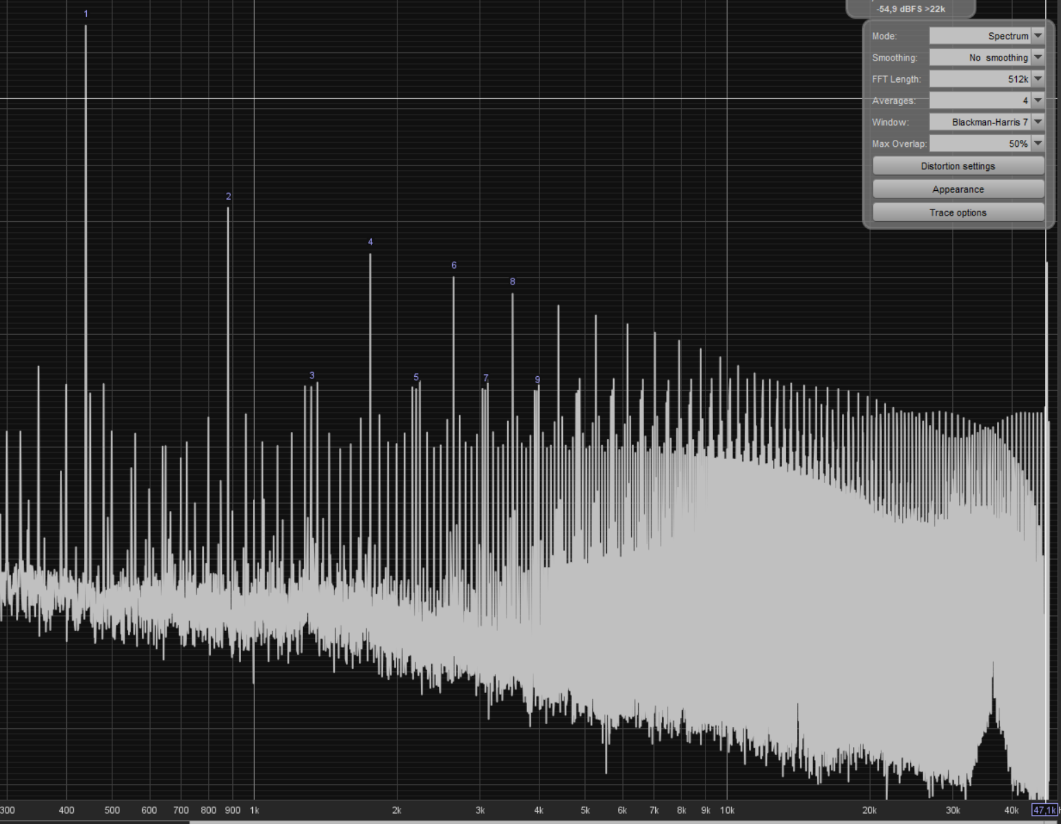

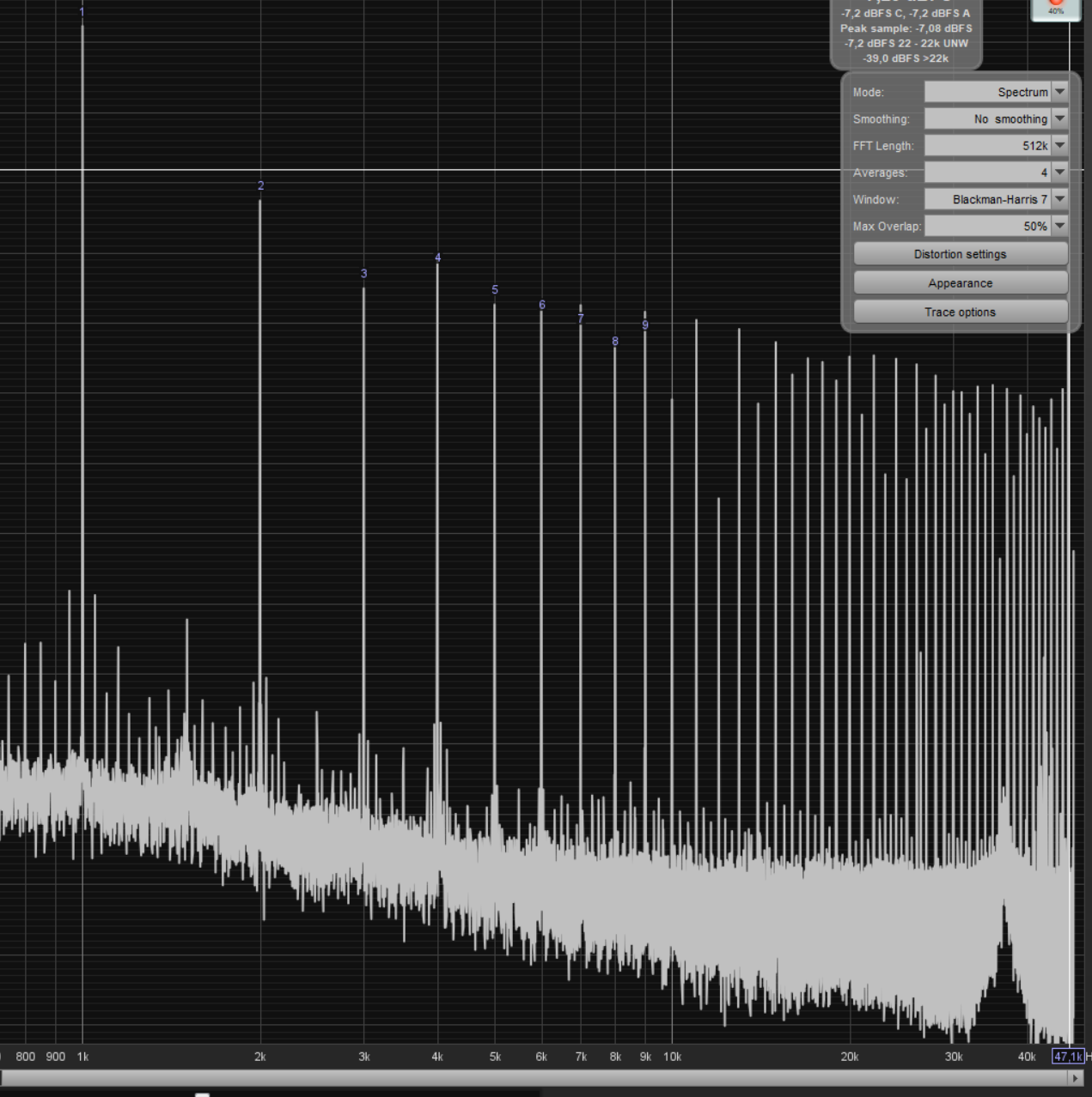

Here is with the correct setting of the signals. Indeed we can see it, and it also seems to be worst at same side of the sine, because the error is consistent.

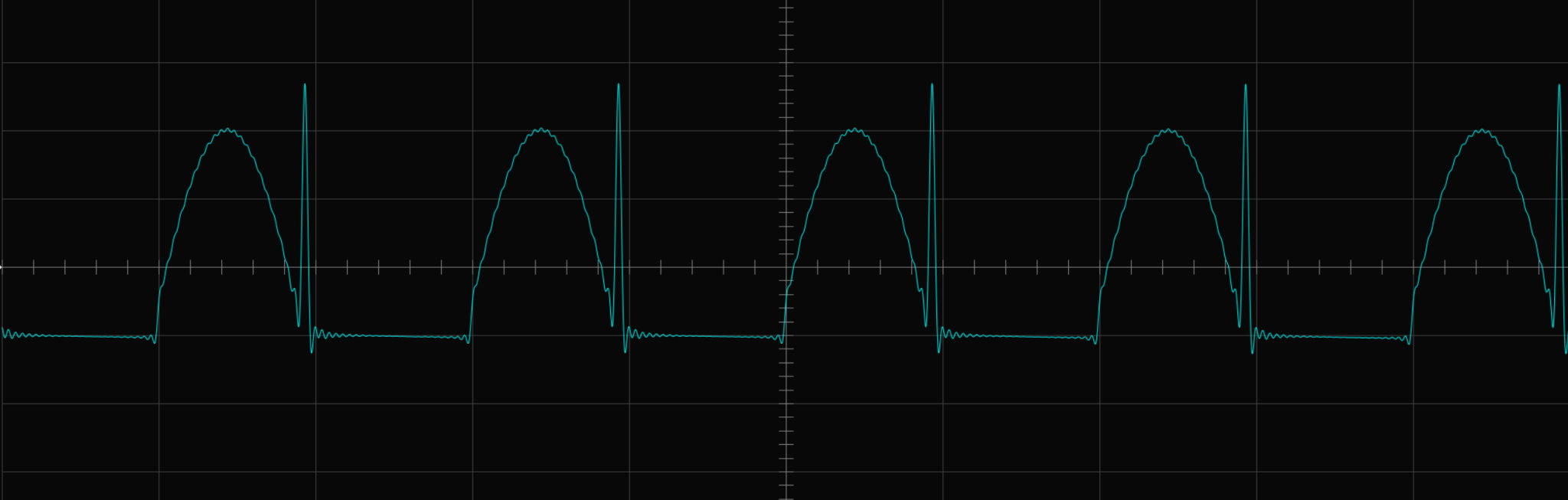

Here is with taking same signal but inverted (DOR- and IDOR-).

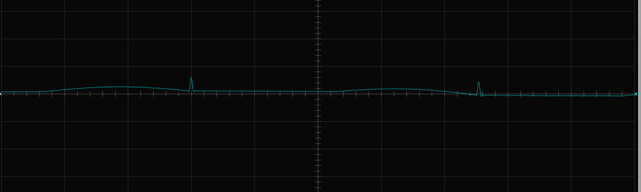

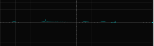

We are left with only the error itself (this is quite audible)
Only top halfwave

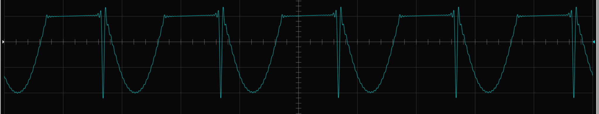

Only bottom halfwave

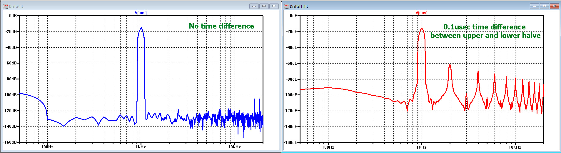

After some digging @Hans Polak already commented on this in post 7206 how timing difference would present itself in spectra.
We have something like
Now would be a question, is this inherent with the schematic, or just xaled's implementation (cant find post now for some reason).
Is this the half bit delay error that was fixed in 7092?
@koldby i think you're one of the only people who had hands on experience with this sort of headache.
Last option is, this is just expected behaviour for untrimmed, just simple summing style and TDA1541A will require mandatory trimming if you plan to use signed magnitude?

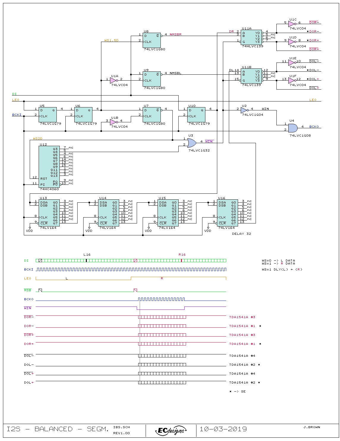

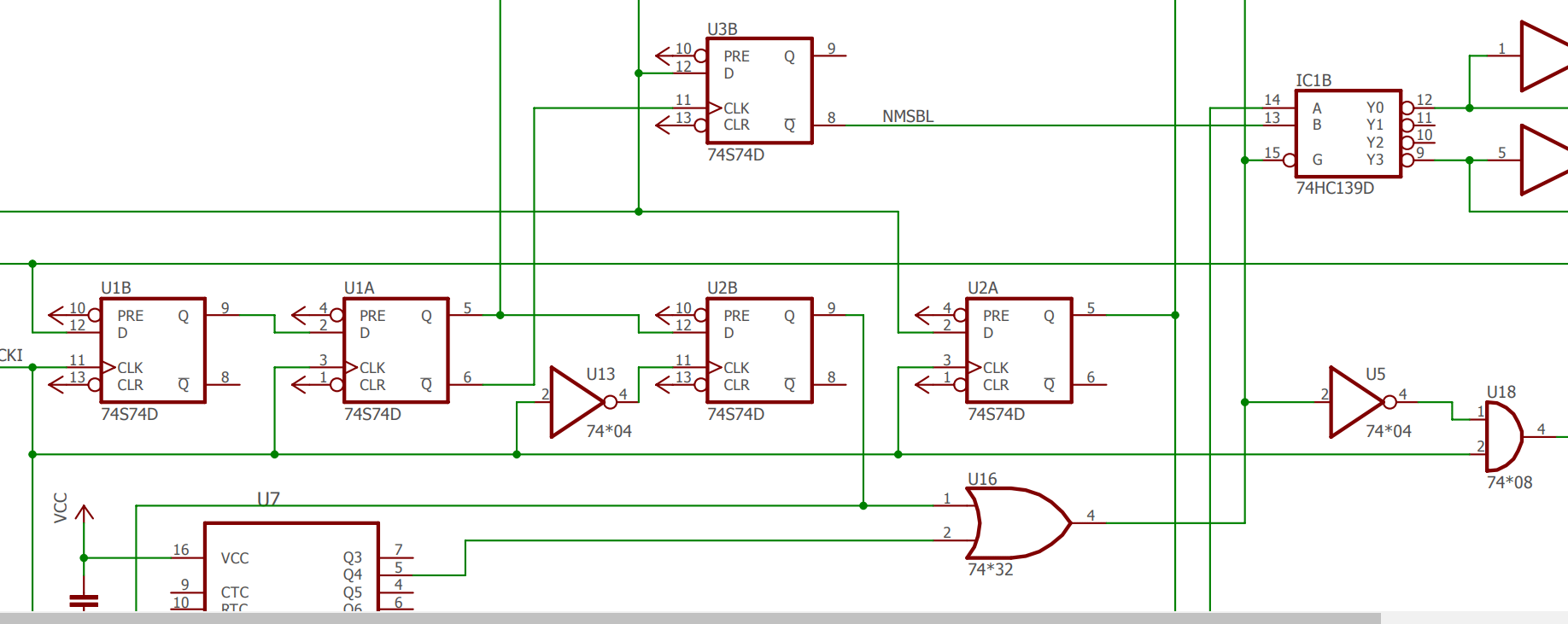

Think there might have been a mistake in the sch used for making xaled's board, notice U2B.
It was inverted in the fix, since original sch was made for left justified, and data was not clocking in correctly, but here its still non-inverted. Also smart use of complementary output of U1A to eliminate one inverter (also U1A in John's).

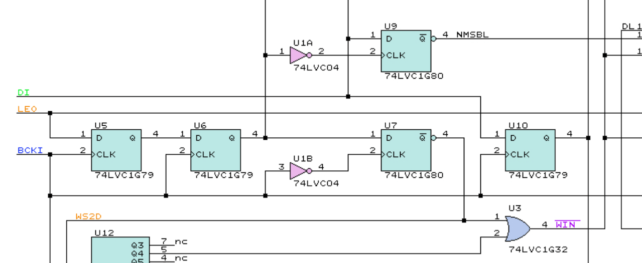

John's revised sch in 7092, look at U7:

Here is my original schematic from 2019,
Based on this schematic, connection to U2B pin 9 must be moved to U2B pin 8.
U2B corresponds with U7 in my schematic.
74LVC1G80 = Flip-Flop with inverted Q output.
74LVC1G79 = Flip-Flop with non-inverted Q output.
You could lift pin 9 (U2B) and use a wire to connect U2B pin 8 to U16 pin 1. This way you don't have to cut traces.

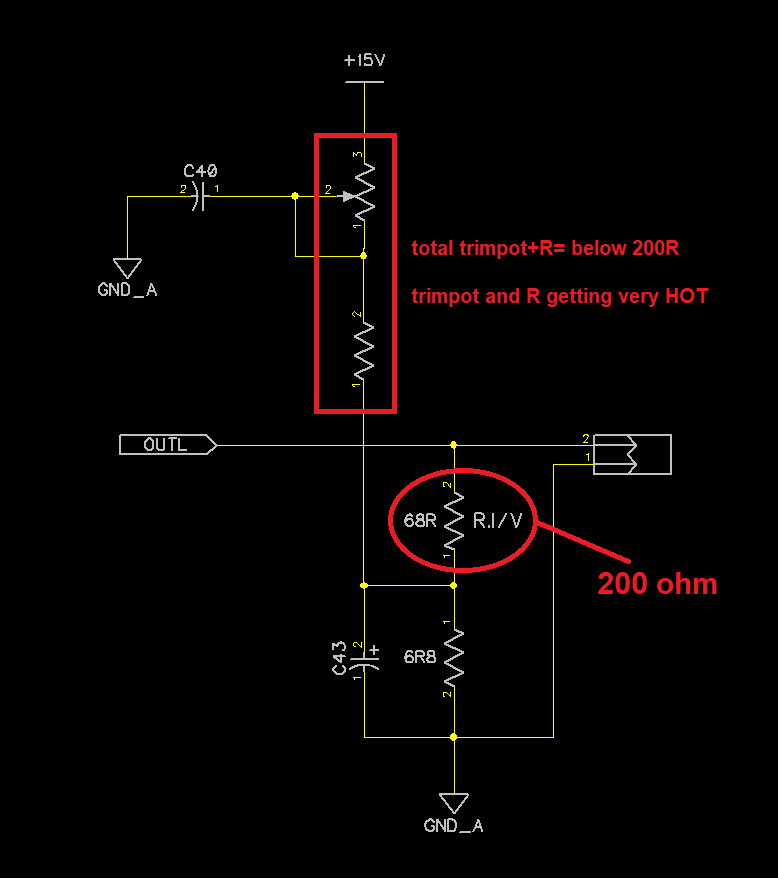

hello John,
i tried to changed the IV resistor into 200R to get more gain.
i still can trim into zero dc out, sound is normal, and with more gain.
but the trimpot and parallel resistor become very hot.
how to get rid from this hot?
thanks.
Peter
so now i reduce the voltage into 5v dc.
heat are normal (warm), still i can trim into zero volt and steady.
i don't have measurement devices so i don't know about the distortion,
but to my ear, giving 5v in IV stage is sounding better than 15v.
Hi For +15V Io at the 200ohm total R (pot +R) is 15V/200ohm=0.075A cca. That is 0.075Ax15V=1.125W of power dissipation.
I You want to get just warm these elements You have to increase power of elements to 4X of calculated dissipation so that total R should be from 4-5W...
Make this fixed R to be main final value close to 200ohms some standard 180ohm value or 4x750ohm/1W in parallel to get 187.5 ohm/4W
and pot value from 47 ohms. In this way dissipation will happens at the 4W R mainly and pot wil not be affected much.
Zdravo Zoran,Is there any progress about lifting wrong pin and connecting to proper?
I lifted the pin on the SOIC, and then bridged the pad over to the adjecent pin with solder (since inverted output is pin 8, and this is pin 9). I triple checked in sheet these pins and orientation and everything to validate everything physically is as should be schematically, and tested continuity with multimeter.
I thought it would finally be the ticket, but what happens is nothing. Logic analyser shows outputs as expected, but for some reason TDA's only produce silence and cannot decode this. I cannot explain it at all, before at least we had noises. This is why i triple checked everything with continuity meter. If you revert it back it will play these noises with extremely high harmonics again, and simultanous mode plays perfectly, so not like the dac's pooped out.
Of course i also tried all possible permutations on my board, studied schematic over and over, measured everything, but no.
It was a dissapointing development to report so i didnt say anything thinking maybe solution comes to me in a dream, but it did not.
Anyway, this is getting frankly dizzying and i want to come to some conclusion of this so i can at least send xaled the package back + board.
So i will redesign digital side with 74lvc74 like xaled did, except with this pin corrected to match up to ecdesigns (in other words, this pin lift will be incorporated into design already), in any case it should be equivalent to ecdesigns design, just using 74-74 logic. It will either work (according to logic) or will produce silence (according to how much misfortune i have with this). In meantime i did some other improvement to analog design side of the board, and also some minor things that i noticed while using the v1 that of course, you only notice once you have it in your hand.

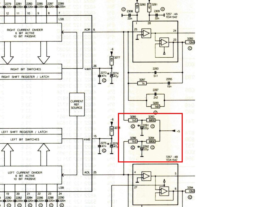

But now I am with ECdesign IBS PDF...
For minimum working mode You need 2 TDA1541A dacs.
Take a look at the "*" marked outputs please.
Each dac chip operate for one channel only.
Did You checked proposed DAC chips connections?
