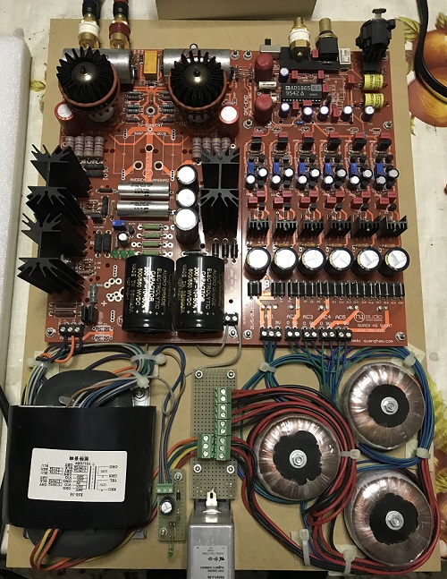

I attach a picture of my DAC END with the AD1865 I have built some years ago.
Thanks. My understanding in the DAC END, and similar CS8414 AD1865 pairings, is the use of a hex inverter to create the latch signal for the right channel causes a small inter-channel delay that can be fixed by using a shift register? Although it seems it may not be worth it as it is nearly inaudible. I2S to PCM converter would resolve the issue I am sure by syncing the two channels.
Very nice build BTW, clean and well-organized!
