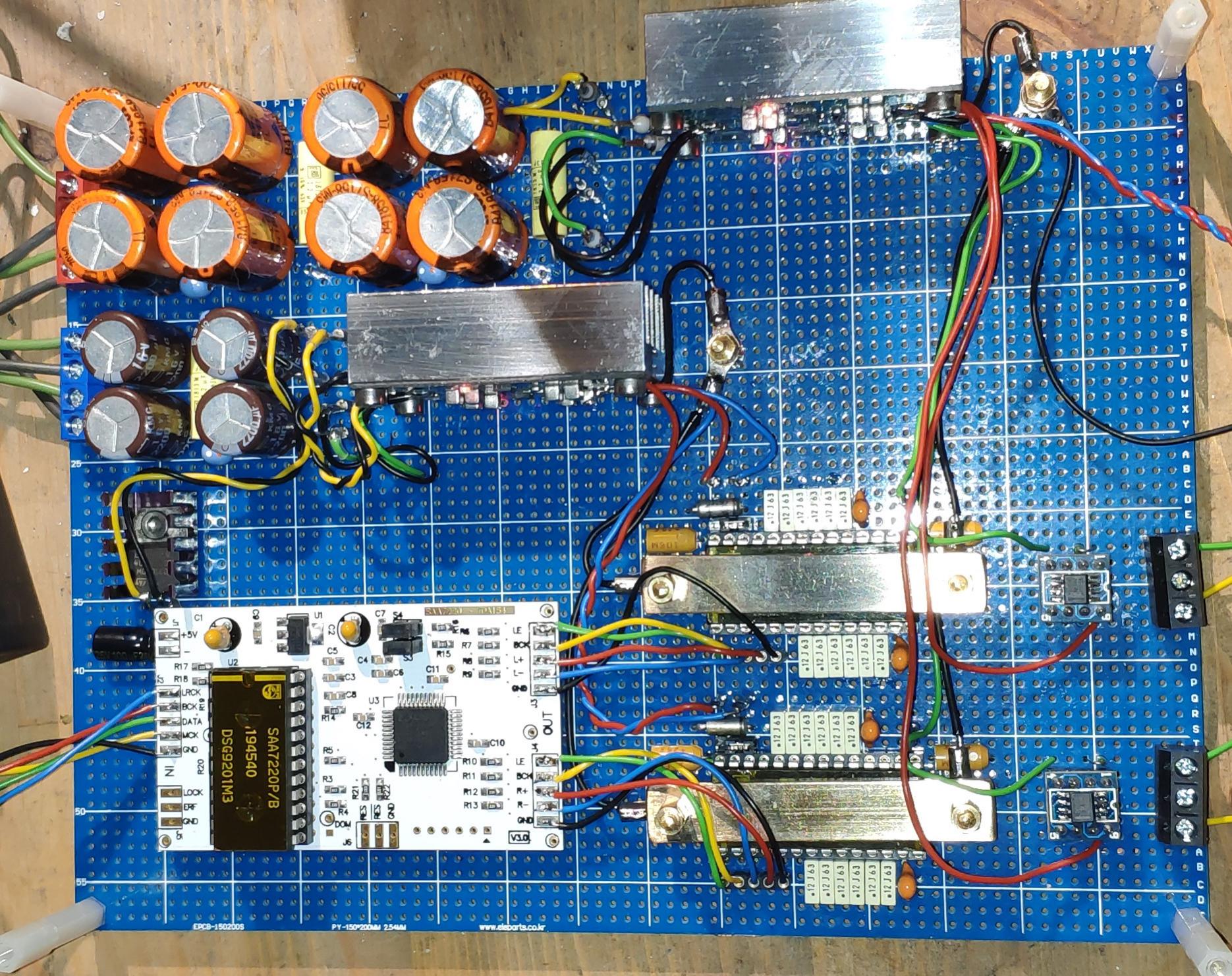

Building the ultimate NOS DAC using TDA1541A

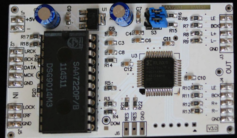

Use the CPLD board from China.

I can sold one IanCanada I2StoPCM v1.1, I have three brandnew. (works with tda1540, simultaneous mode TDA1541, AD1862,1865,PCM1702, 1704
but it must be slaved by a master clock with uf-l : made to work with Iancanada Masterclock or later FifoPi... all i/o are uf-l

I am also looking for a I2S to dual simultaneous TDA1541A PCB to be assembled DIY.
Thanks! Don’t I know it! 😀
I’ll check out the boards. I have built Pedja’s DACs (an Aya is still in my system doing sterling service today), and was looking to see what else there was out there with two chips. John’s suggestions in this thread really piqued my interest.
