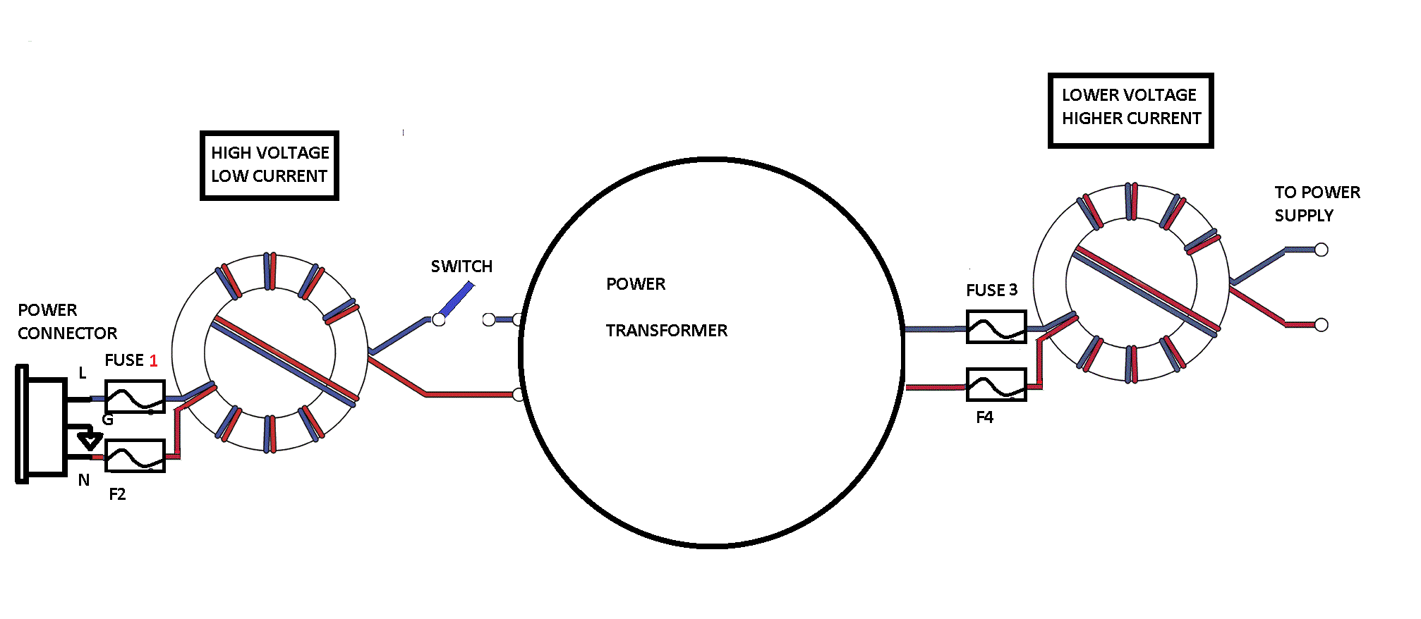

Dear all,
I tried "Reisert Balun" pre and post Power Tx and, of course, it sounds significantly better.
Feel free to add as many fuses as you wish, until your heart's contempt... 😀
Notice the difference in V and I may deserve possibly diverse wiring to comply.
This one is in use on my Dual-mono 8*2 TDA1543 DAC with -EC-'s "balanced charge-transfer supply".
Best wishes,
M.

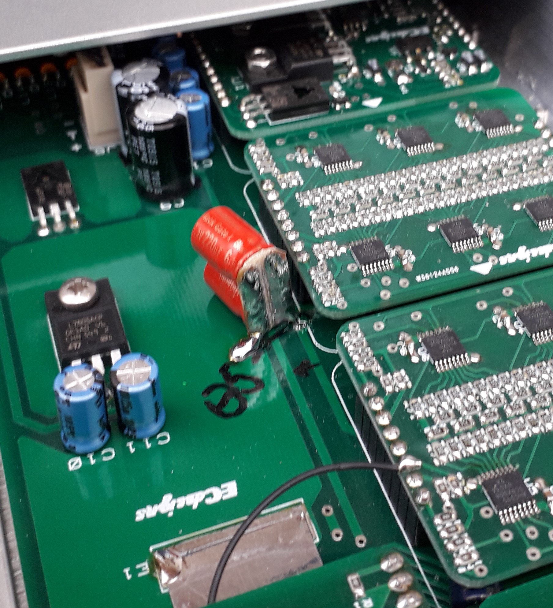

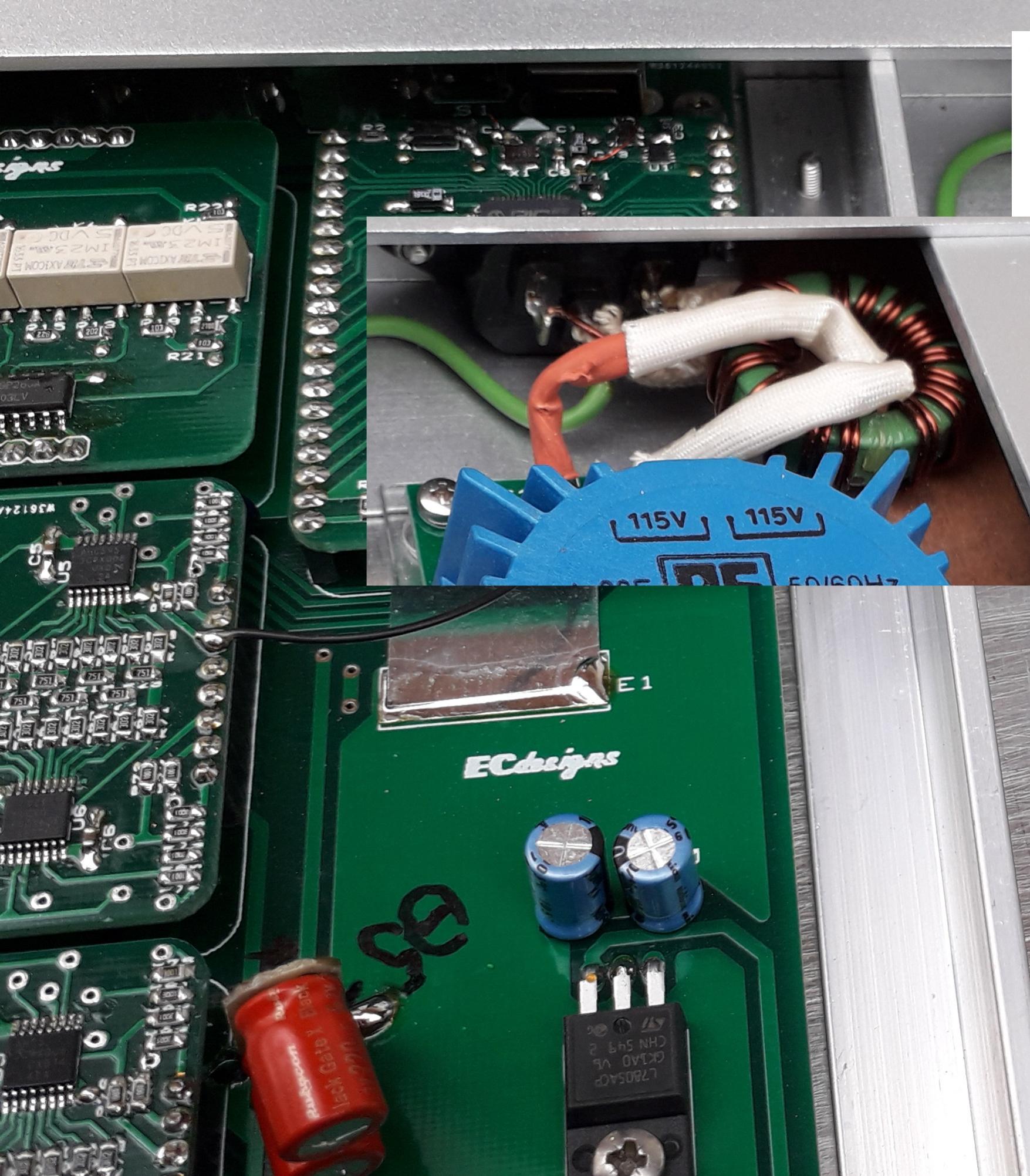

I got my mojo working!
A couple of weeks ago, I installed Black Gates in super E-cap configuration on a 5V circuit (probably the resistor ladder 😕) from the Mosaic DAC. 😎
For the brave who would try these caps on your own circuits, be warned:
Instant darker background with some extra detail, BUT everything else goes wrong for 1 or 2 weeks. 🙁 Low ceiling and high floor with everything in between sounding "plastic", artificial, though warm, then all kind of variations on the theme, like no lows with crispy highs and vice-versa...😱 Then slowly things begin to improve and soften and relaxing until everything sounds way better than stock. That what is called "authority", with every and all instrument lines perfectly intelligible, with organic textures and timbre. Quite amazing really.
Fortunately, the rescued (used) caps from other experiments take less to "burn-in", like those I am using on my two SD-card players.
These caps are worth every penny. 😎
(old pennies, not present ones 😀)
Best wishes,
M.

Hi Max,
Nice
Which BG are you talking about please in that experiment ? N, NX, std, etc ?
capacitance value ? Same as John's ?
And have you tried a smd pps cap of a low value... something between 0.1 to 1 uF (with and without the BG) ?

These red ones are non polar, perhaps N (NP?) type, I don't quite remember. Value from these are 220uF/6.3V. For the other functions I have 10uF/50V. Remember these are paralleled in counter-rotating, opposing, foil sense of folding, which allegedly cancels all ill-behavior from caps. I hope I described it well. Google, or better "Brave" (or duckduckgo) for super-E cap, for the monographies that the Black Gate guys produced for this invention.
M.
PS: what is pps?
Must be the N if red ! I asked because sometimes a standalone non polar as the Red or the little blue NX just need to be reversed to achieve a different sound as you already know. I meant sometimes it can acheive better results than the sur-E conf... sometimes. that's why I wanted to know if you tried that2 possibilities of the standalone non polar before the Super E (// reverse conf). ?
Remenber, the PPS are the Acrylicsmd caps from Cornell Dublier John was using in the latest tda1541A designs and maybe today yet. Some caps brands make also PPS with higher values 10 uF and more... I found it a good swap for BG. Sometimes I prefer more the PPS with a small capacitance decoupling near the load of digital chips or LDO than a BG... You're right, if we knew we had to buy kilogrames... better ratio than Gold, lol !
I meant sometimes it can acheive better results than the sur-E conf... sometimes. that's why I wanted to know if you tried that2 possibilities of the standalone non polar before the Super E (// reverse.
PPS are the Acrylic smd caps from Cornell Dublier.
Oh! I did not realize that you were Initiated in the Mysteries. 😀
I confess that I never tried and reverse the BGs...I put them as the Good Lord led me understand.
Different results must be related to circuit idiosyncracies; everything vibrates in this Universe...so I prefer to use the caps as the MFR recommends, in mutually cancelling L configuration. 😎
PPS seem very desirable and affordable. And one can stack many on top, I imagine.
About Gold, just give Him a little more time... 😉 😀
Best wishes of success, peace and prosperity for all,
M.

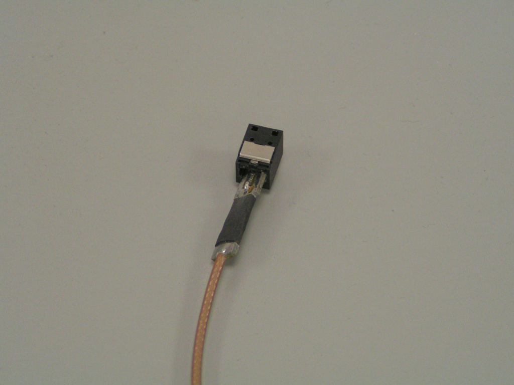

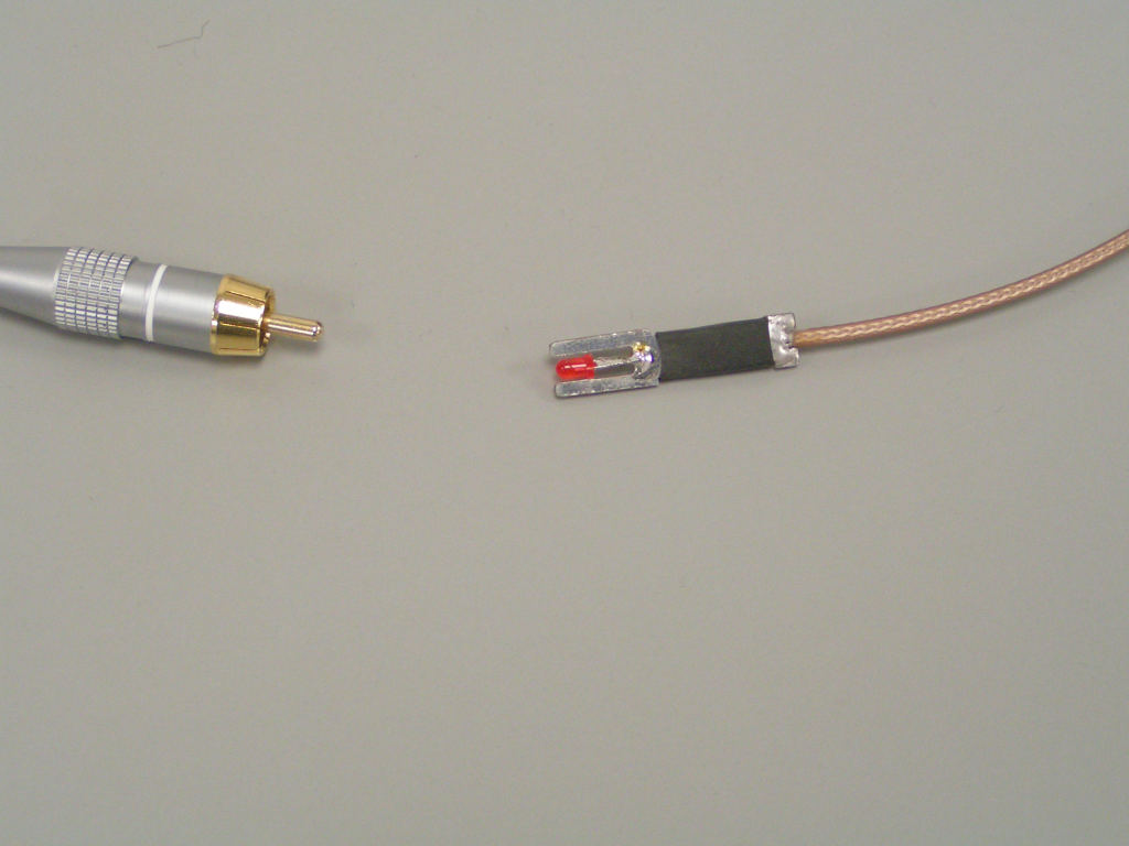

First of all, I developed an electro / optical digital audio hybrid interface that received the name ElectroTos.
The interlink basically consists of a 1 meter coaxial cable driving an ultra high speed LED. This LED shines directly on the Toslink optical receiver. The relatively large distance between wires inside the LED and wires inside the optical receiver provides superb galvanic insulation and almost zero coupling capacitance.
It can run in compatibility mode, this is very interesting for use with existing DACs that have Toslink input. This way the performance of existing DACs that have a Toslink input can be significantly increased.
In native mode the ElectroTos protocol is used, this offers maximum obtainable performance.

I attached a photograph of an experimental ElectroTos interlink and how it fits into a Toslink optical receiver.
So if you want to improve sound quality of existing DACs (including MOS16, MOS24) you can use the new ElectroTos interface plus translator, it will always outperform Toslink by a large margin while preserving advantages of Toslink like perfect galvanic insulation and low bandwidth output.
Ground loop noise + wired LAN will lead to significant sound quality degradation. This is one practical example off how important it is to have -zero- ground loop noise injection. Direct USB, I2S, coax or AES/EBU connection to the DAC cannot prevent ground loop noise injection.
