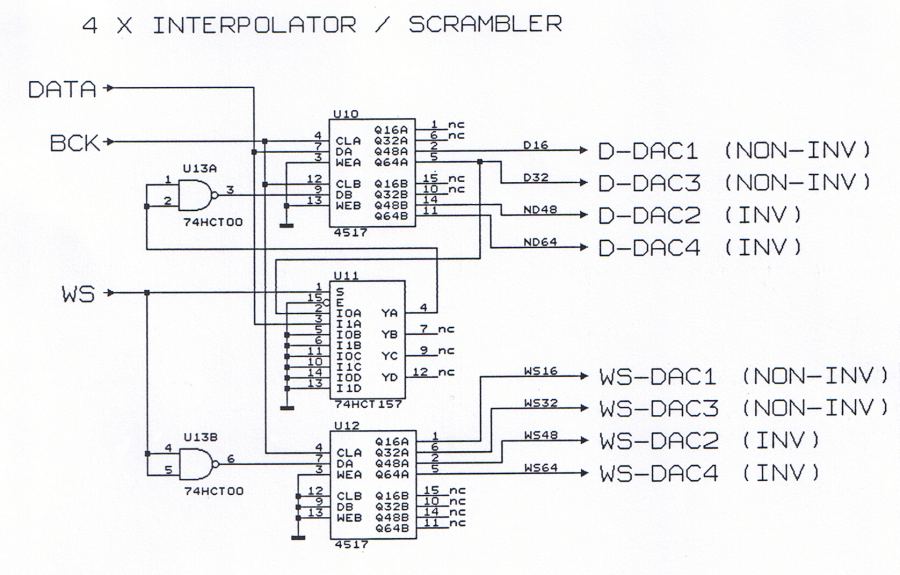

John, I've been revisiting the "scrambler-interpolator" DAC. It worked OK with 4 towers of 4 chips each. When I doubled :D the number of chips to 4 towers of 8 chips, it refused to work. I am investigating why today.
I presume that the CD4517 shift registers have too low current output to ride all those chips. If so, maybe I can piggy-back them :) is it possible?

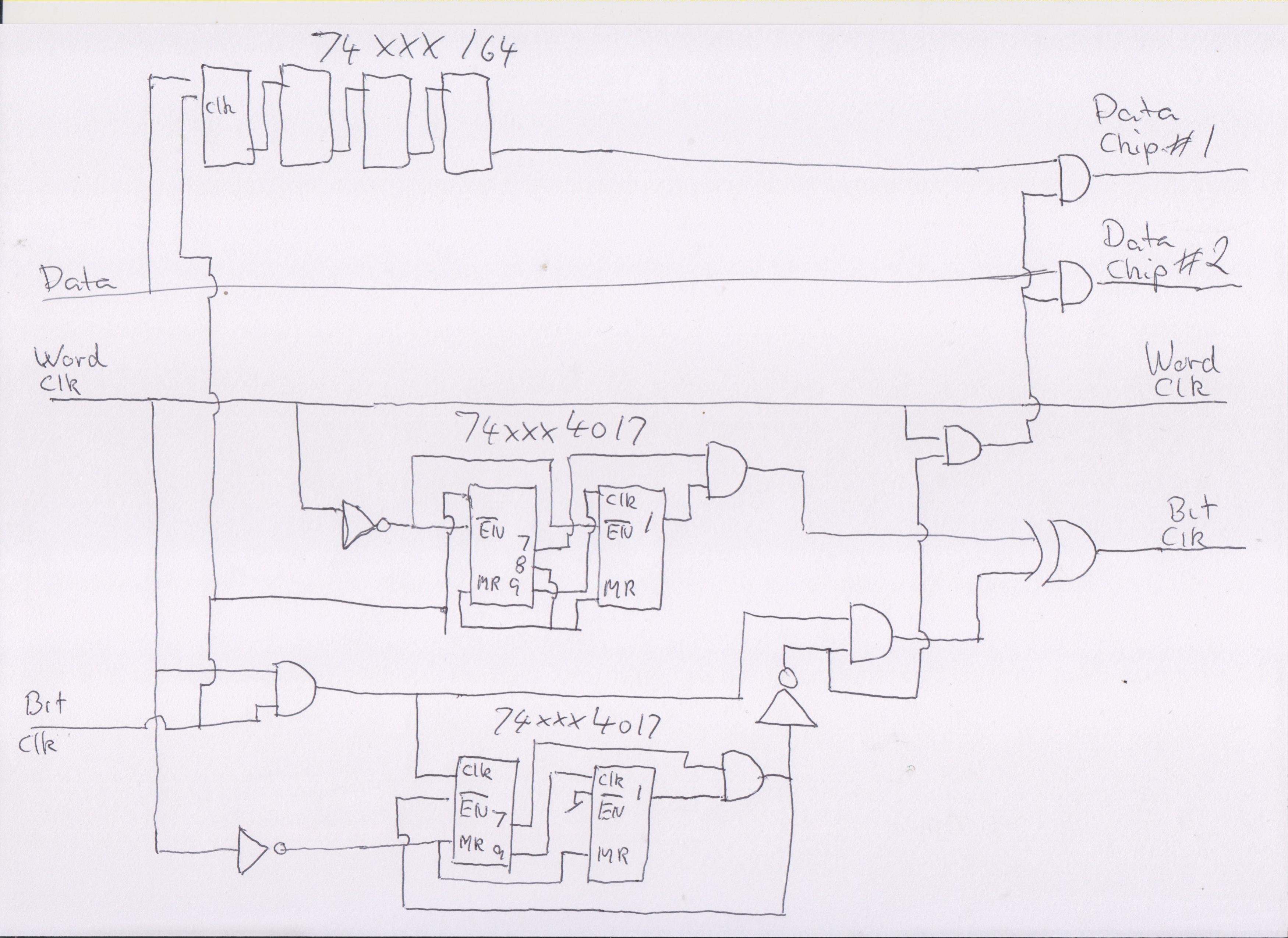

As I see it you need 17 clock pulses and not 16 for the 1543 as it expects I2S format so the data must start 1 bitclock after WS goes high. So I think it would be better to design it from scratch as you are using some of the the glue logic to ensure the data starts when WS goes high in the I2S to Simultaious for the TDA1541. It would actually be easier I think.
Please correct me if I am wrong
Could something like the attached work?
The AND gate low left puts out clk only when WS is high . The lowest 2 74xxx4017 (i love johnson counters ;)) selects the first 17 clk pulsesand puts them out to the x-or gate rightmost. The upper 74xxx4017 selects 1 clk pulse after WS is low and the x-or gate combines this with the 17 clk pulses .This is the LE for the two TDA1543.
The four 74xxx164 delays the left data 32 bits so it is synchronous with the right data.
There are probably a lot of errors in this, I am definitely not an expert in this kind of work, so please be kind:p

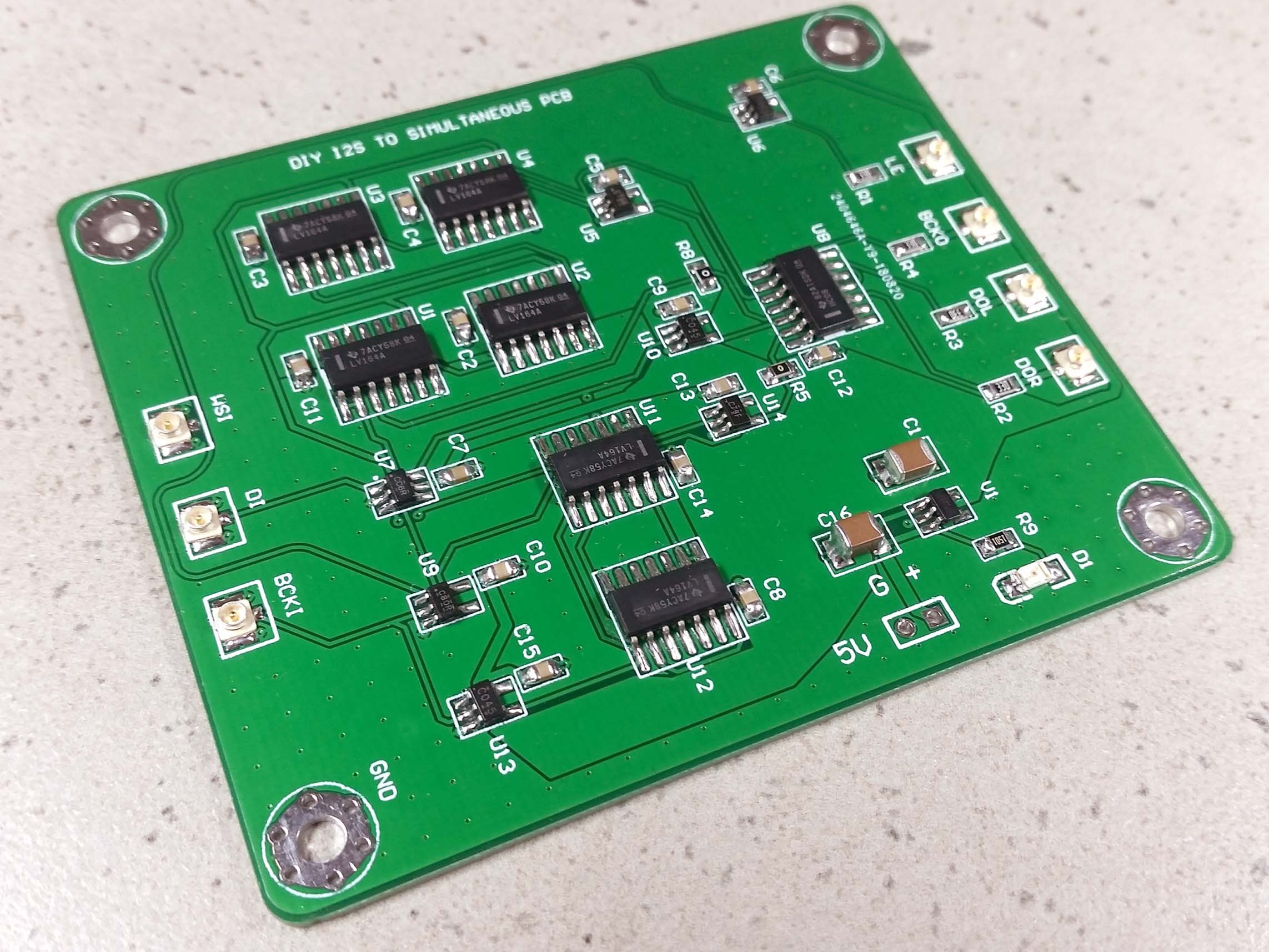

I2S to Simultaneous PCB
I've just completed the I2S to Simultaneous PCB based on ecdesigns schematics #6315
Tonight she sang, and without any hiccups when first powering it up - which is was a pleasant surprise.
I scraped the 4 layer idea to save on cost - its a lot more expensive to do small runs in 4 layers than 2 layers. So I re-designed it as a 2 layer.
Power consumption was surprisingly low at about 5mA so I have it powered by 4 NiMH cells which should give about 350 hrs of run time.
...oh, and its sounding pretty darn good too!:yes:

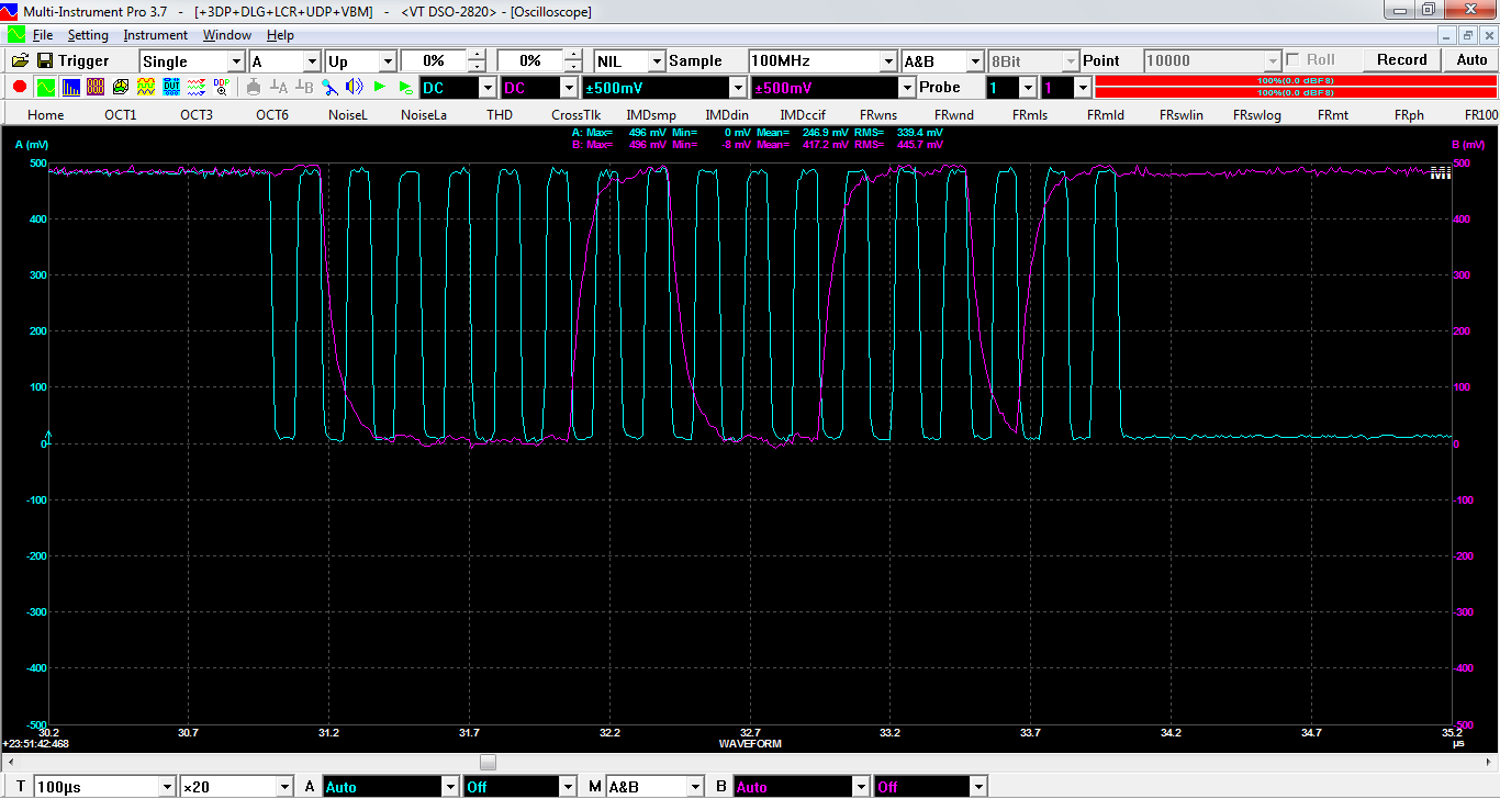

That is correct! Here´s mine. WS not shown, it goes high with the first bitclock high-to-low.
The first bit is the LSB of the left channel. In my case it will always be 1.
Then we have 16 bits of right channel. WS goes low after lhe LSB.
Then a single low to high transition of BCK triggers conversion on the right channel. In the middle of the "silence" preferably.
(I suppose I have to try the diodes now, to limit the swing to 1.8 volts.)
-Alex

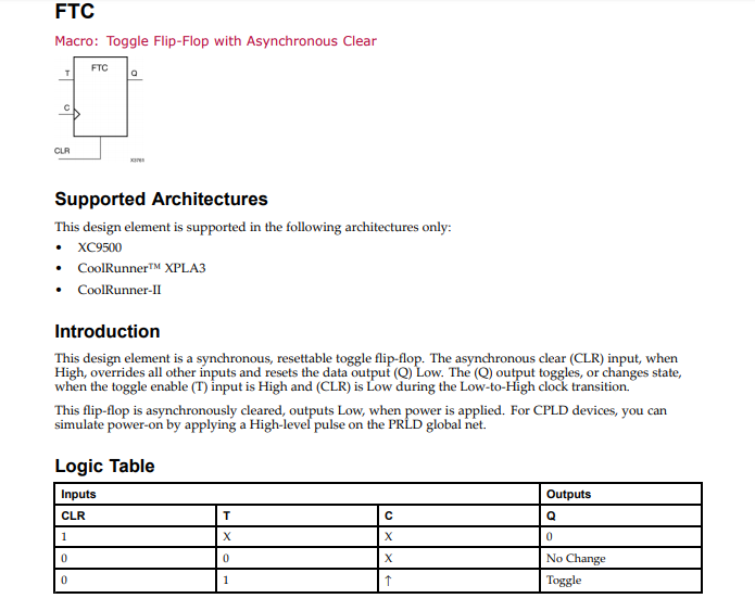

Are you familiar with the toggle flip flop? You can use a JK flip flop to implement this function. See attachment below taken from Xilinx CPLD Libraries Guide: https://www.xilinx.com/support/documentation/sw_manuals/xilinx11/cpld_all_scm.pdf
-Alex
-Alex
