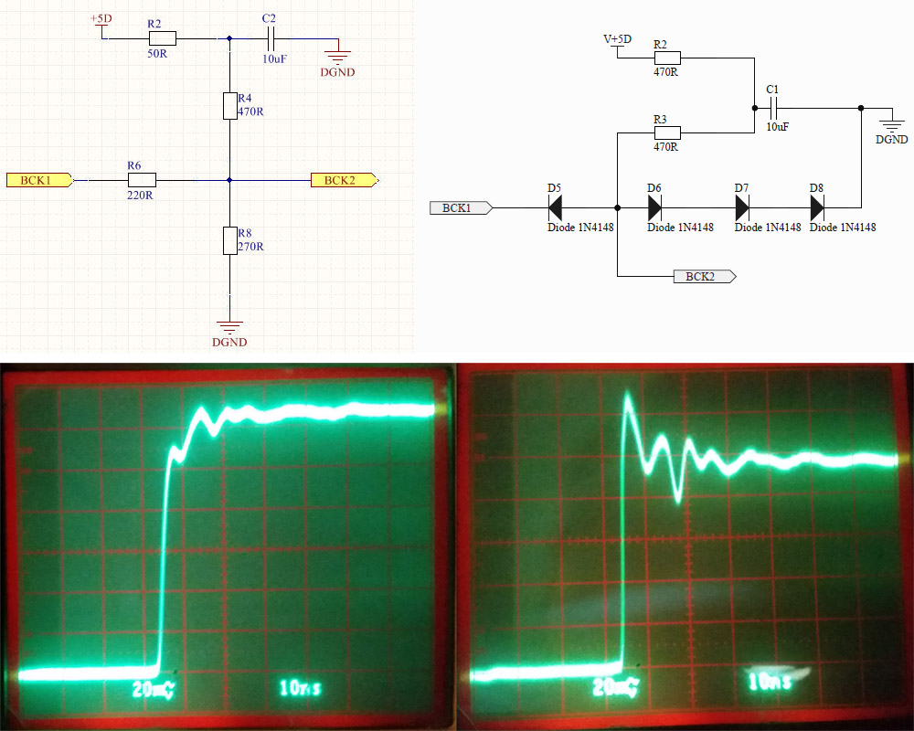

I've attached an image with the attenuators im using with the corresponding waveforms below them.
Since your running in I2S mode - try using the diode based atten for BCK and the resistive based atten for DATA and WS.
If running in simultaneous mode (which you should because its much better) - Use Diode atten for LE and the resistive atten for DATA L, DATA R, and BCK.

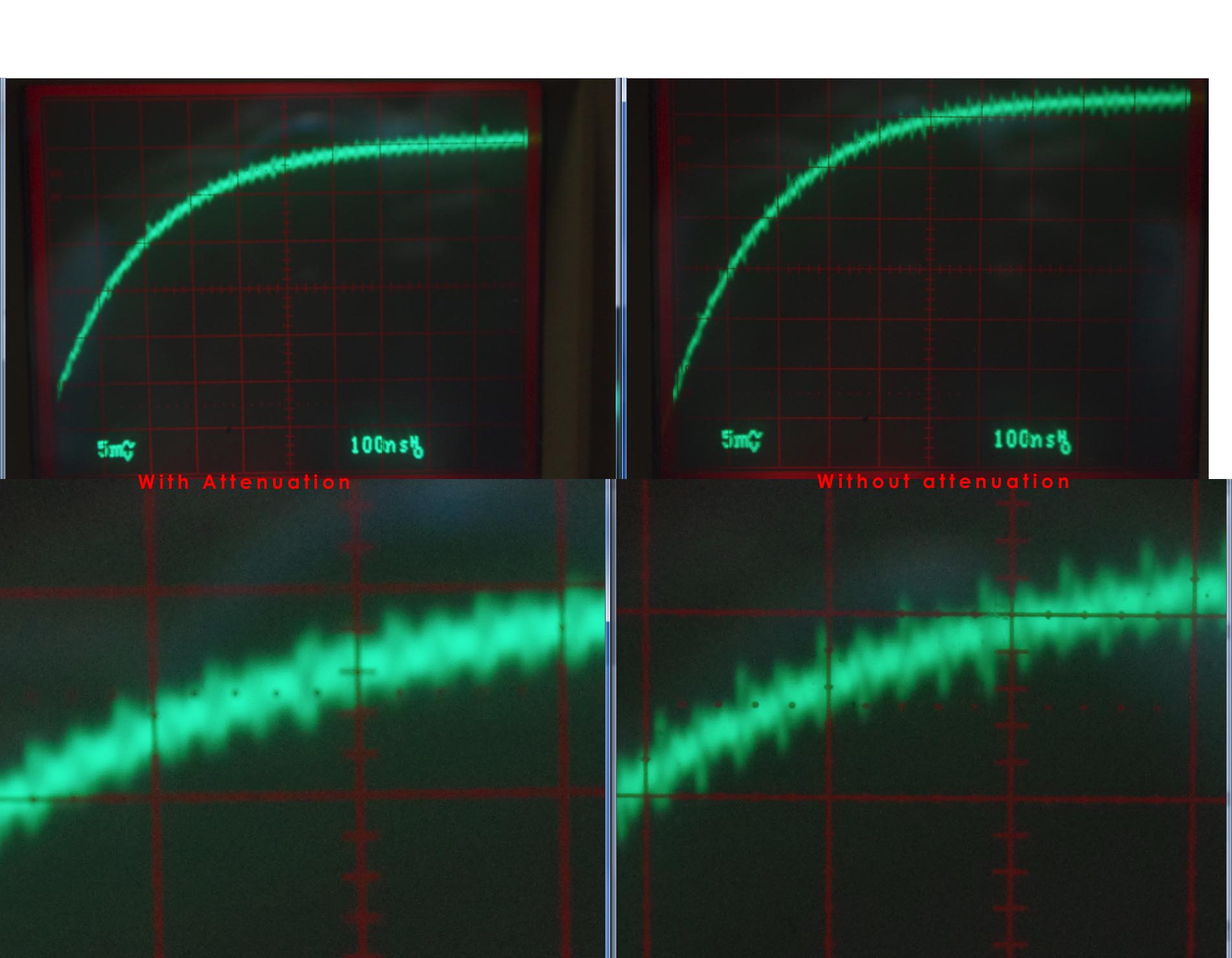

I also attached a pic of a waveform coming out of AOL/AOR comparing with and without attenuation.

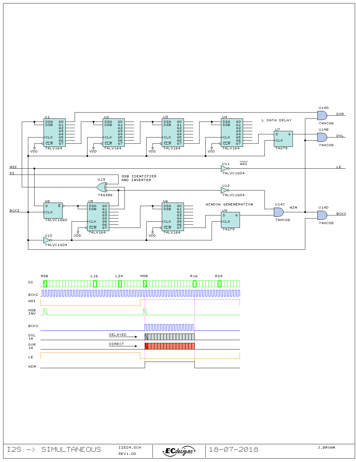

I2S to SIMULTANEOUS CONVERTER
I attached a schematic diagram of an I2S to Simultaneous converter for the TDA1541A.
The circuit performs following functions:
- Identify and invert MSB within the serial data stream.
- Delay the left channel data in order to align it with the R channel data.
- Create a 16 bit window for clock and data output signals.
Timing diagram is added at the bottom.
The circuit can be built with logic building blocks like 74HC, 74 AHC, 74LV, 74LVC.
If U13 is a problem one can combine two 74HC86 XOR gates instead. One output goes to one input of the other XOR gate, we now have an XOR gate with 3 inputs and one output. The 74LVC1G386 is available in SOT32-6 housing:
http://www.ti.com/lit/ds/symlink/sn74lvc1g386.pdf
Depending on logic building block properties the circuit can work on voltages between 2V4 and 5V. I recommend to use 2V4 ... 3V3 supply voltage.
Connections:
I2S,
DI = D
WSI = WS
BCKI = BCK
Simultaneous,
OB/TWC (pin 27) connects to -5V to put the TDA1541A in simultaneous mode.
DOL connects to pin 3
DOR connects to pin 4
BCKO connects to pin 2
LE connects to pin 1
LE determines the exact moment of output latching, output latching occurs at the 0 -> 1 transition (TDA1541A set to simultaneous mode).
BCK clocks in the data on the 1 -> 0 transition (TDA1541A set to simultaneous mode).

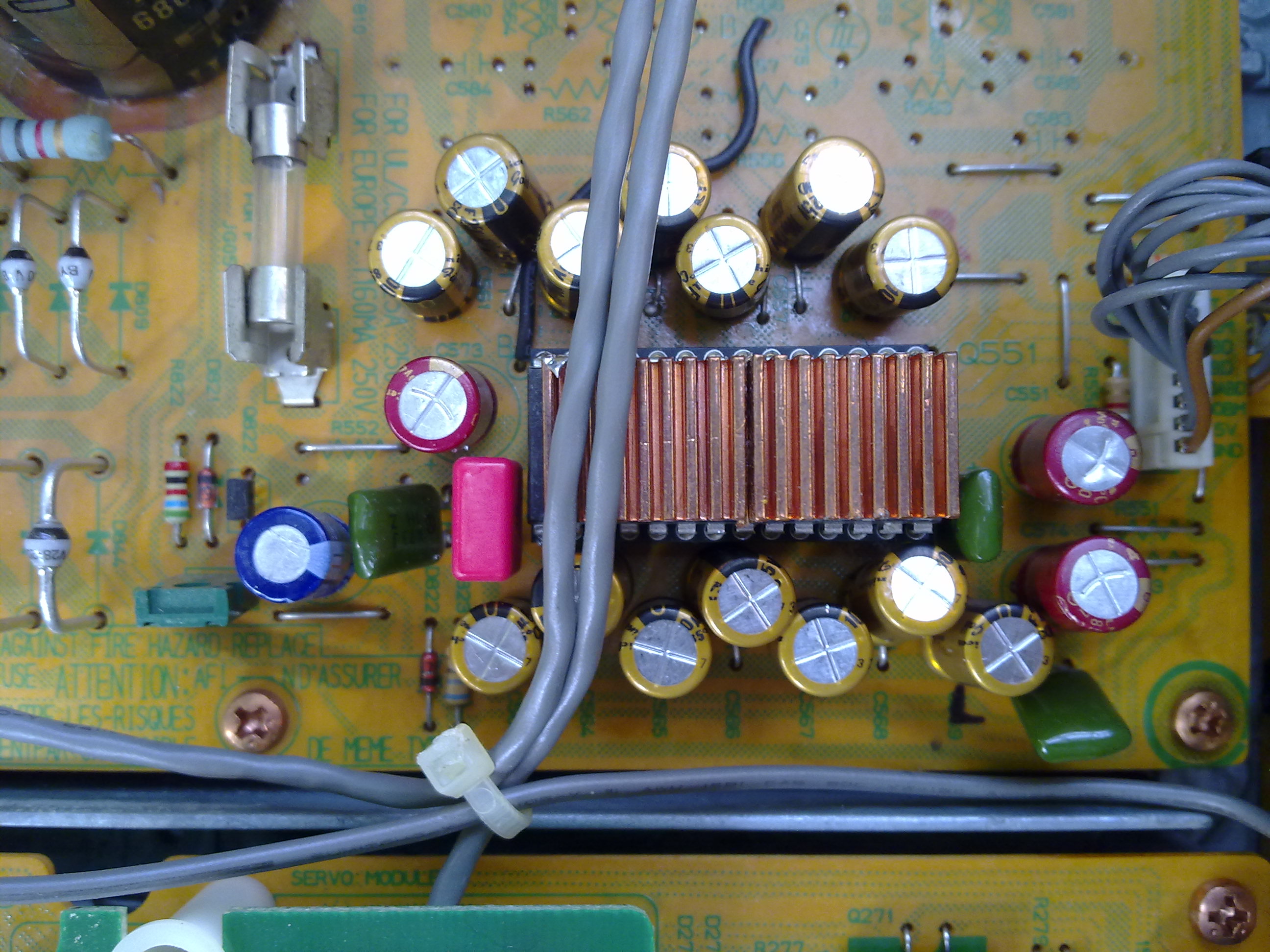

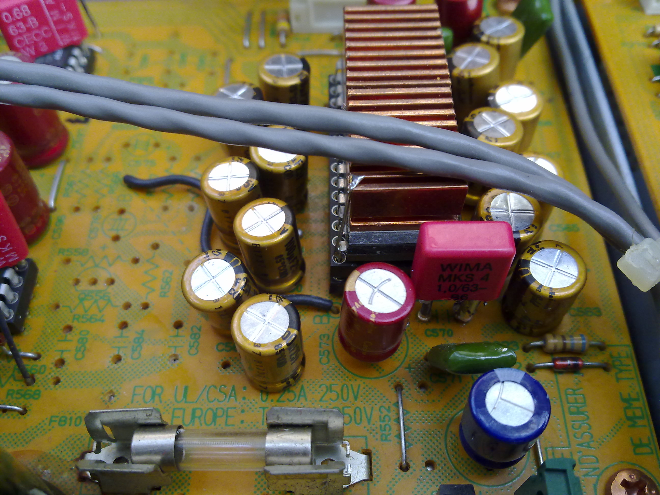

I decided to make the DEM mod in my Marantz CD94, i.e. change the oscillator capacitor to 1uF WIMA MKS-4, and replace the filter capacitors to 100uF/25V Nichicon Muse FG. Also added 2x 15k resistor from pin 16 and 17 to pin 15 (-13.5V).
During the first listening there was a disturbing static in the right channel. It went away after 10 minutes or so. What could be the reason?
BTW the sound seems to have cleaned up, but I need more listening to be more definitive.

Do these heat sinks somehow affect the sound? Or do they only affect the thermal regime?
Heatsinks on top of TDA1541A
It is difficult to do before/after listening tests, so I do not want to state something that might not be true. As for the thermal effect, the top of the chip was hot, which is not good, I think. Now it is just warm, and I have peace of mind (which has positive effect on sound, BTW 😉).Hi,
I believe John warned about this. The large caps take several minutes to charge up to the working voltage (because of tiny DEM currents).During the first listening there was a disturbing static in the right channel. It went away after 10 minutes or so. What could be the reason?
