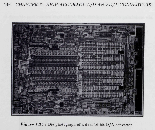

This is caused by the I2S interface and the 200 KHz DEM clock, that's why I suggested to run the TDA1541A in simultaneous mode with 25% data density and use 50Hz DEM clock.
This reduces on-chip ground-bounce to almost zero when the outputs are latched, so it results in lowest obtainable jitter with this chip.
Hi sumotan,
Hi, John. Some time ago you explained the 50Hz DEM-clock, but to my perception the scoop-images you've shown indicate an almost shutting down of the DEM functionality. Or am I wrong?
In the meantime I still prefer the DEM-clock at approx. 1Mhz.
Or am I wrong?
I think you are right.
This 50-KHz DEM generator castrate the very idea of DEM, since the currents of the active divider do not alternate within one sample. But John does not pay attention to this. He believes that it is more important to ensure low switching noise. With the same success you can just shut the DEM generator.
In my estimation, the oscillator frequency should be of the order of 700-800 kHz. This frequency should be selected by ear.
