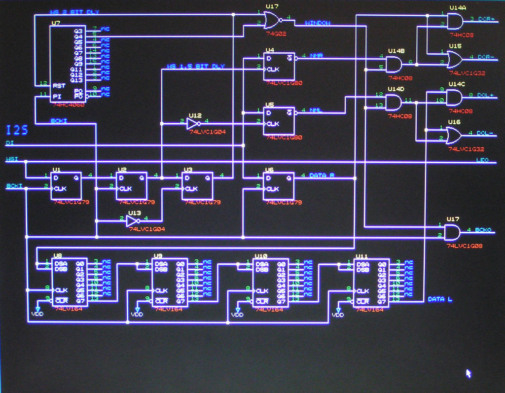

I2S Input
Hello John,
Just did a quick draft in eagle based on your description for I2S input. I'm not that experienced in digital logic so could you please comment if the changes are correct?
>hat we have to do now is adding one extra D flip-flops to sample the MSBs one and a half bit after a WS change (1.5 bit delay) and a
The most uncertain part - did I get it right with the additional flip-flop?
>2 bit delay to drive the window generator so we still loose the MSB.
Connect U6 Q5 Pin to U17.
>DOL becomes DOR and DOR becomes DOL (swap channels) and we are ready to use I2S input signal.
Change output labels.
Could you also comment on the decoupling caps for digital logic? What values for capacitors, should all of the ICs be decoupled?
Thanks,
xaled

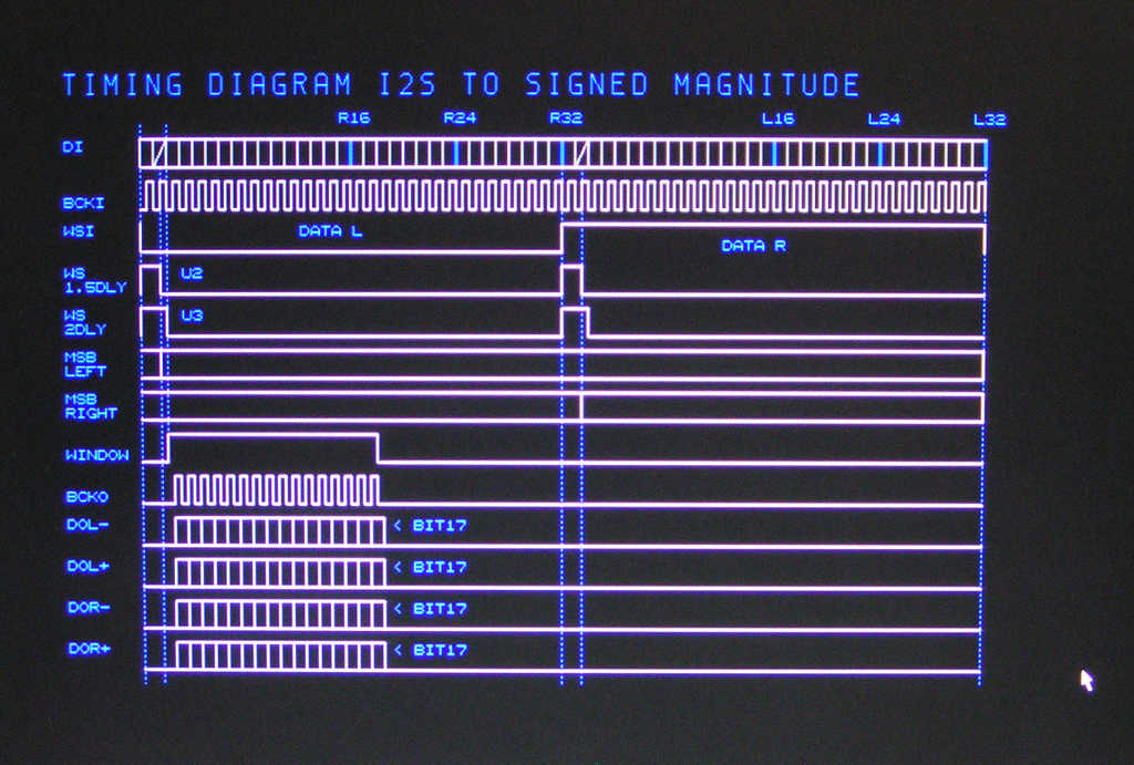

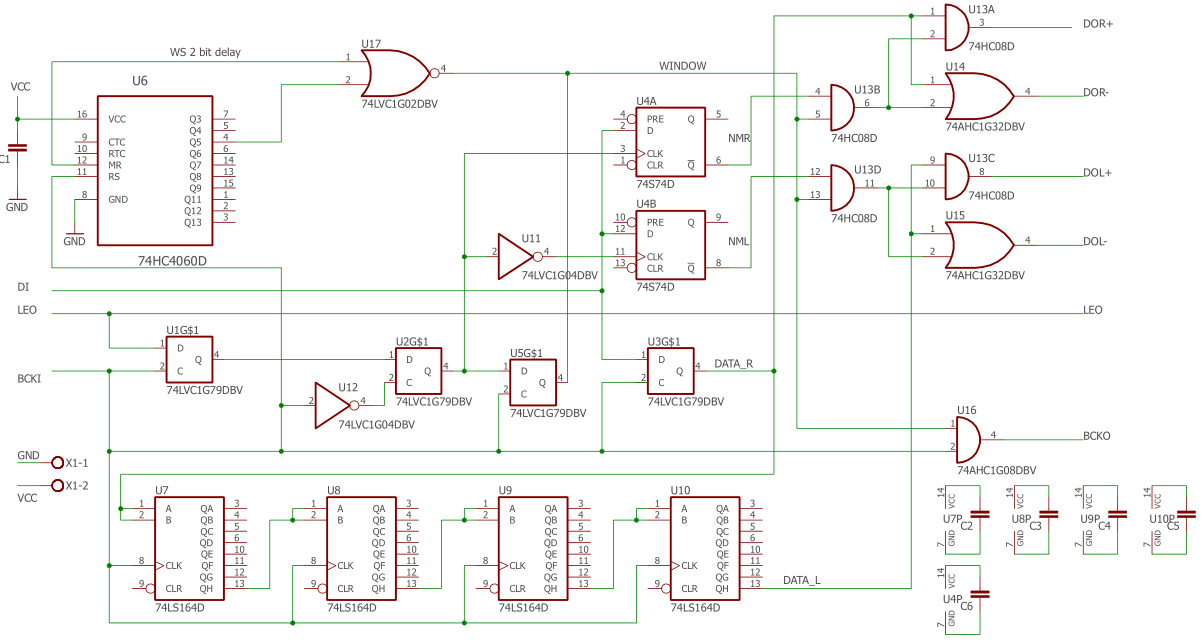

I2S to Signed Magnitude converter for 2 x TDA1541A
Hi xaled,
I assume your aim is to construct a I2S to signed magnitude converter.
You connected the Q output of the flip-flop Q3 to the output of NAND gate U17. This won't work as planned.
MSB sample flip flops U4a and U4B sample WS on 1BCK delay when MSB data is not valid for I2S.
I attached a schematic for I2S to signed magnitude converter for 2 x TDA1541A.
With I2S we have the left channel data available 1 bit after after WS goes low and the right channel data available one bit after when WS goes high.
With Left Justified we have left channel data available immediately after WS goes high and Right channel data available immediately after WS has gone low (schematic from my previous post).
In order to sample MSBs we need a 1.5 bit delay. Now we sample MSB half a BCK period after it has changed. This is provided by cascading flip flops . First one gives 0.5 bit delay and the second one flips over one BCK clock period later on 1.5 bit delay.
MSB for Right channel is available after WS has gone high (U4) and MSB for Left channel is available after WS has gone low (U5, inverted WS).
The Window signal needs to be shifted exactly 2 bits. We have 0.5 bit delay after U1, 1.5 bit delay after U2 and exactly 2 bit delay after U3. This 2 bit delayed WS signal is used to start the window counter by releasing its reset input. After 16 BCK pulses the output Q5 goes high. When we XNOR this signal with the 2 bit delayed WS signal we get the desired 16 bit window at the correct position.
I also added a timing diagram for this slightly modified converter.
I haven't tested this schematic yet, it's based on theory. The Left Justified version has been tested in practice.
Use 0.1uF ceramic 805 decoupling caps. Look at my prototype board of the protocol converter for amount and location of the decoupling caps.
I would suggest to use 2V4 supply voltage for this decoder in order to minimise switching noise. Decoupling is not that critical here as the circuit draws very little current. I would place decoupling caps close to every counter, shift register and flip-flop and add a few more for all the gates.

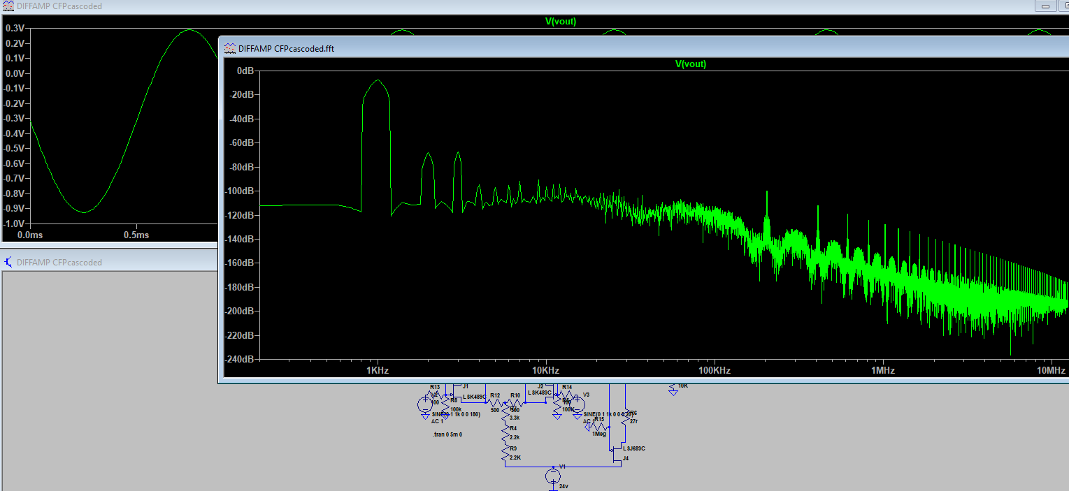

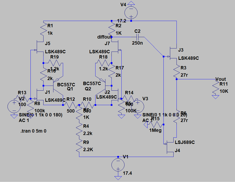

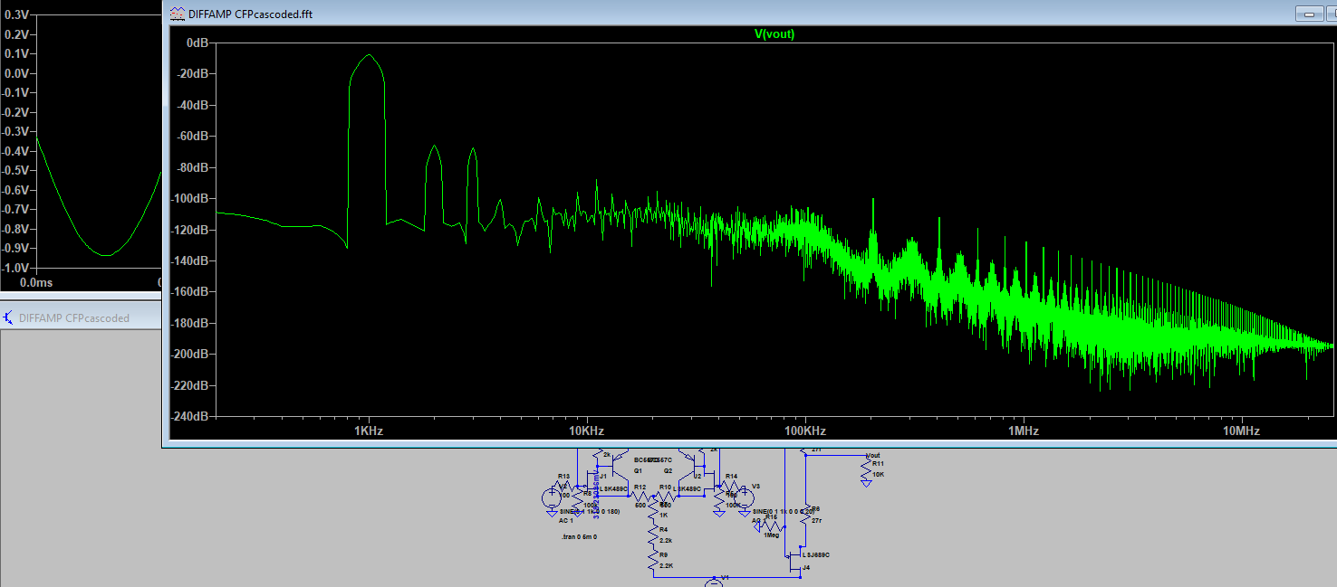

Sorry guys, totally OT. 😱
My low thermal memory mod for the diffamp, excellent sounding for balanced output DACs.
When both branches of the compound-Sziklai share equal currents, lower noise floor can be achieved.
Edit: added FFT for +/-24V supplies and 3.1mA passive CCS.
M.
M.

Truly appreciate your knowledge and willingness to share it!
I will digest the information and rework the schema accordingly.
Thanks,
Xaled

for the I2S input standard You can use same EC designs diagram for simultaneous format - just add simple circuit (one inverter and one flip flop)
to delay LE line for one BCK. (Take a look at the PMD100 pdf interfacing philips I2S with PMD100 example)
http://tech.juaneda.com/download/PMD100.pdf
page 17
I did it with discrete dac for transfer to left justified format... Working. 🙂
(with MSB inverted inside discrete dac circuit)
Also take a look at the I2S Philips standard PDF. It is very useful and You can find there how to make other useful signal lines like WSP, WSD and so
