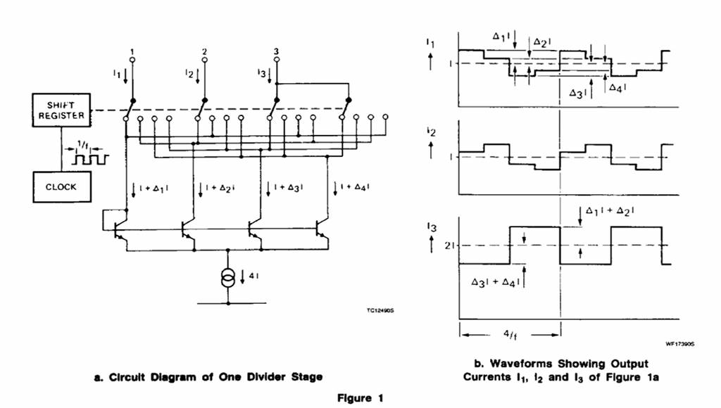

The DEM (Dynamic Element Matching) circuit dynamically matches the passive divider output currents for the 6 MSBs only. Philips developed this technique in order to offer high accuracy without the need for expensive (LASER) trimming.
The remaining 10 LSBs are -not- corrected by DEM and are derived from passive dividers. Passive dividers are used to derive binary weighted bit currents (2mA, 1mA, 0.5mA, 0.25mA and so on) from a single current reference source. These binary weighted bit currents are later combined by bit switches to obtain 65,536 possible current levels between 0 and -4mA. With no signal applied, the DAC bias current equals -2mA.
The DEM clock drives shift registers that in turn control an active divider switch matrix. The outputs of these active dividers are averaged / filtered by a RC filter. The active divider outputs provide a constant filtered DC current so there is basically no direct need to complete a full switch matrix cycle for each sample duration.
All an active divider does is averaging between 4 unmatched input currents from a passive divider, providing 4 closely matched output currents at the switch matrix outputs.
So it basically does this:
I out 1 = (I in1 / 4) + (I in 2 /4) + (I in3 / 4) + (I in4 /4)
I out 2 = (I in2 / 4) + (I in 3 /4) + (I in4 / 4) + (I in1 /4)
I out 3 = (I in3 / 4) + (I in 4 /4) + (I in1 / 4) + (I in2 /4)
I out 4 = (I in4 / 4) + (I in 1 /4) + (I in2 / 4) + (I in3 /4)
Addition is done by changing switch positions in the switch matrix, division is done by so called time division (each switch is closed for a specified amount of time).
This also means that slightest deviations in DEM clock rate (jitter) will lead to slight time division errors and thus reduced matching. This is corrected to certain extent by the RC filter.

There is no need to complete a DEM cycle "within" a sample period. CD players with this chip and 4 * fs run on 176.4 Khz sample rate.
DEM clock equals approx. 200 KHz and a complete DEM cycle takes 4 clock pulses to complete (approx. 50 KHz rate)
So it typically takes approx. 3.5 samples to complete a DEM clock cycle.

Also keep in mind that MSB is directly derived from the current reference source and therefore has no ripple. The next 5 MSBs are derived from 3 active dividers. The 10 LSBs are derived from a passive divider (no correction) but they are fed by the filtered output current of the last active divider. As this current is divided down, the residual ripple current on it is also divided. All derived bit currents "follow" the current reference source. TDA1541A is designed such way that glitch energy stays below 0.25 LSB at MSB change (1000000000000000 > 0111111111111111).
DEM corrects the -differences- between the 4 unmatched input currents. Typical matching tolerance equals approx. 0.1%. So an input current of 1mA can have a typical deviation of 1uA or 1000nA.
In order to get errors below 1 LSB (40nA) differences between switch intervals must stay below 4%. For 0.25 LSB error the frequency shouldn't fluctuate more than 1%. So for a 200 KHz DEM clock the allowed frequency fluctuations should stay below 2000 Hz or 500us peak to peak.
So it takes a pretty lousy DEM clock in order to exceed these values 🙂
The resulting DC bit current has -no- relation with fs, compare it with the DC output voltage of a switch-mode power supply, powering an oscillator running at a different frequency compared to the SMPS.
It is irrelevant if the DEM clock is synced with another clock or not. The operation (averaging between 4 input currents) remains effective as long as the time intervals between switch changes are equal (within certain tolerances).
In the MK11 and MK12 I use 1uF filter cap, with 500R this results in corner frequency of around 300 Hz
I use a free running DEM oscillator with timing cap. I reduced capacitor value so it oscillates around 3 MHz, it is then synchronized -not triggered- with the bit clock BCK (2.8224 MHz). So DEM clock jitter basically remains similar to a correctly functioning free running DEM oscillator. In order to meet 1% frequency stability, the DEM clock should not fluctuate more than 28 KHz or 35us peak to peak jitter. In practice it is no problem to achieve much lower values, this means I fully meet the conditions to stay well below 0.25 LSB error.
In short, when the DEM clock gets a reasonable clock signal and suitable filter caps are installed the bit errors introduced by the DEM circuit stay well below 0.25 LSB. It also doesn't matter if the DEM clock is synchronized or not.
So why did I synchronize the DEM clock with the bit clock?
This has to do with on-chip crosstalk and the effect on sample timing (jitter) among other things. Also note that I use NOS so I have 44.1 KHz word clock and 2.8224 Mhz bit clock instead of the 4 * OS variant where we have 176.4 KHz word clock and 5.6448 MHz bit clock.
I2S timing signals BCK and WS can be viewed as a fundamentals with harmonics. The DEM clock can also be viewed as a fundamental with harmonics. When these are added together (crosstalk) we get inter-modulation:
Intermodulation - Wikipedia, the free encyclopedia
So by using the same frequency as bit clock or word clock for the DEM clock, we can prevent inter-modulation and its unwanted side effects.
So with NOS I now have two options:
Using word clock (44.1 KHz DEM clock), or bit clock (2.8224 MHz DEM clock). Other multiples of fs are not desired as these wouldn't be equal to the already present clock signals WS and BCK.
With 44.1 KHz DEM clock rate I would have to increase decoupling cap values significantly.
So I picked the remaining bit clock (2.8224 MHz).
explain why asynchronous DEM clocking is better than synchronous, provided that fDEM >> fs ? Or John should explain the opposite... Also is the following equation correct? fDEM >= n x (4 x fs), where n = 1, 2,
The active divider bit outputs have RC filters installed. With approx. 500R on-chip resistor and 100nF filter cap we get a corner frequency of around 3000 Hz. The DEM clock rate equals 200,000 Hz. The ripple current frequency at the active divider outputs equals 200 KHz for the single outputs and 100 KHz for the paralleled outputs. Both are well above the filter corner frequency so we should end up with a clean filtered DC current with very low ripple at the output if the DEM clock was the only clock signal present on the chip.
But there are other (lower frequency) signals present on the DAC chip that can crosstalk to the bit outputs. So one could still end up with low frequency ripple current on the active divider outputs that falls within the audio band.
This unwanted effect can be reduced by increasing filter cap values, thus lowering filter corner frequency.
Note that the DC bit current outputs (active divider bit current outputs included) are selected by -additional- bit switches that combine currents from the 16 binary weighted DC bit currents in order to produce the actual DAC output current .
In practice, higher value filter caps offer subtle improvements by attenuating lower frequencies like WS crosstalk that might otherwise seep through. Above a certain value (around 10uF for 200 KHz DEM clock rate) little or no improvement is achieved. With 10uF filter cap we would get a corner frequency of around 30 Hz.

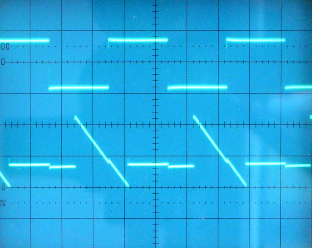

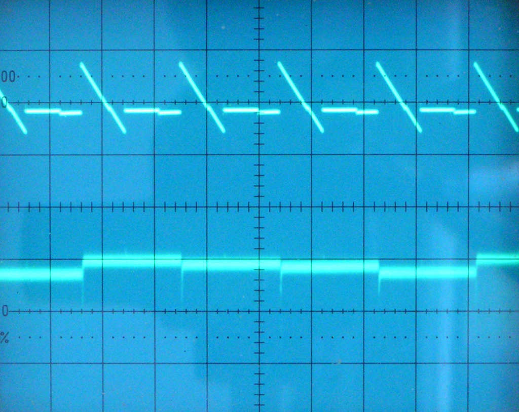

Hi JOSI1,
Like I mentioned in previous post, DEM clock can be synchronized with either BCK or WS.
In previous designs I triggered or synchronized the DEM clock with BCK.
This has some disadvantages as s3tup pointed out in post #4405.
Electronic switches in active divider cause switching spikes on the averaged output signal. These spikes have specific pulse width. The higher the DEM clock rate the more these switching spikes will dominate the active divider output signal shape.
It is also important to keep the sample steady current at the DAC output as clean as possible. The biggest problem here is the required BCK signal that puts noise (switching spikes) of 64 pulses on each sample. This results in a sample current with 128 "spikes" on top of it (on-chip crosstalk).
When synchronizing the DEM clock with BCK, there will always be a certain phase difference between these two frequencies. This is caused by DEM oscillator properties and propagation delays. This means that apart from the 128 spikes of BCK, we get another 128 spikes from the DEM clock so 256 spikes in total on BCK. Ideal situation would be a DAC with parallel inputs so we could get rid of the bit clock switching interference.
In case of the Philips data sheet application we get 128 spikes from BCK and approx. 9 spikes from the free running 200 KHz DEM clock that will constantly move position with respect to the BCK switching spikes.
Cleanest sample steady current could be obtained by synchronizing the DEM clock with WS, then we would add only 2 fixed switching spikes to the already present 128 spikes from BCK (130 switching spikes in total). This means that one DEM cycle (4 switch changes) is completed after every 4 samples.
Other advantage is that the filter caps and filter circuit become less critical as DEM clock rate is now reduced to 44.1 KHz (NOS).
Based on filter cap value of 100nF @ 200,000 Hz, DEM clock rate of 44,100 Hz would require 470nF filter caps (closest value). Since I already had 1uF filter caps installed I could easily test 44.1 KHz DEM clock with minimum changes to the existing circuit.
I attached an oscillogram showing WS (44.1 KHz) upper trace (measured at pin 1), and the synchronized DEM oscillator signal.
The second oscillogram shows the DEM oscillator signal (upper trace) and one active divider output with 1uF filter cap removed (second channel). Passive divider output current mismatch translates to a step current that's also described in TDA1540 data sheet and IEEE journal of semiconductors. I attached a copy of active divider stage and output current waveform.
One can see that the switching spikes are relatively short compared to the time between switch matrix changes. What we basically see here is a repeated sequence of unmatched input bit currents 1, 2, 3, and 4 that appear at the output of the 4-way electronic switch as it scans through all 4 positions at a rate of 44.1 KHz. Each of the 4 active divider outputs has such an electronic 4-way switch. This way each of the 4 outputs can average between each of the 4 inputs.
The higher the passive divider output current mismatch, the higher the step signal amplitude. Scope setting equals 2mV/div, probe 1:10. So the ripple current is actually rather small. The DEM oscillator causes crosstalk on the passive divider outputs (positive and negative spikes on the active divider outputs). These are just barely visible on the second oscillogram because the DEM clock frequency is very low compared to the given switching spike pulse width.
After re-connecting the filter capacitor, ripple voltage at the active divider output drops well below scope noise floor and we get a pure DC current.
The DEM circuit ensures that the 6 MSBs plus the input current for the 10 bit passive current divider always remain very closely matched, despite on-chip tolerances / chip aging. Keep in mind that even slightest errors in MSBs also lead to errors in the LSB range. So all bits contribute to the final bit accuracy.
The DEM oscillator now oscillates on the timing capacitor again, so 2K2 resistors need to be removed. For synchronization with WS, 33pF timing cap value is no longer valid.
