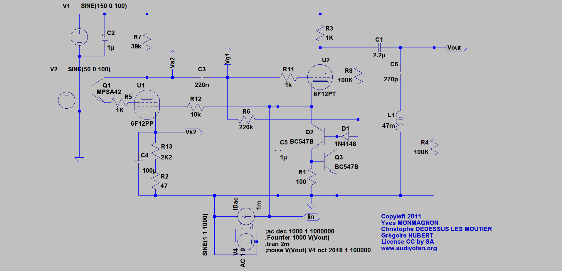

Hi all
This picture is about TDA1543 in NOS mode with our IVTCY (I/V with tube )
the blue line is 1 Khz generated with the 44.1 Khz juxtaposed
count the number of stairs
the red line use a notch filtre around 44.1 Khz
Hope it help
Hey, thanks. it does help. By using a 44.1KHz notch filter you eliminate the Fs without affecting the overall DAC signal. Good point, however, what filter topology and rolloff will work without impacting the audio signal in phase and sound quality/perception?
What did you use, is this an actual implementation, or did you do this just for a test?
Thanks,
Gary

Hi Roger57
For more information take a look here http://www.diyaudio.com/forums/digital-line-level/188708-super-common-gate-valve-i-v-converter-tda1543.html
A link to the blog of Chanmix in the page is very interesting
A capture of my version with the filtre of Alain93 (Audiyofan's member)
who replace the original notch filtre
If you understand the Molière's language have a look here Audiyofan.org • Afficher le sujet - Pré-ampli, mu-follower hybride de 6N16B but 79 pages
It's not just for test , it's my daily DAC

Great, thanks for the post. I just looked at the link and it's interesting, and maybe warrant further investigating. I was ultimately looking to use a tube stage output, but opted to test EC Designs FET stage first. Can you post (or send me) the spice model (.asc) for this? Would appreciate it so I don't have to enter it all in again.
Thanks!
Gary
No problem
You can find it in the zip file page 2 and 4
Decompress it and copy the file to your LTC's installation directory
Don't forget the component and symbol files
There is a file for testing with TDA1541 but not yet tested in
reality
For the version with TDA1543 , they work fine
in full tube mode for Alain93 and me
Yves07 build is own this day
in mixed mode with tube and mosfet for Chanmix and Kaikos
Hope it help

Did you find that using this notch filter affects the sound? It's phase shift must be present in the audible band.
Gary
Gary
Yes of course , in my own system it affect in a good way the amplifier
without this filter , the sound is "hard" in high level frequency
the amplifier is disturbing by the stairs because it can reproduce it
Chanmix don't use filter
That depend on what is following the DAC I think
The phase shift is less a problem regarding the speaker or amplifier
"reproduction", but still audible for good ear I suppose
