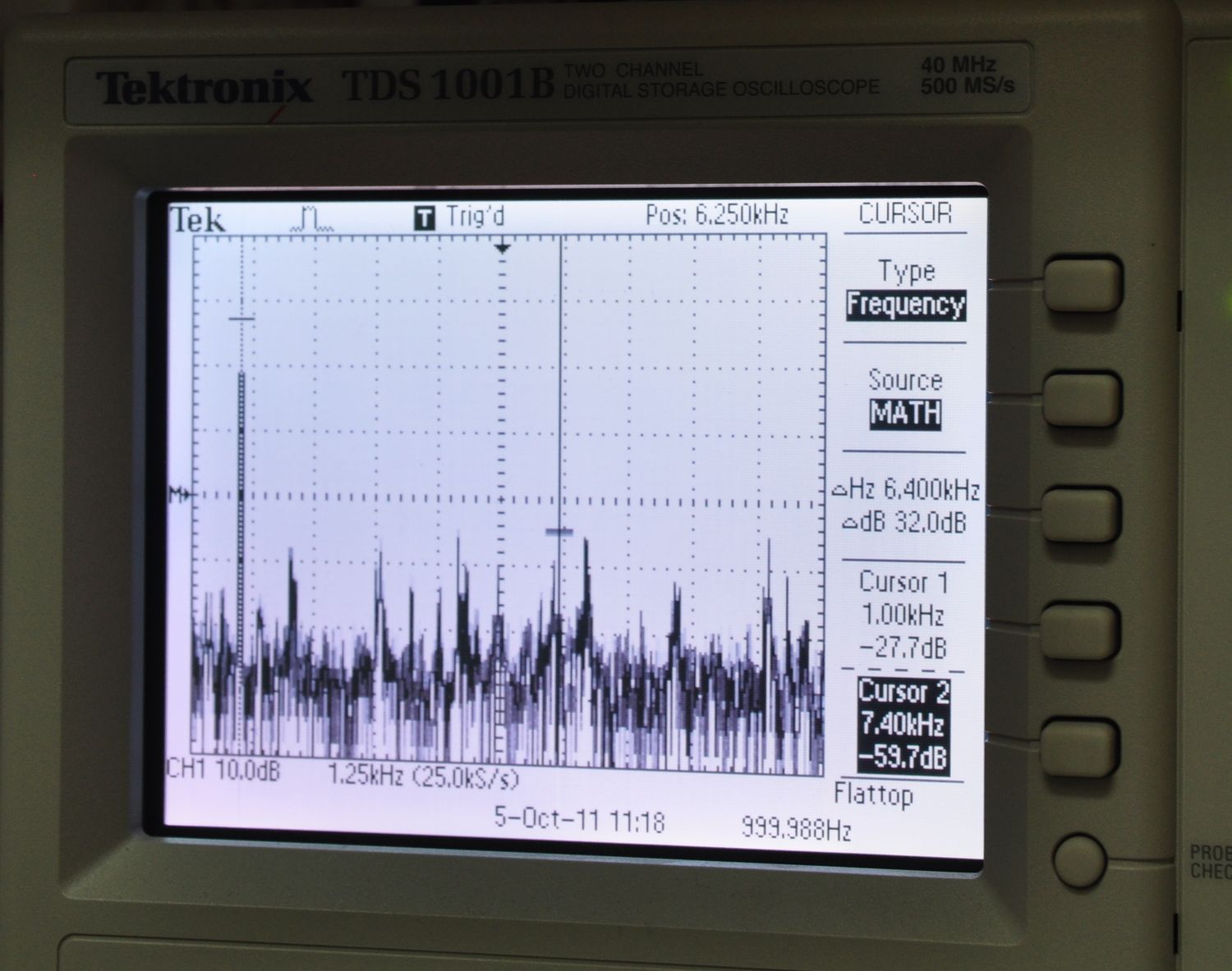

The DC offset has been nulled to 0V at the output. The output voltage is 2Vp. I've also tried a coupling cap, but no change. As indicated, the FFT on my Tek scope confirms the presence of harmonics. It's interesting to note that without any filters applied on my HP8903B (audio analyzer) the distortion is 4%. With a 80KHz LPF, it's about 3.2%. With a 30KHz LPF, it's down to 1.1%, indicating higher order harmonics - perhaps some odd non-linear mixing going on.
The PCB is my layout, but pretty much follows EC Designs MK VII schematic he posted here on this thread. I'm using good layout rules, the PCB was manufactured. Completely bypassed everywhere, local power filtering,etc. Using 1uF decoupling at underside directly to pins. For supply voltages, I'm using Salas shunt regulators. All pin voltages at nominal values. The input uses a Teralink (Teradak) X2 USB to I2S, and I'm getting perfect
non-distorted signals in at pins 1 & 2. (2.82MHz BCLK, 44.1KHz LE/Word CLK)
As I indicated, the only difference at this point is that I am using a 470pF at pins 16,17 instead of a DEM re-clocking scheme. (This is on a different PCB but not yet completed) I did scope at pins 16,17 and find the oscillator to be around 230KHz. However, I find it difficult to believe that using just this cap (in lieu of DEM reclocking) would cause the distortion to be that high. After all, most high end CD players used just this and got much lower distortion.
Has anyone else in the forum actually measured this circuit's distortion, or looked at the spectral content with an FFT? Otherwise, I must be losing me marbles because I do not see where the problem is.
Any suggestions or input on your experience would be appreciated. I was hoping to hear from Mr.Brown himself as his experience would be most beneficial, but any input is welcome!

I've excluded the analog outout stage to eliminate that from the equation. The current output now flows through a 30 ohm resistor to ground. The peak voltage developed across the 30 ohm resistor is about 60mV peak, which seems right. (should be 1/2 FS current)
Attached is an FFT from the scope. It's as ugly as when it goes through the FET output stage. The bandwidth displayed of the FFT measurement is just 9KHz. You can see there's a lot of trash there. The first marker is at 1KHz, the second (just for somewhere to put it) is at 7.4KHz, a multiple of...what?
Hope this helps someone...give me some insight. What would be really nice is to see some measurements from someone who has made the same circuit, or perhaps had similar issues.

Thanks for the information. OK. let's forget the 8903B for now, and just look at the FFT from my Tek scope.
The FFT I just posted paints a nasty looking picture with all kinds of harmonics in band - and that's just from 1KHz to 9KHz.
So forgetting that there's aliasing information above 1/2fs (22KHz), what does your explanation say for the in band signal?
I guess I do not understand what's going on: I've seen a gaZIllion posts from NOS DACs, with beautiful FFT's showing a nice first harmonic, and a second down at -80, etc, etc.
I think clearly there's an issue with mine...what do you think?
Yeah I looked - good job that Tek are kind enough to show the acquisition sample rate on the screen isn't it? Look - it says '25kS/sec'. Does that help you understand what you're seeing? In short - you're probably seeing aliasing caused by the scope. But I haven't done the sums - you can have a go at the math to see if my hypothesis makes sense 🙂
FWIW I think you should clean your window before saying the dirt's in the garden 😀

Roger, if you are measuring at the DACi-out across an I/v resistor you are just measuring squarewaves.
Suggestion, hook up the analog stage and take a FFT with a soundcard (44.1 in 44.1 out). Those NOS DAC measurements you are comparing yours to are from a soundcard ADC, where there is an input filter and oversampling!
Measuring an NOS DAC, you sort of have to throw away textbook EE thinking and remember that the whole princible involves your ears filtering out the aliasing.

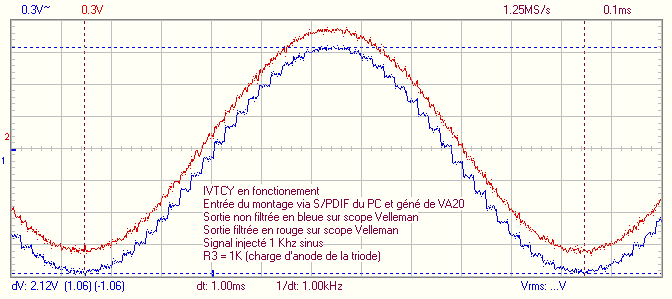

Hi all
This picture is about TDA1543 in NOS mode with our IVTCY (I/V with tube )
the blue line is 1 Khz generated with the 44.1 Khz juxtaposed
count the number of stairs 😡
the red line use a notch filtre around 44.1 Khz
Hope it help 😛

Sorry but i don't use 44.1 Khz , the chip (TDA1543 here) produce it
the pure 1Khz is generated by different source of software
use different kind of output (CD , USB by PCM2904 with different sofware )
All the time the same curve with stairs coming from the output of the TDA
I think it's a result of conversion in the chip 😡
the reason of analog filter in the output in many DAC
