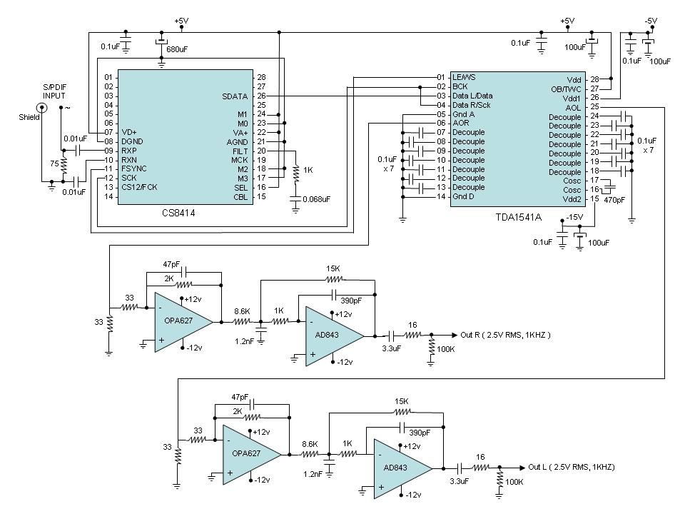

................ When selecting capacitor values with respect to DEM clock ripple current frequency and active divider output current, and using 1uF as maximum value, following would apply:
pin 13,18, 2mA, fDEM /2, 1uF
pin 12,19, 1mA, fDEM, half current (13,18), twice the frequency of MSB, 250nF
pin 11,20, 0.5mA, fDEM / 2, half frequency, half current (12,19), 125nF
pin 10,21, 0.25mA, fDEM, half current double frequency (11,20), 31.25nF
pin 9,22, 0.125mA, fDEM / 2, half current, half frequency (10,21), 31.25nF
pin 8,23, 0.0625mA, fDEM, half current (9,22), 7,8nF
pin 7,24, 0.0625mA, fDEM, equal current (8,23), 7.8nF.
In practice, 1uF (MSB), 220nF, 120nF, 33nF, 33nF, 8.2nF, 8.2nF. This would give equal ripple currents on all MSBs.
Active divider decoupling also depends on DEM clock. Like mentioned before, DEM clock oscillator is able to "lock" on (on-chip) BCK crosstalk. By selecting DEM clock capacitor values that produce (almost) exact multiples of fs, the DEM clock will "lock" to BCK and jitter amplitude would drop significantly. The often used 470pF and 680pF won't result in a "lock" and produce maximum DEM clock jitter amplitude.

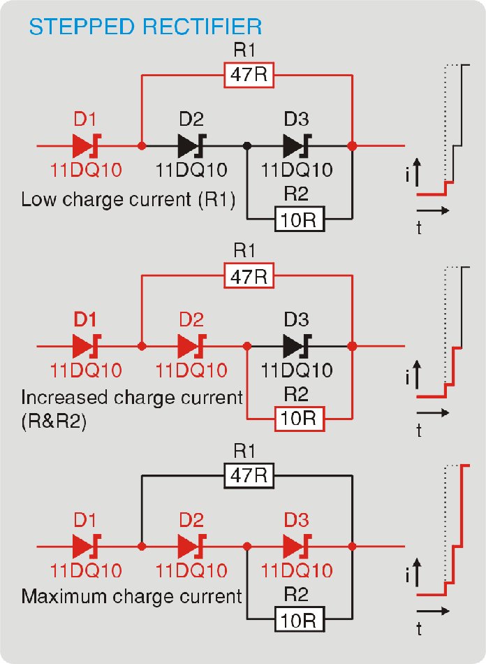

For power supply I now always use 3-stage stepped rectifiers, these greatly reduce (limit) switching noise bandwidth as these offer "soft switching". This has nothing to do with diode type (Schottky) or diode switching noise. Its the effect of switching on / off large capacitive loads like a smoothing cap.
I've simulated the effect of the 3-step rectification, using the values from the published schematic (11D10 schottky diodes, R1=680 Ohm, R2=68 Ohm).
The reduction of spectrum compared to a single step rectification is impressive!
Note that the charge current waveform onset is smoothed, the peak current is reduced, but the pulse is broader compared to the single diode. The integral (=charge) of both peaks is the same.
Rectified voltage is 1.8V lower for the 3-step rectifier and the ripple is the same for both circuits (obviously, since determined by Cmains and Rload).
[test condition: Vsin=15V (amplitude), Cmains=1000uF, Rload=1k]
[circuit diagram: top branch traditional single diode rectifier, bottom branch 3-step rectifier, for head-to-head comparison]

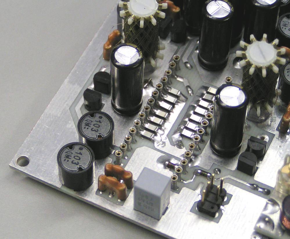

I currently use 14 x 47nF / 16V 1206 size PPS film caps (largest value for 1206 size film cap I could find). These are located underneath the TDA1541A chip and are soldered directly to the pins (shortest possible connection / lowest inductance). I use 2 dedicated GND return paths (L / R channel) that are routed directly to pin 5 and share no other (supply) currents.
I attached a photograph showing how I mounted these SMD film decoupling caps and how I routed GND to pin 5 (AGND).
I now use 1.4112 MHz DEM clock (DEM clock = bit clock), eliminating (on-chip) inter-modulation between DEM clock and I2S signals, and providing extreme low DEM clock jitter as required for maximum performance (bit accuracy).
I didn't use any dividers or flip-flops to drive the DEM oscillator as these add jitter and interference.
DEM clock is injected tapping an approx. 2Vpp square wave signal from the Dynamic Jitter Attenuator circuit. Signal is injected on pin 16 only (pin 17 disconnected) using BAT43 and 12 K Ohm in series (resistor may need fine-tuning). The injector modulates the current on one input of the DEM oscillator, the oscillator now tracks the external DEM clock (can be verified by disconnecting one of the 14 active divider decoupling caps and measuring the signal on the IC pin).
Because the DEM clock rate is approx. 8 times higher than the datasheet application, the 47nF caps are more than effective enough for filtering.
If the DEM oscillator stops (no internal clock signal for the shift registers) massive distortion / hiss becomes audible.
If the DEM oscillator doesn't oscillate or track reliably, low level detail / recordings get distorted.
DEM circuit has significant effect on TDA1541A sound quality, both DEM oscillator and active divider decoupling caps can make or break TDA1541A sound quality as it directly affects accuracy the 6 MSBs.

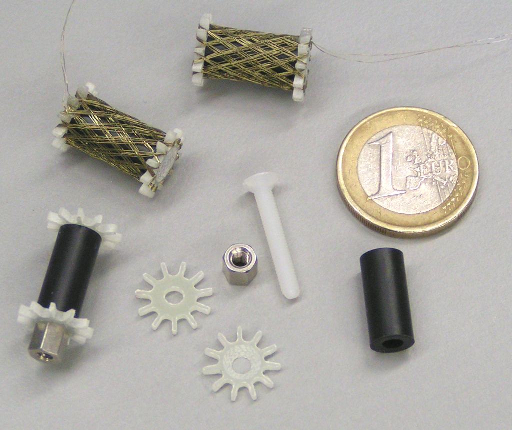

Hi maxlorenz,
Resistors should have non-magnetic construction. The ISOTAN wire I use is specified as being non-magnetic. The frame is made from CNC milled epoxy or HF PCB material with the copper removed. The core is made from a plastic spacer. The frame is mounted using a nylon M3 screw. I used a brass hexagonal spacer for mounting the resistor to the PCB.
I attached a photograph showing the completed wirewound Mobius / Honeycomb I/V resistors, frame parts and a 1 euro coin for size reference.
The winding starts with folding the resistor wire (making a non-inductive Mobius loop). The center of this loop is fixated to the frame. Now both wire ends are wound onto the frame simultaneously. I skip 3 spokes at a time, with one spoke offset between both wires, creating the honeycomb pattern. When completed, the resistor is calibrated by cutting both wire ends until the value is correct. With the given resistance of 1 Ohm/cm it's quite easy to determine how much wire needs to be cut off.
After calibrating, the wires are fixated to the lower part of the frame using glue. The wires are soldered directly to the PCB in order to minimize the amount of bi-metallic links in the signal path.
This resistor has high wattage, resulting in very low noise. This is essential in order to resolve the LSBs that go down to 61nA fluctuation for the LSB.
The resistor needs to be non-inductive (Mobius loop) and have lowest possible self capacitance (Honeycomb winding pattern) in order to prevent unwanted distortion of the large bandwidth signal, output by the DAC chip.
Hi jeepee,
Good to hear that you like this circuit.
It seems the circuit of the stepped rectifier you attached is wrong, I am not sure if simulations are based on this schematic or on the correct schematics. I attached correct schematics (observe current flow). I wonder how this will simulate.

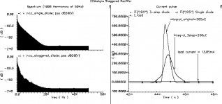

Hi ecdesigns,
I did the 3-step rectifier slightly different then your schematic, but the basic properties are retained in my implementation.
Here are the results for the circuit you posted above (47R, 10R, 3* 11DQ10). I also added the amount of charge in 1 pulse. At 50Hz, this means 50 pulses * 285uC = 14.25mA for the single diode and 50 * 266uC = 13.3mA for the 3-step rectifier. I also plotted the DC load current, 13.05mA. So your circuit wastes less current on higher harmonics or diode charge/discharge. Almost all charge is used by the load!
As for the spectrum, the reduction is quite noticable. Above 20kHz, both rectifiers reach the artificial simulation floor (numerical noise, model inaccuracies etc). Anyway I suppose that beyond -150dB the results are meaningless in practice.
Note: the seemingly solid shape in the spectral plot is actually composed of the first 1000 harmonics of 50Hz...

Hello John,
Thanks for the quick and detailed explaination.
Now I know what are the decoupling capacitors for and their relation to the DEM clock.
However, in your older post, you are trying to balance the ripple current bying using different capacitance value. But now, its seems that its not needed, may I know why?

It's a perfectly working dac. I decided to put the schematic here for someone who thinks to build a diydac using TDA1541.
Actually burn-in process took a lot of time but now it has a really good sound. I want to encourage everybody who hesitate to start to build a TDA1541 Dac.
