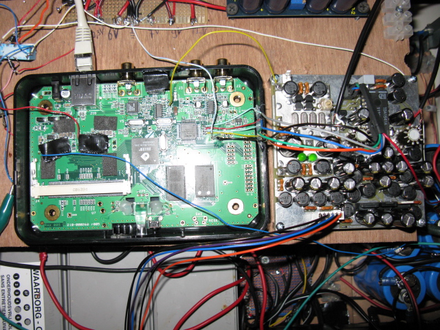

Here a little review on John's new 1541A DAC module. I proberly am the first again who has it playing at home, like the 1543 DAC, which i reviewed a few weeks ago.
Let's start to say that the price of this DAC is not really in the DIY area. For a complete module with Superclock and honeycomb resistor you pay 617 euro. I had some serious doubt to buy it, because the 1543 DAC is already incredible good. I could be satisfied with it's sound. After John mailed me that his 1541A prototype sounded 'fantastic' i got curious. He did the proposal to buy and try it and if send it back when the difference is to close with the 1543.
The 1541A DAC module can be feed with 3x12 volt sources. In my case i use 3 leadaccu's 12V. I2S is coming from a batterie feeded full modded soundblaster reciever. I use a additional reclocker for DATA and WS.
After a few hours listening i can say this; this DAC is another level. The level of detail is about the same, but there is more/tighter bass, more control, more dynamic and what's special: more 'emotion'! If i should try to be critical at this first listening experience, i can't find any flaw's. It's listening fun of the highest level. For this moment i rate it above the best sound i ever heard, the LINN Klimax.
This DAC will stay in my system. The most important reason to keep it is the warm, emotional and full body sound. And looking at the price of the highly rated Altmann DAC, this dac is half of its price. In that sight it's a very acceptable price for this toplevel of sound.

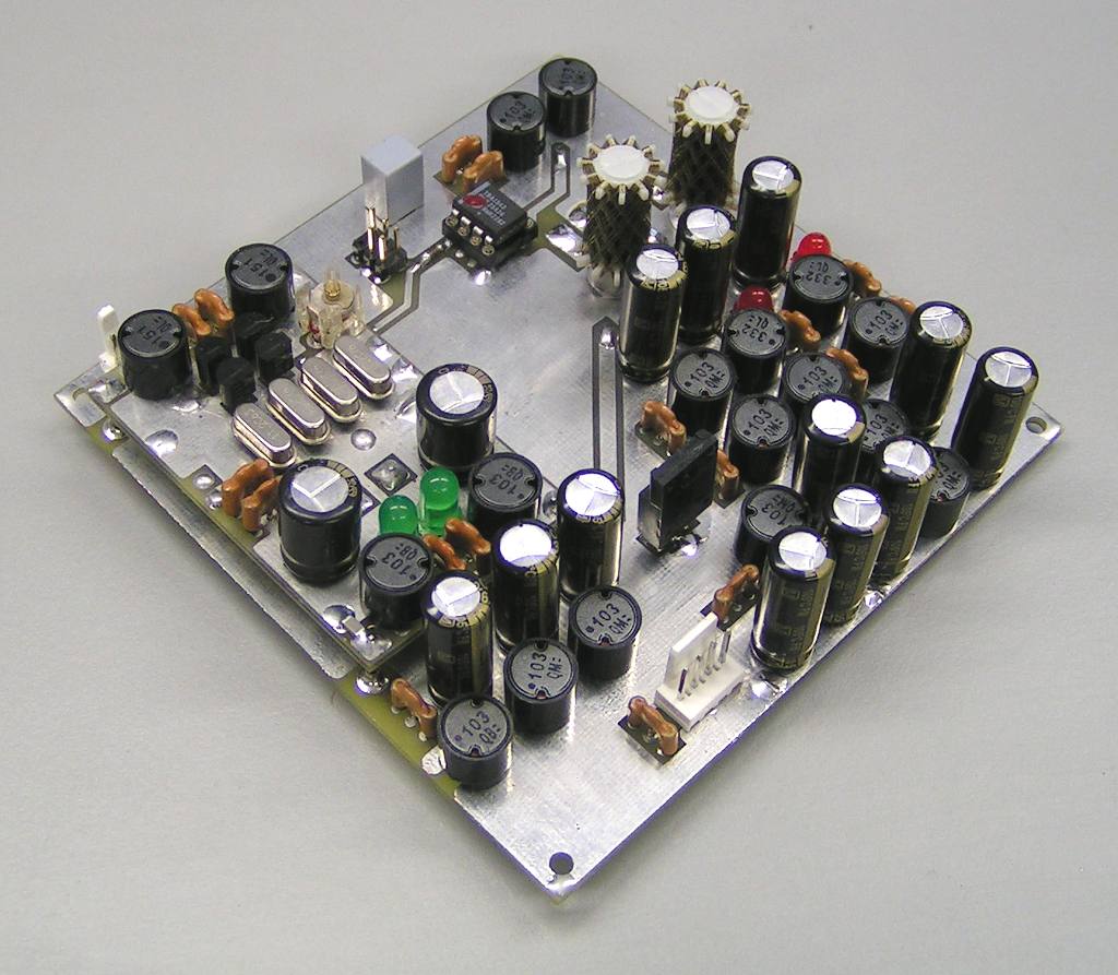

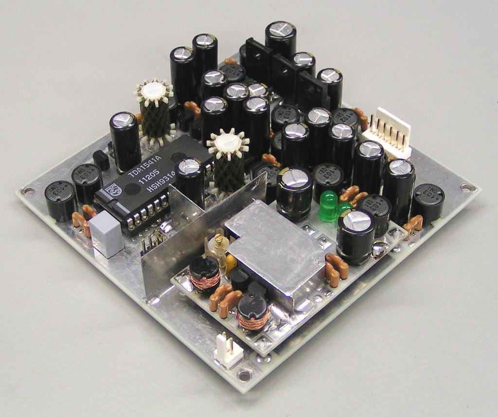

Hi brubeck,
Thanks for this review,
I have adapted (lowered) price for the complete TDA1541A DAC module. The module now includes wirewound Mobius / Honeycomb passive I/V resistors, 4-crystal superclock and TDA1541A DAC chip for eur 399 vat exclusive.
I use the SD-transport to drive the DAC modules and with this very clean source I clearly notice more detail and refinement when using the TDA1541A module, although the new TDA1543 DAC module comes closer now.
The universal power supply for both TDA1541A and new TDA1543 DAC modules is now completed. It allows for both, mains and battery powered operation. It's also designed to power SD-transport and small universal remote control receiver module (being developed).
The existing TDA1543 DAC module has been redesigned (simplified) while performance could even be increased. Price of this DAC module could be reduced too. The module now has on-board regulator and can be directly connected to a 8 ... 12V battery power supply.
I attached pictures of TDA1541A DAC module, new TDA1543 DAC module, and universal mains / battery power supply.
