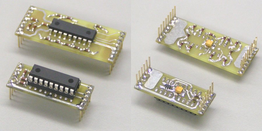

It's a basic design, I am still working on the final versions. I plan to use a fully modular configuration, using miniature modules like in post#2276.
The following modules have been designed:
- 10-bit tracker module (microcontroller-based frequency tracker for source jitter blocking).
- 12-bit tracker module (smaller, more accurate version).
- Interpolator / scrambler / WS / differential DEM clock module.
- VCXO Masterclock & clock buffer module.
- Discrete dual JFET amplifier module.
- Quad TDA1543 module with integrated I2S attenuators.
- SPDIF receiver module.

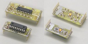

I attached a photograph of both 10-bit tracker module (large one), and the new 12-bit tracker module (small one).

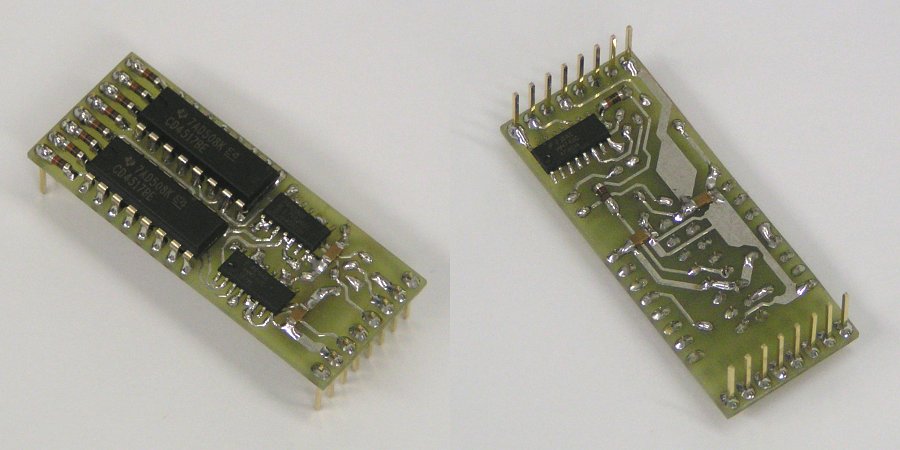

I recently posted a complete miniature interpolator module (only 5 ICs) that CAN be used with SPDIF receivers like the CS8412. I used 2 * twin-64-bit shift-register with taps on 16, 32, 48, and 64. It providing 4 x 64-bit shift-registers. In addition to the 4x linear interpolator, it also has an integrated scrambler that compensates for stereo DAC on-chip L/R channel tolerances, integrated divider that outputs WS (BCK/64)for slaving a SPDIF receiver, and a differential 352.8 KHz DEM clock output (BCK/8) for the latest synchronous DEM clock circuit. All DATA and WS outputs have resistors installed that are part of the I2S attenuators.
The module has 16 pins:
WS16, WS32, WS48, WS64, D16(L/R), ND48(NR/NL), D32(L/R), ND64(NR/NL), VCC, BCK-in, WS-out, NDEM, DEM, DATA in, GND(2x).
I used the available DLY16 outputs to drive the first DAC (similar function as the 2 D-flip flops in the posted schematic), this results in adding 16 to the other 3 delayed outputs.
