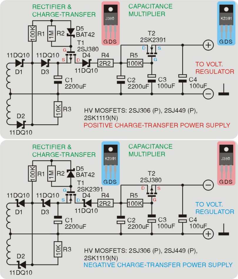

I attached the schematics of the charge-transfer power supplies that are being tested in the DI4T. There are two versions, one for a positive power supply, and one for a negative power supply.
Both D1 and D2 are rectifier diodes, D3 is added for generating a 100 / 120 Hz pulsed-DC signal for driving the gate of T1. D1 ... D3 are Schottky diodes.
R1 limits the current through the MOSFET internal gate protection diodes. If a MOSFET is selected that hasn't got internal gate protection diodes, these have to be added externally (2 x 12V zener with cathodes connected together, connected between both gate and source).
R2 (1 M Ohm) forms an LC filter together with the approx. 1.1nF gate capacitance, this will reduce the peak charge-transfer current when the MOSFET switches-ON. D5 (Schottky diode) ensures rapid switch-off by bypassing R2 during switching-OFF the MOSFET T1. The MOSFETs aren't critical, but should be suitable to handle required current and voltage, low RDSon is preferred.
D4 is added because the 2SJ380 has an internal freewheeling diode between both source and drain, it also reduces the effect of both MOSFET output and transfer capacitance. R4 limits the peak charge current during charge-transfer between C1 and C2. R3 is required to pull the gate of T1 to ground when D1 ... D3 no longer conduct.
T2 forms a capacitance multiplier, it's basically a source follower that buffers the voltage across C3. The advantage of using a MOSFET is higher efficiency than when using darlingtons, especially with higher output currents. It's best to use logic level MOSFETs here (lowest voltage drop), typical voltage drop is between approx. 1.6 ... 2V. Both charge-transfer circuit and gyrator will introduce a typical voltage drop of approx. 4 volts.
Both C1 and C2 value depend on required load current. The indicated values are for approx. 250mA.
It's also possible to use half-wave rectification, then D2, D3, and R3 are left-out. R1 goes to the anode of D1, and R2 is increased to approx. 3.3 M Ohm.
The charge-transfer power supply output is connected to a suitable voltage regulator that basically receives a clean DC input voltage without significant ripple voltage.
When building High-Voltage versions for a tube power supply, High-voltage fast-slow recovery diodes have to be placed in series with D1 ... D4. The voltage rating of both capacitors and MOSFETs must be adapted to the required voltage and load current. I use 2 x 68uF/400V for the DI4T tube power supply.
The values of resistors 1 ... 4 needs to be adapted too, for example R1 = 470K, R2 = 4M7, R3 = 100K, R4 = 22R (depends on MOSFET specifications).
The circuit could be further optimized by providing a constant charge-transfer current (current regulator).

Hi agent.5,
Do you think it is possible to use a LCLCL filter to replace the capacitance multiplier and voltage regulator, at least for your tube amplifier B+?
The capacitance multiplier is required to achieve very low ripple voltages on B+ (typical < 100uV rms). It's a very compact and cheap circuit compared to multiple chokes and electrolytic capacitors.
Voltage regulator is preferred (stable voltage). LC filters can be added after the voltage regulator to get rid of residual RF / HF noise.
I already use small LC filters (20 Henry and 47uF), after the HV charge-transfer transfer power supply, capacitance multiplier, and voltage regulator.

Hi maxlorenz,
What about Mosfet's VGS(th)?
The MOSFET gate threshold voltage is not very important for the charge-transfer circuit (plenty of voltage to drive the gate).
With the capacitance multiplier, Vgs(th) is rather important, as it directly translates to the voltage drop (efficiency) across the circuit. So here MOSFETS with lower Vgs(th), usually called logic level MOSFETS are preferred.

Hi John
You already described the modifications needed for a HV version, but I just want to confirm two small things:
1 - About the HV diode in serie with the Schottky. Is this the same as the hybrid version as described in post #2110?
I also used Schottky 1.1KV / 1A Hybrid diodes in the HV tube power supply. These provide a very clean sound, I tested these diodes with a pulse generator, recovery is identical to Schottky diodes.
Is any form of voltage equalization needed across these diodes?
2 - About D5. Will the BAT42 survive the high voltage circuit? This is just a demonstration that in fact I do not know everything what is going on there. I do think that the voltage between source and gate will never exceed the maximum voltage of the BAT42, but I would like to ask anyway.
I found two high voltage P-channel mosfets: the MTP2P50E by ONSEMI and the FQP3P50 by FAIRCHILD. Both will require the addition of the 2 12V zeners. Do you have another suggestion for a HV mosfet?
