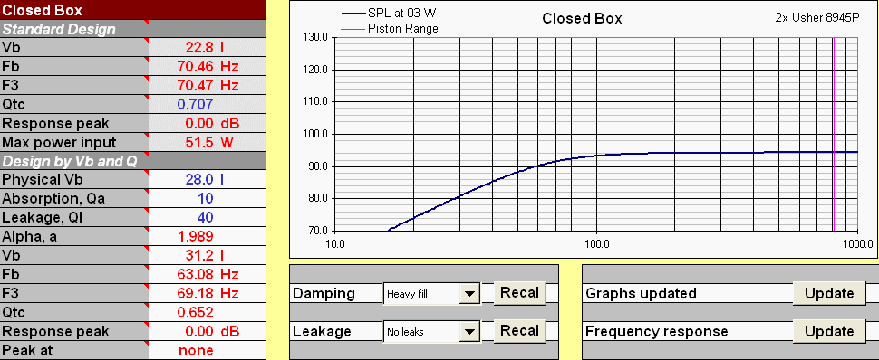

Ceibal said:
I did the math wrong. It would help if I converted the size of the box from cubic feet to liters.
I edited and made the adjustments in the original post.
In fact, to be more accurate, you need to take into account box leakage and absorption as well as series resistance in the xover due to inductor DCRs. Attached is my Unibox sim for dual 8945Ps in a 28 liter (1 cu ft) sealed box.
Jay_WJ said:In fact, to be more accurate, you need to take into account box leakage and absorption as well as series resistance in the xover due to inductor DCRs. Attached is my Unibox sim for dual 8945Ps in a 28 liter (1 cu ft) sealed box.
..and from what I remember Unibox is a more accurate modeler.
Also,
Ceibal, don't forget that the low freq. response will actually be more "extended" than what Jay has in that graph. With moderate BSC and room gain you are basically flat to 60 Hz with a -3db point somewhere between 40-50 Hz and a lot of near level extension below that.

I am leaning toward the Scanspeak 18w/8535. They have a QTC of .71 in a 1 cubic foot box. Of course, I have not taken into account the damping material. If I am right, this will raise or lower the QTC and FCB?
This is not the best way to design and build a speaker - starting with the box and selecting drivers to suit is not optimal. Why not build your own enclosure?
A better approach (if you can't build your own box) is to go with an established design that will work in the box size you want or smaller. You can then add material to the inside of the box to reduce volume.
Ceibal said:Also, what is your opinion on using Madisound to design the crossover? I figure for $30 it might just be worth letting them do it instead of me investing a grand or more in software. I will still learn allot by putting the crossover together myself.
According to my experience of seeing their designs, Maidsound xover design service does not take into account baffle step loss and even phase tracking between drivers. You get what you pay for.
