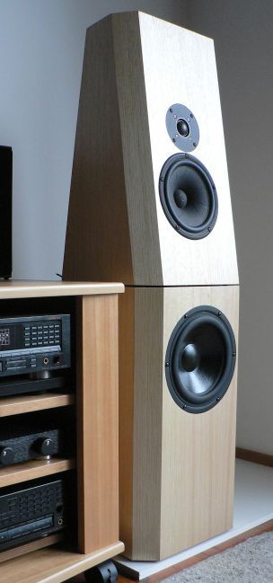

To explain what I am wanting is this: To build a set of speakers that have a high level of detail with out harsh highs. I like the highs to be smooth and natural. The drivers should provide a good level of bass without loss of detail to the music. This is why I am looking at the SEAS Excel drivers. However, I have yet to do the math as to if they will work in the enclosure I have chosen.
Ceibal said:To explain what I am wanting is this: To build a set of speakers that have a high level of detail with out harsh highs. I like the highs to be smooth and natural. The drivers should provide a good level of bass without loss of detail to the music. This is why I am looking at the SEAS Excel drivers. However, I have yet to do the math as to if they will work in the enclosure I have chosen.
The BAMTM should do that.
If you are still bent on designing your own then the drivers for your application that I'd recommend are:
Usher 8945A X 2 in an appropriate bass reflex design (i.e. a lower freq. tunning than "aligned", probably a little lower than what is referred to as an extended bass shelf design).
Neo 3 PDR and a lower freq. crossover..
Note Dennis Murphy's statement on this:
"I had not realized the Neo planar tweeter could be crossed as low as 2000 Hz, and doing so definitely makes for a more enjoyable speaker."
If designed properly, it should be what you are looking for. (i.e. that "5k beater".)

I am really set on a closed design. Would this woofer work in that setup? Looks to have to low of a QTS according to what I am reading.
The efficiency bandwidth product(EBP) is a guideline and because of this you'll find some drivers work well in circumstances that the EBP would lead you to believe otherwise.
My favourite example would be the Peerless XLS10 with its Qtc of 0.19. Despite that it works well, maybe even arguably best, in a sealed enclosure.
