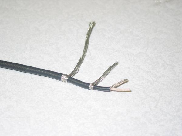

my double braid cable
Final test results..
Inductance was between 16 nH per foot and 9.75 nH.. Meter resolution was the limiting factor..gonna work a new meter next week for better resolution..
Capacitance was 288 pf per foot. Dielectric was a 10 mil thick (.010 inch) tefzel heatshrink, DC 2.7.
Inductance is very low b-cause the inner conductor is a braid..so the overall coax does not have the self inductance component that is unavoidable with a center solid wire.
Cheers, John

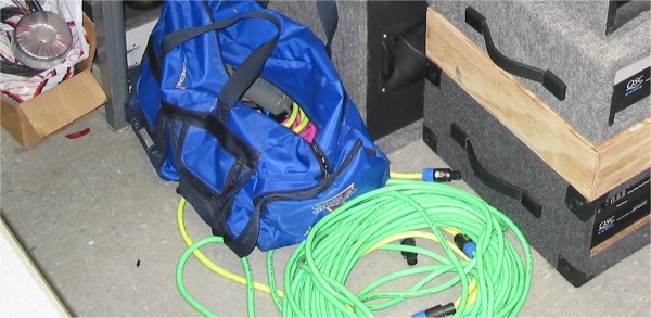

Sy, you mentioned using outdoor extension cable as speaker cable. That sounds like something fun to try. All you do is just cut off the connectors, strip the wires, and hook them up to your speakers? What do you do with the other wire? Also, how does this sound different than regular speaker wire? Thanks
Dave

In order: yes, just cut off the plugs, strip the wire, attach the connectors of your choice (spade lugs, bananas, Neutrik, whatever) and off ya go. I generally pair up (i.e., run in parallel) two wires for one leg, and use the third wire for the other, which drops the loop resistance. It doesn't matter which two you choose to pair up. Don't get hung up in ignorant claims about symmetry or direction or whatever- this is AC.
As for sound, I wouldn't generalize. Try it for yourself, see what you think in your system and your room, then take the money you would have spent on some magic cables that defy the laws of physics and buy some CDs or records.
The bright orange color is really fun in a trailer-trash sort of way.
bonsai171 said:
is there any dangers to using this?
tia
If you cut off the plugs, no danger whatever.
Re: my double braid cable
Cheers, John
Hmm. The low inductance might derive from low cable impedance even though the parallel capacitance is high. The equation for coaxial cable impedance is Z = (138 / e^(1/2)) * log (D/d) where e is the dielectric constant between core and shield (1 for air), with D and d the inner diameter of the shield and the outer diameter of the core respectively. Since you wound the effective shield atop another shield with a thin layer of insulation, D/d would be fairly close to 1, ergo log(D/d) fairly close to 0.
Now recall that, modulo low resistance, for transmission lines Z = sqrt(L/C), so if Z is small then L is also small for a given capacitance.
I doubt whether have a center braid or solid core would much affect the series inductance, save by the effects of a different inner diameter.
Anyway, that's a way-cool cable despite my *****ing. Nice work!
Francois.
Cheers, John
By the way, your construction reminds me of Belden 9222. You might want to check that out.
Francois.

Re: Re: my double braid cable
Francois.
Thanks. But I'm posting to GET ""my *****ing""...IOW, the opinion of others.. so don't apologize...
Inductance is the measure of the amount of energy stored in the magnetic field as a result of current.. For any wire it is the sum of the internal energy stored by the internal inductance...and the external storage, which is the mag field outside the conductor.
The internal braid was used to remove the internal inductance..From Orstead's law, integration of the area inside of the braid shows zero inductance there, as there is no field, because there is no current. So, the internal inductance of the inner braid is zero., not .015 uH per foot, which is what all wires have at DC.
A coax has lower inductance because the outer braid produces a magnetic field which is opposite that of the internal conductor. If the fields are opposite polarity, as a coax typically is, the fields cancel. Since the outer braid does not have any field inside the cylinder, it cannot neutralize the field of the inner one between the conductors..ie, within the dielectric.
So, to minimize inductance of a coaxial construct...make the inner conductor a braid, or tube, to remove it's internal, .015 uH per foot inductance...minimize the spacing between the inner braid and the outer.
The characteristic inpedance of the overall will, as you point out, be dependent on both L and C, as will prop speed. But this cable experiment is designed first to minimize inductance at all cost (cost being dielectric withstanding between conductors). And then, after test verification of models by using various sizes and dielectrics, coming up with general equations for L and C and how they relate to the sizes of the conductors and the dielectric type and thickness.
I was pleasantly surprised at how incredibly low the final inductance was..
I'm gonna test dielectric withstanding for the cable, 1Kv being my test goal, then I'm gonna have an "audiophile" friend try them in his stereo..he claims he can hear the differences in cables, so I'll give it a whirl.
Cheers, John
Francois.
Wow...did check it out..thanks.
Triaxial ..
inner shield :4.7 ohms per Kfoot
Outer shield:4.3 ohms per Kfoot.
both between 16 and 17 ga.
And cheap!! a 500 foot spool is only 110 dollars in the allied catalog. and 100 feet is 22 bucks..no price break there..
Gonna pick up some to measure..it would be another good data point.
9888 is even more interesting. inner wire is 11 guage..inner shield is 1.2 ohms (11 ga.), outer is 2.1 (13 ga.). But it is 717 dollars 500 foot..or 1.43 USD per foot..and it's half inch diameter.
Good thing is...you can pull it with 326 pounds tension (for those difficult home stereo apps...)
I'm not gonna buy 500 feet of that..that would be a group buy..and worth it only if it is an improvement..
Thanks again...
Cheers, John
wonderful orange power cable
Sy, thanks for the tip on the cable! I had some extra power cable around, so i gave it a shot last night. In my system, it has an incredibly clean sound- the mids and highs are really really nice, and the bass is very tight! Plus, the orange color and thick cable makes it look like very expensive cable too lol 😉 cheers!
Da5id4Vz said:
Is that some of that cool stay felxible when its cold cable?
Ummm..do you mean in liquid helium cold? I don't know..
It says on the side...
"CAROLRCOOLCORDTM 12/3 SJTW OUTDOOR E-11368 W-8 (UL) - - C(UL)
I wasn't sure if "coolcord" meant cool colors, or cool outside temp..or, honkin-guage-so-not-so-hot-when-pushed...
Cheers, John
