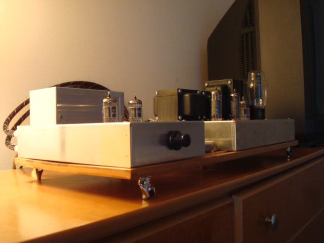

To give me a starting point, can you provide the dimensions of your pictured amp?
After I get the amp built and working, I'll build the final housing/plinth.
Doug
Doug-
A bit of background:
My RH84 is quite a bit bigger than it needs to be. When I built my Pointz 'MusicMachine', I made a spare chassis/enclosure, 'just in case' I made a mistake or wanted to build a 2nd one. I used it for the RH84, which I gave to my nephew as a Xmas present. (Great-sounding little amp, in spite of the very modest iron)
Notice that I used butt joints in my woodwork- easier to construct and the projecting 'ears' on the front help to protect the pot/switches if you have to pack or ship the amp. Miters would possibly look better.
The overlapping top plate (1/8" aluminum from the junkyard- cut with a non-ferrous metal blade on the tablesaw) and bottom covers are 'structural' and help to hold everything together. Total cost was under $10.
The open space between the power supply and amp sections in the Pointz enclosure makes the construction more complex. I'd recommend just keeping the same dimensions, but using a continuous top plate if you don't have a lot of tools.
Dimensions (in inches) are 21.5 x 10.5 x 3
I recommend building the enclosure first, before mounting and wiring components. It's a known design which will work, so no breadboarding is necessary. Also, you don't want exposed 400v wiring around the house.
Cheers
John

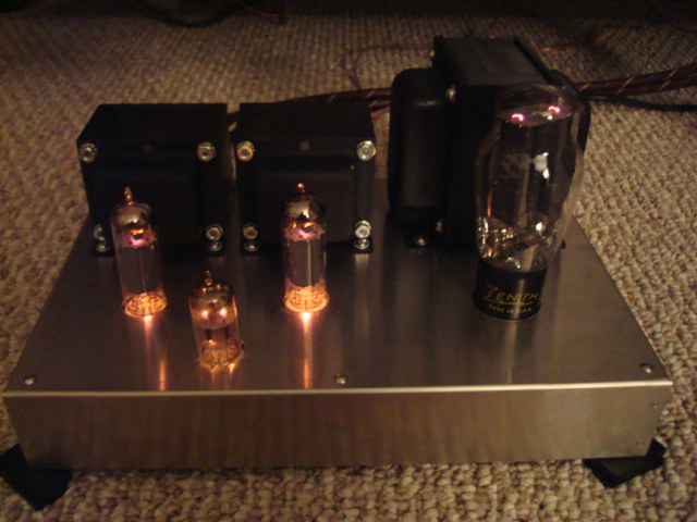

did some one said RH84?
here's mine aluminium (hammond $20) 12x8. i like to keep it as simple as i can you dont save much on diy chassis if cost was an issue.

Re: the pre?
Alex Kitic said:
And what pre would that be, if I may ask? Maybe by the same author, the line section of the RPA... or maybe not.
What is the criteria you apply in choosing your pre? Frankly, while I am not a passive pre advocate, you do not need much gain with the RH84...
Alex
Hi Alex.
The pre is the bottlehead i got from a friend it was not working properly, so as a newbie i like to fix things, so i rebuilt it from the ground up. i figure they looks good together😀
BTW; Alex, for my next build i would love to try your 300b design but some how i cant E-mail you on ur site.
