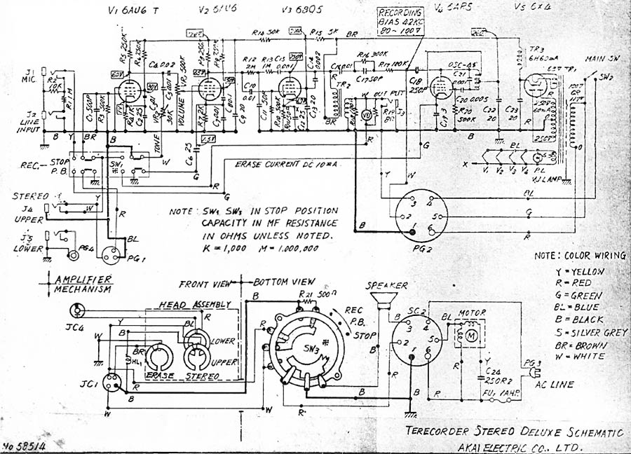

Looking at the blurred Akai M5 schematic that I googled makes me think that a smaller reservoir cap ( 22uF ) should be used instead of the 47uF that is in the RH84 schematic.
I think I have that figured out. The 6x4 is rated to 40uF so I went with a 30uF filter cap. I originally decided to stay with the 6x4 because the Akai transformer's heater secondaries were the right value for it. Is there anything else I should be concerned about? Earlier in this thread someone said that the bias should be alright as is.

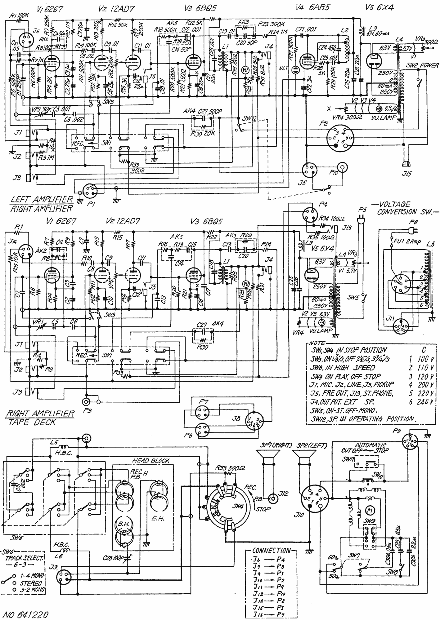

Here is a better one.
Hi Planet 10, That's much clearer, clear enough to notice it's a different schematic to the one I found. 😉
Note that both channels are not the same.
I presume that the audio output transformers are identical and suitable for service in the RH84. Nearly made that mistake with a Telefunkin console, one channel was normal the other was for a bass woofer!
Hi Harmolodics, If your B+ is around 300Vdc then I would stick with the 270 Ohm cathode resistor. Tweeking can come later 🙂
I'm guessing that the extra bits in the top channel are to drive one or more of the tape-heads -- it is a power pentode sometimes seen in SE output stages.

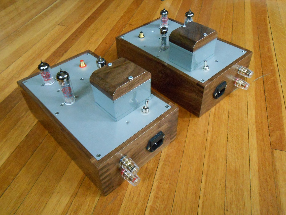

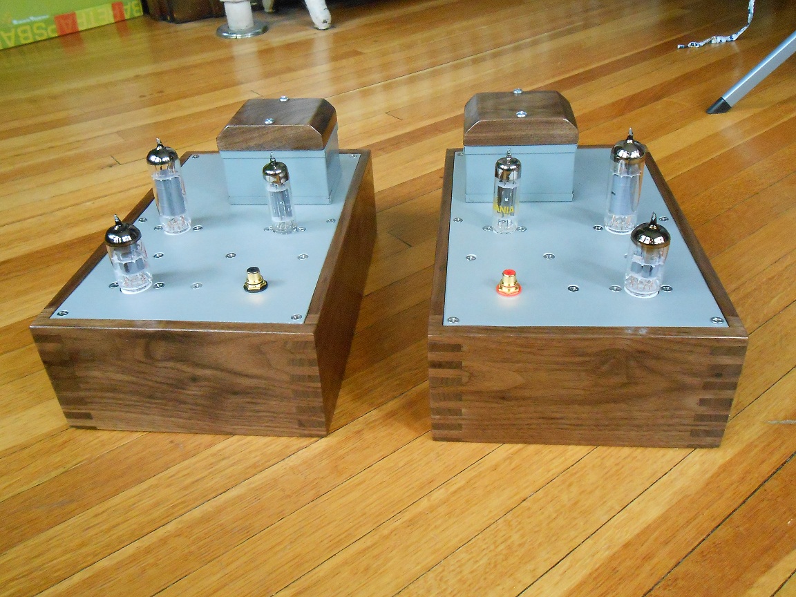

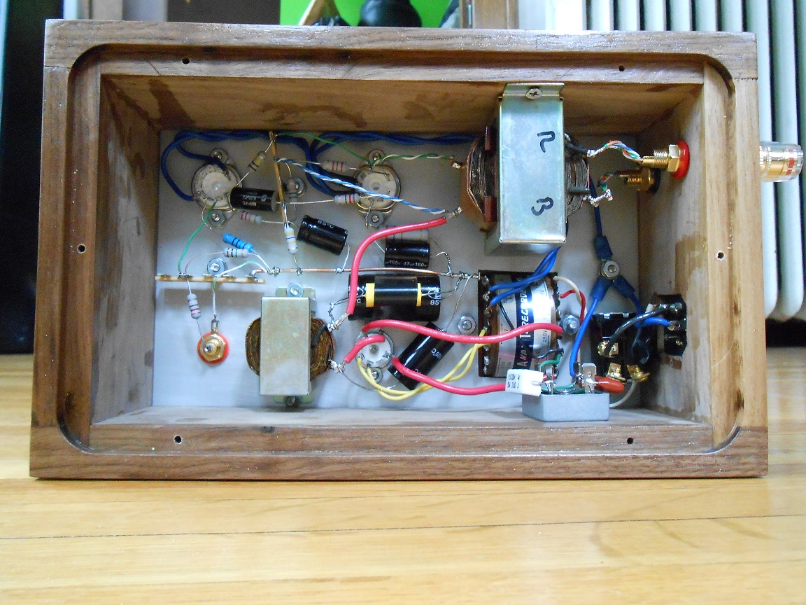

Finished Mono RH84s
Took a lot longer than I thought, but I'm happy with the result. Haven't gotten to hear them much because my speakers aren't done yet. But they worked when I tested them. They both buzz when the input is disconnected, but are otherwise quiet. Is that common? I haven't found to much information on troubleshooting this issue.
