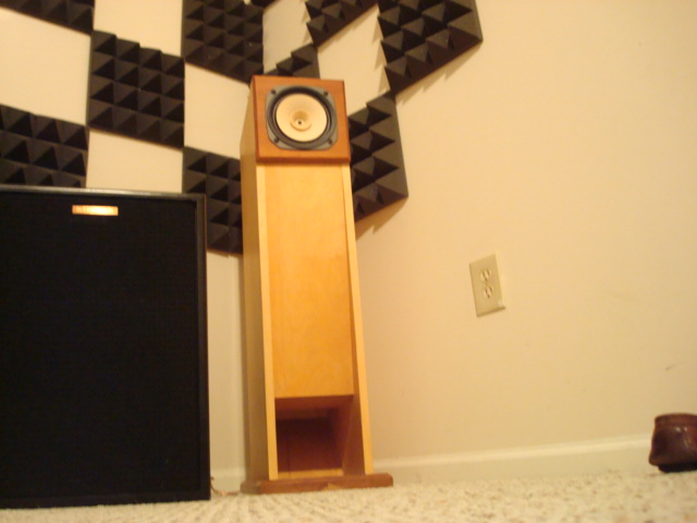

Re: Re: Re: more details...
planet10 said:
Which Fostex BLH?
I had a set of alnico Heresys and they were a joke. Fat, fat, bloated bottom end and very disjointed thru-out the entire range. I burned the boxes and sold the drivers to a guy in Hong Kong.
dave
Fostex FE206E
"I had a set of alnico Heresys and they were a joke" sorry to hear that, but that what i felt about the fostex maybe its just not my cup of tea.

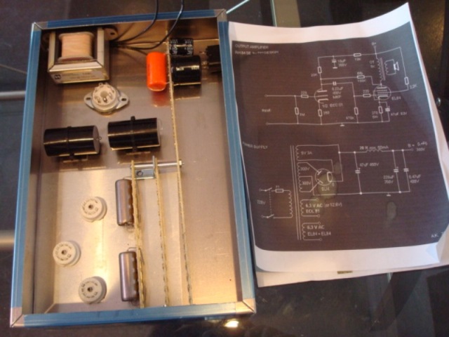

Re: Re: im also in the process of my second rh84
Ty_Bower said:
Where's the pic of the top, Tim?
im still waiting on the PTX should be in soon.
the pic is layout im trying to work out, but im in the process of moving so dont have time to work on it yet until then i think i will start a new thread on the built.
If you want the sound of tube rectification without doing all the nasty case work - try this. Place a 200R resistor in series with each rectifier - this should make them behave a bit more like valve rectifiers. Snub all your rectifiers + resistors with 0.1uf caps (rated at about 1000V - cheap ceramics should work). Snub across the secondary of the power transformer with something like a 0.1uf cap (1500V ceramic again). This should eliminate any ringing which can bleeed through to the power amp.
If you get a significant improvement then consider going over to valve rectification.

Re: Re: Re: Re: Re: more details...
planet10 said:
Is that the Fostex recommended BLH? It isn't a very good example. I can understand why you weren't enamoured of it.
dave
according to the guy i bough it from it was bulit within spec, i've also have heard several different BLH (fostex) from different people, all were not very special. i was very diapionted.
I have always anticipated that the Fostex drivers would have a fairly bright analytical sound, rather in keeping with the Japanese style of music. I could be wrong though as I have never heard any in the flesh.
I found the European vintage alnico drivers to have lovely soft tones.
Shoog

Re: Re: Re: Re: Re: Re: more details...
tim614 said:
It isn't a very good example "how so?" please explain.
It is not a very good design. If you can live with a BLH* there are better ones.
*(by its very nature, the bass in a BLH is delayed in time. The notes that are coming out of the horn started out out-of-phase and then travel the length of the horn. In a well designed horn, this will be (2n+1)/2 wavelengths (n=integer) at the highest frequencies and a 1/4 wl at the lowest frequencies, This really bothers some people, others have no problems with it)
dave
