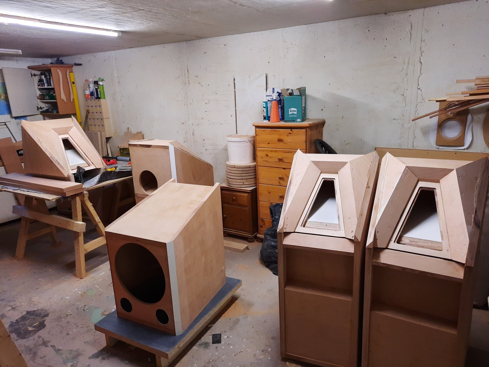

Proud of your work? 😉
I definetly like the angular design of the top/back. Reminds me of Lamborghini. That said for bookshelf's speakers you managed to keep them tiny. Lol.

I think this style of sharp angles is coming back to fashion... and yes that was the idea of the top design....
I have yet to found a way to integrate the super tweeter without making it looks like a birthday hat 🙄🤔

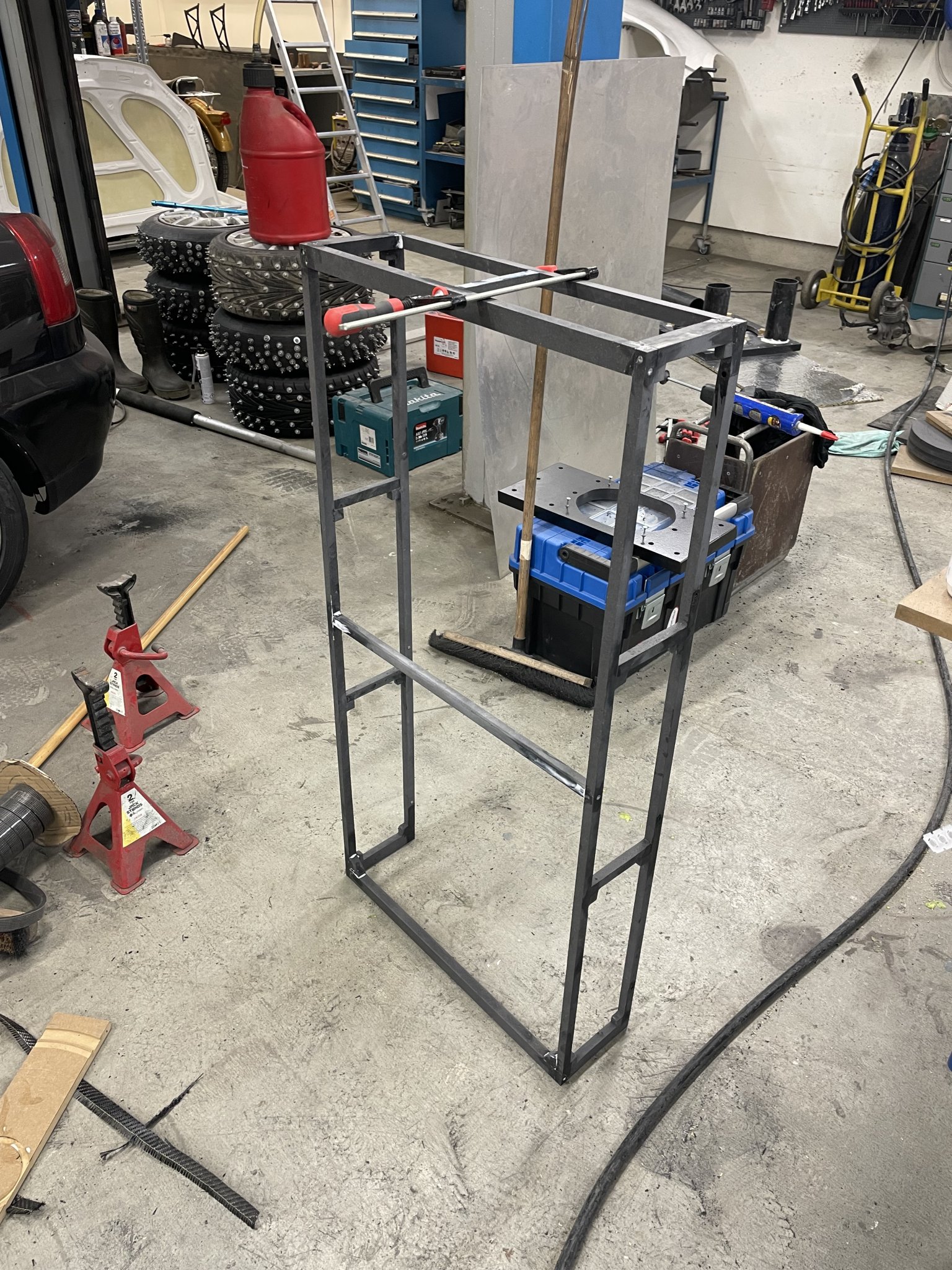

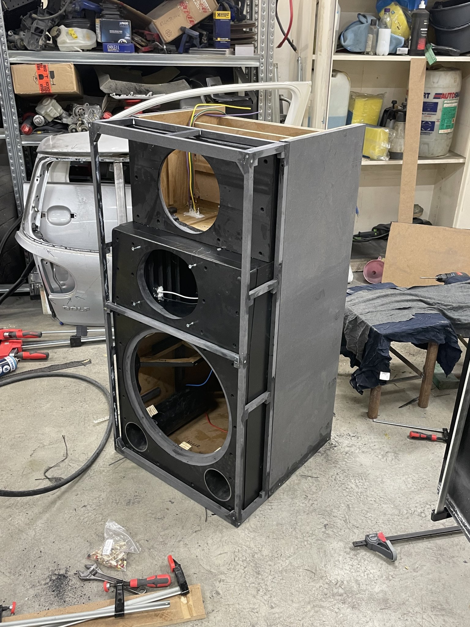

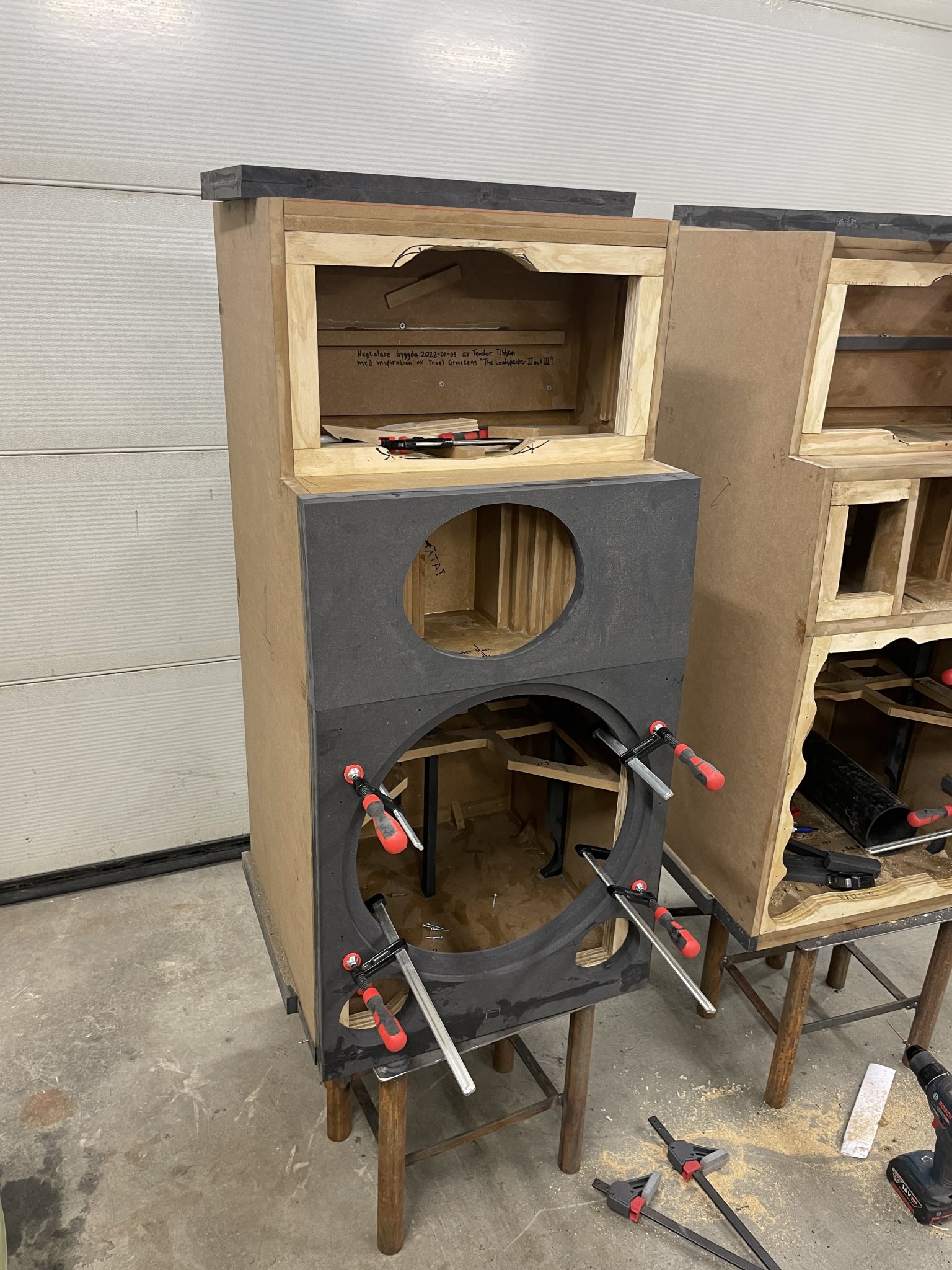

My speakers are much more simple build than yours. Made from mainly MDF and Valcromat, mostly 2x16mm glued together. Internal material is what I had in the garage.
I really liked the look of TL3 but I wanted the 18" BMS so I made a hybrid.
Box volumes and speakers are just like TL2 except I will try witout the supertweeter to start with.
First I will use them active with a few Hypex plate amps and If I dont like it I might look into passive crossovers. I build them with baffles thats possible to remove and put other elements/baffle shapes. I have much speaker elements from other builds so I dont know where this ends😏
~3/4 finnished or so, I started this year so I have put some time in the garage lately.😀

I try with the huge possibilities Hypex have. I have some experience and things to measure with so we´ll see how it goes. I can always order crossoverparts and go that route.
