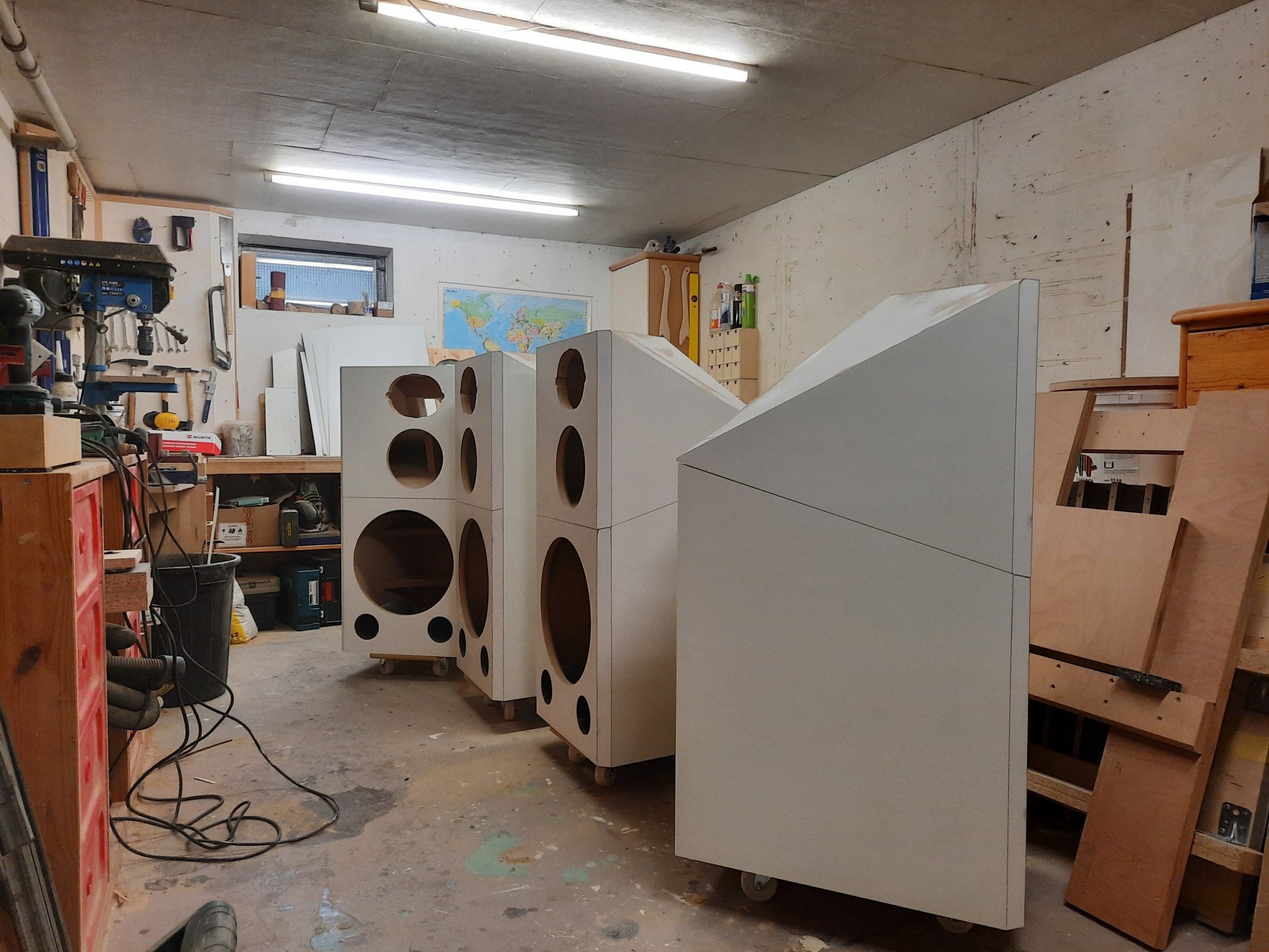

I am still trying to decide what material I am going to use for these speakers.
I mentioned to my friend that built the TL-1s, that I am going to use 1 inch birch plywood for the cabinets and possibly glue two sheets for a total of 1 1/2 to 2 inches for the face.
He said he is using Baltic birch and it sounded like he inferred that birch plywood was not good to use.
I wasted a whole day yesterday calling places to see if I could find Baltic Birch. The only sheets I could find are half inch. Can you guess why it is so difficult to get?
I tried to find the black MDF/HDF, I was only able to find that in three-quarter inch sheets.
I was able to find something called Pluma-ply, which is a thin veneer of HDF with solid popular in between. The thickest I could find it is 1-1/4”. (The distributor is quite a drive from my house. But I could make it work)
I have been calling to get pricing for bamboo. I can get it in 1-1/2” sheets, but the places I have found do not want to sell half sheets.
I did my layout and I need Half a sheet for the face and 3 1/2 sheets for the cabinet and bracing.
The bamboo is a lot more expensive than the birch plywood.
I am planning to paint the speakers anyway, because I do not want to put it completely together with hidden fasteners. At the very least I will pin it together with pneumatic finish nails.
also, I am building the pantry cabinets under the stairs and I was going to conceal the fact I was buying extra plywood for these speakers, because I was buying the other plywood. The way it looks now I will have to buy material from three different places, which could potentially be an issue for me, ha ha
please give me your advice😳🤔🤪😢

PS I also found 1-3/4 baltic birch butcher block countertop, that I could use for the face.
Maybe then, I could use the 1 inch birch plywood for the case and bracing??
Dude, if finding baltic birch is so hard, just scratch my comment on MDF… and pick some good quality 30mmm-40mm MDF somewhere. it is after all easier to work with, and cheaper. +PS I also found 1-3/4 baltic birch butcher block countertop, that I could use for the face.

In my books, MDF is not superior to plywood.
But, as long as the cabinet is well braced and you're using 30mm-40mm of it, you'll be fine.
In Germany there are some differences In the mdf quality. Higher density=better
Butcher block is not advisable. Raw wood is an unreliable son of a bit##@. It can spliter and crack... it's just not homogeneous enough for loudspeaker building. If you like the look though you can achieve it with veneer

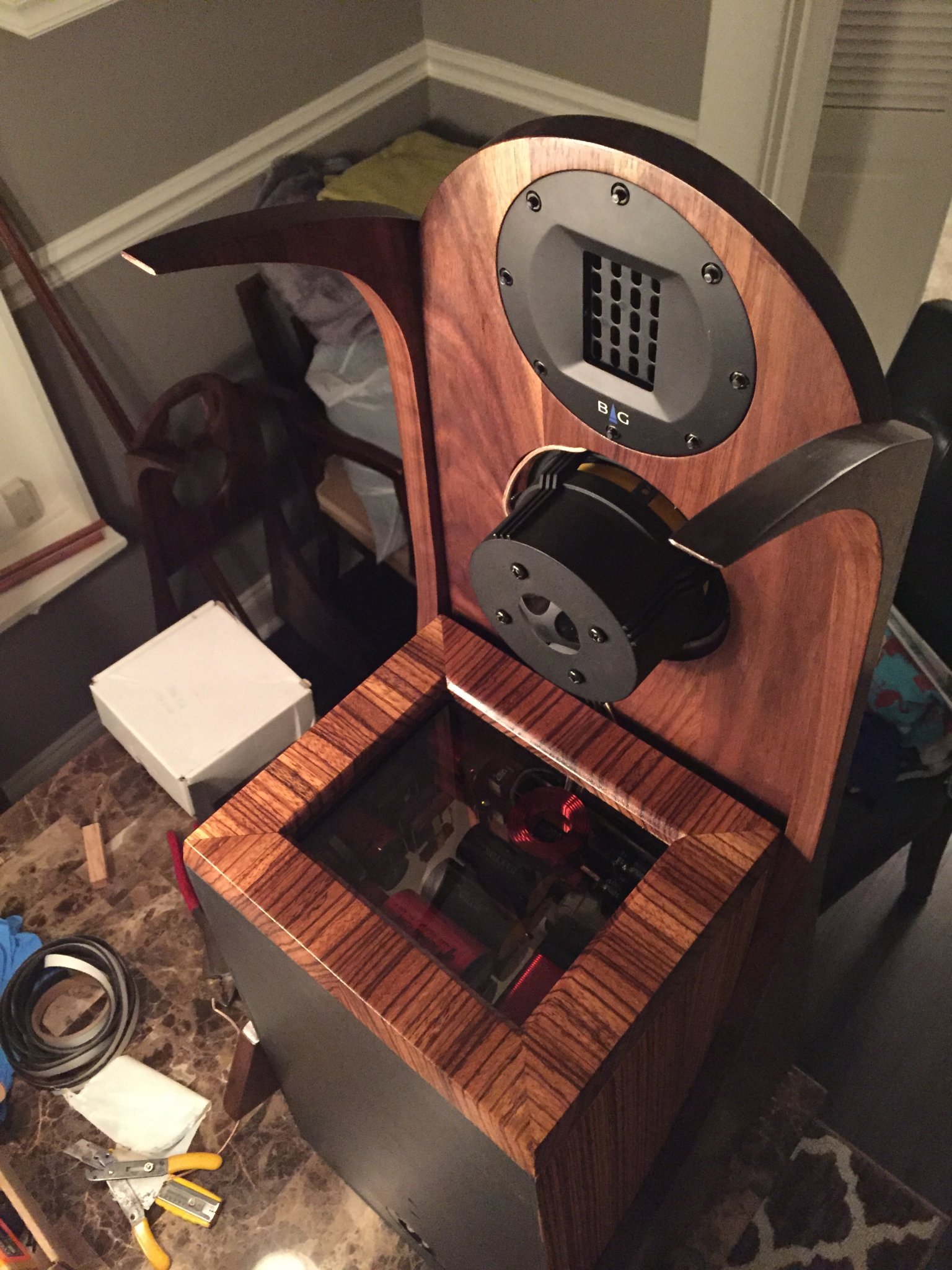

It looks like they’re probably wandering around in there.
One of them says the other, hey guys come over and look at this.
they look like droids. Their power is the sonic wave.
imagine being right in the middle of all four of them at the same time at full volume.

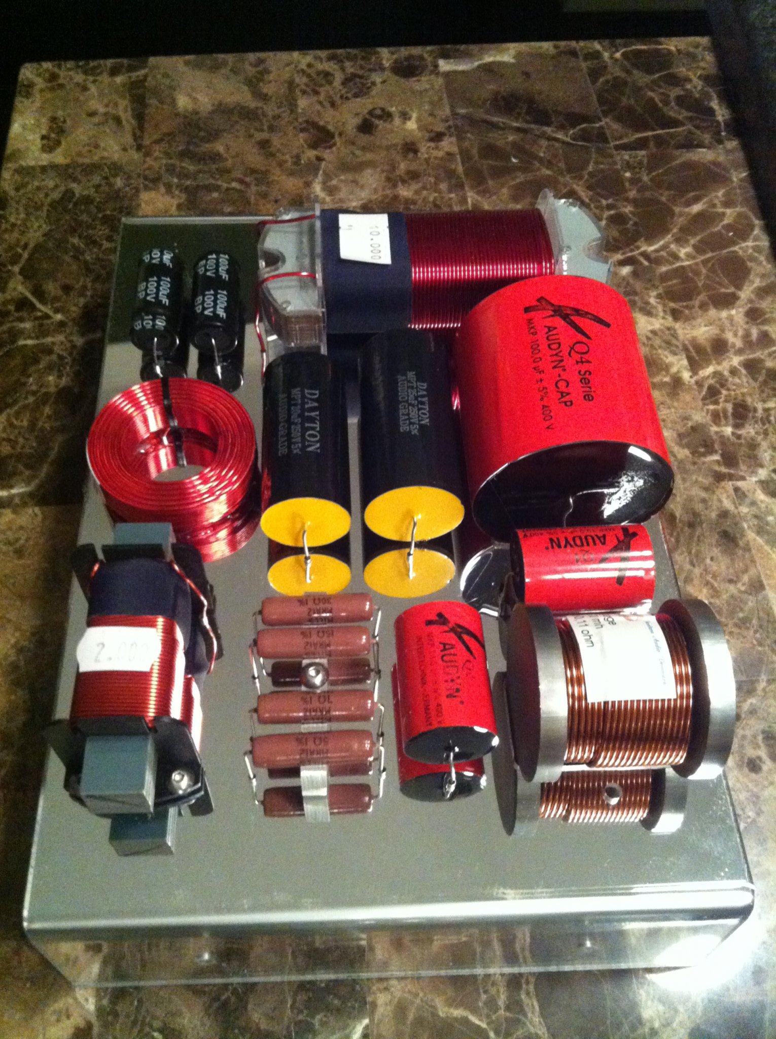

Right on, man! That is something else, from design, to the work. Bravo!
Really like the window to the crossover and totally agree to showing off the expensive junk that normally just gets hid inside. I did it on one of my projects. All the components are mounted on mirror plexiglass and under bronze tinted glass.
Thank you so much for the cool comment! Appreciate it!Right on, man! That is something else, from design, to the work. Bravo!
Your work looks awesome ! And yes, whats the point in buying those shiny caps and them hide them away?!…
Still your best work, Eric! Those were great...Right on, man! That is something else, from design, to the work. Bravo!

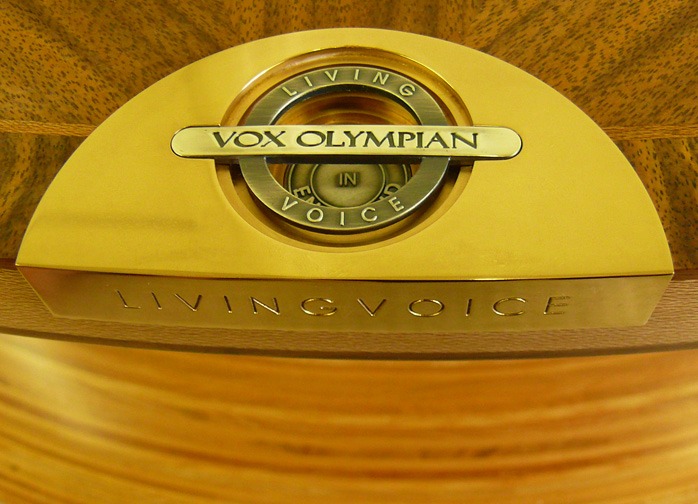

When someone dares to pay 800.000€ for Vox Olympian (or any pair of loudspeakers ftm), that means that taxes aren't properly regulated in that country 🙂
Airplane Utva Sova in my country costs 300.000€ 🙂 The mofo thing flies, like a bird, in the sky (which humans can not by nature) for 40% of the price of those loudspeakers 😀
Imagine the price of development, permits and licences needed to make it legally airborne...

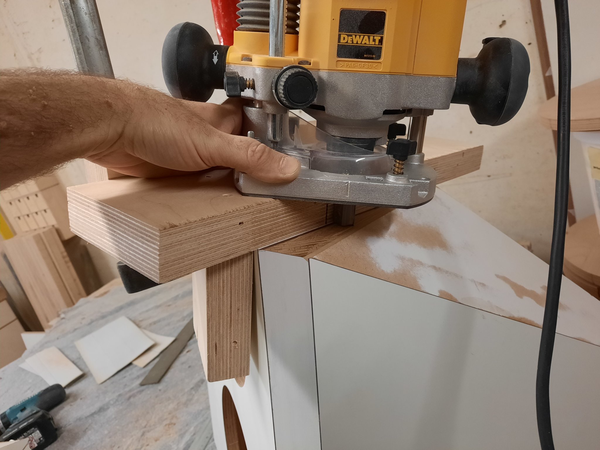

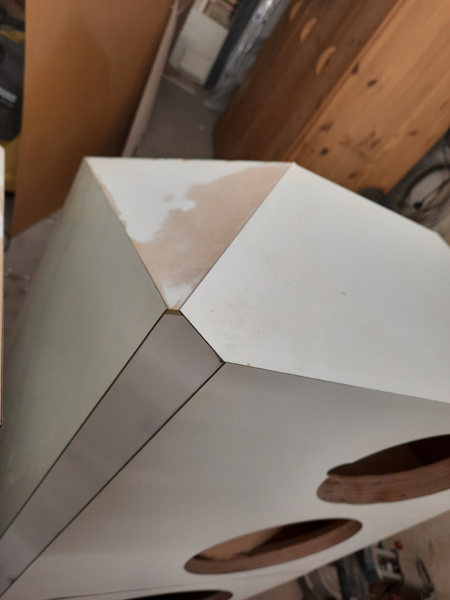

- Building process - The loudspeaker 1
