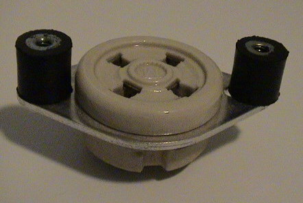

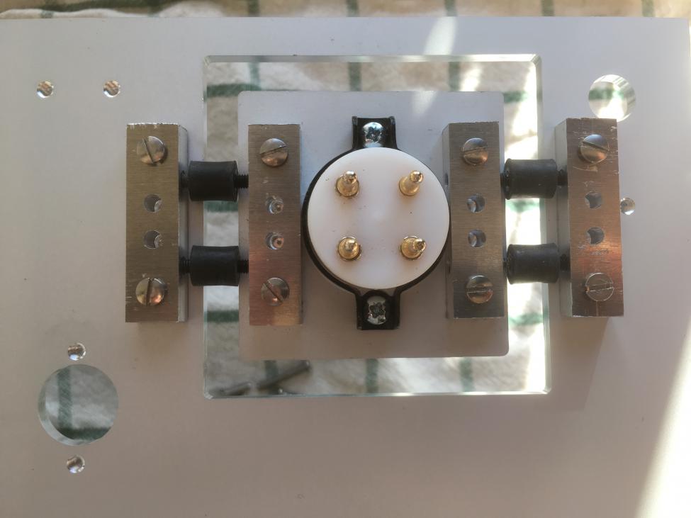

Each old DH tube sensitive to the vibrations, some more, some less ... but all of them requires vibration damping.Somehow my 801a's that I have are sensitive like hell...I had to remove power transformer from the chassis. Kinda soured me to the 801a. Perhaps I should try it again now that I have a bit more experience.
As you can see in my 801 preamp, I always use separated box for PSU/s/ and preamp.
The tube sockets is in the subplate, decoupled from the top with rubber isolators/vibration dampers (they are dimly visible on the black top plate).

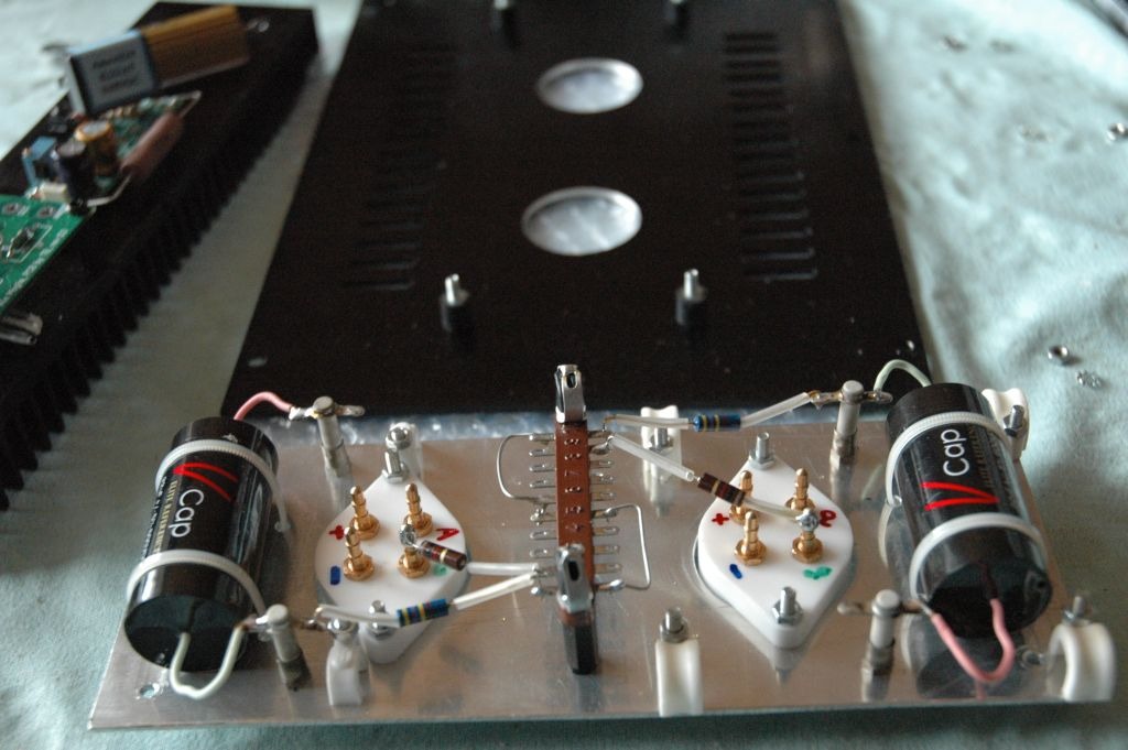

egellings, would be interesting if you could post up yr circuit diagram which was used for this arrangement. im currently working on trying to use dissimilar devices (ie. tube & mosfet) with a push pull output transfo. thank youTo try out an SE design, I have taken a push-pull transformer and placed B+ voltage at the center-tap of its primary. 1/2 of the winding went to the tube's plate, and the other half went to a constant current source set to the same current as the tube draws. That arrangement canceled out the magnetic field in the transformer's core, and since the constant current source has a load impedance in the megohms, it did not load down the tube. This eliminated the capacitor and the choke in the original design. That arrangement also allowed for the use of a smaller, non-gapped transformer.
