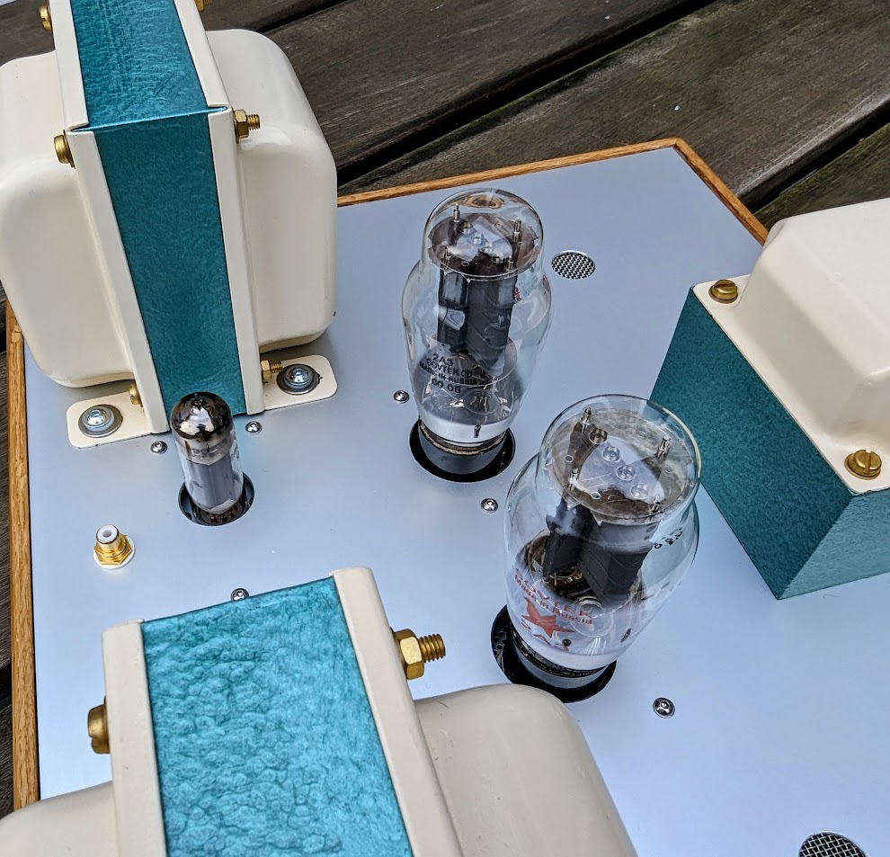

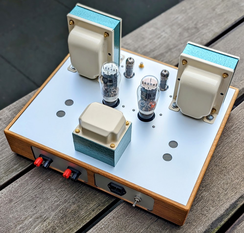

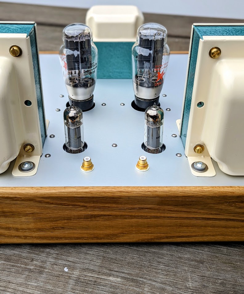

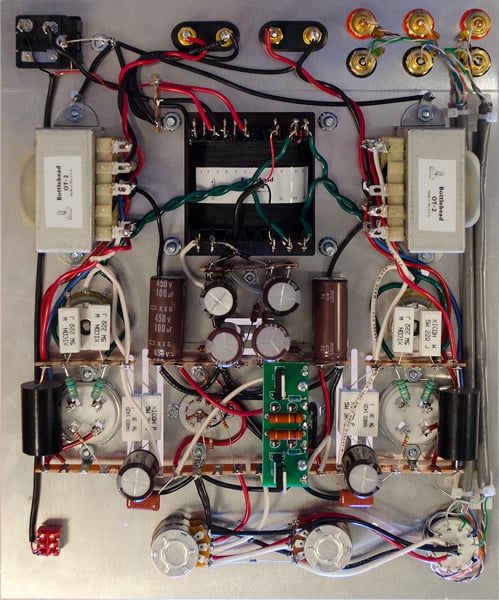

Also a shoutout to Bottlehead. Because of their pictures. I found out I could put my output transformer under my plate choke with the laminates in line. I would never have done that without seeing it. I would have tought it would induce something unwanted. But like I said...quietest amp ever.
No fear of highlighting the OPTs for reduced induction 👍 Might steal. Already a fan of brass end bell hardware.

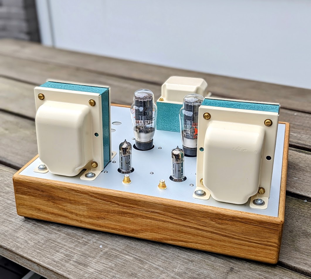

Nice Bas! I am a bit surprised that the plate still looks relatively flat, it has a lot of weight on it. How thick is it? Did you check how hot after a couple of hours playing?
Yes, this amp has a lot going for it: DHT, very good PS throughout (VCCS for cathodes, choke input), DC coupling with low source resistance. Nice indeed!

The weight is all near the sides. 2mm aluminium. No part on the top plate apart from the tubes are over 49 degrees celcius.

Those are actually the plate chokes. The output transformers are right below it. I was afraid if I put them near the psu chokes and filament transformers in the back there would be hum.No fear of highlighting the OPTs
What a good looking and successful project!

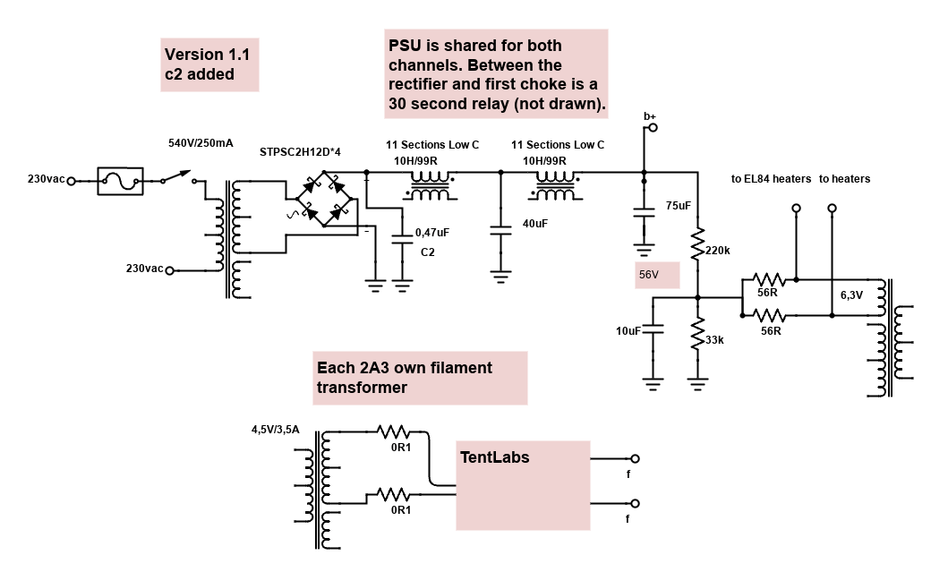

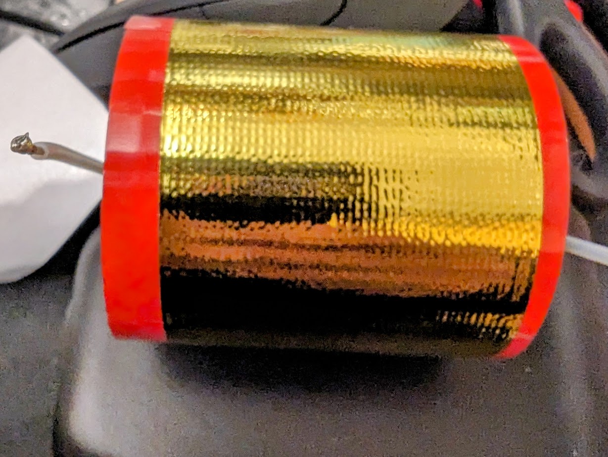

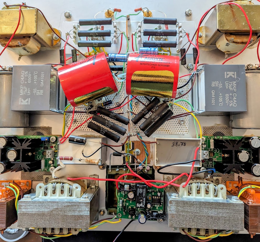

Bas,
https://www.diyaudio.com/community/attachments/pxl_20240215_113334892-mp-edit-jpg.1274470/
Put 10k resistors further away from the Audyn capacitor.
Each resistor dissipates 4W (total 12W), so acts like a heater.
The 25k "pack" also dissipates 9W.
I know, that there is not enough space between 38uF Kemet and (very fat) 82uF Audyn, but if you raise resistors "higher" (closer to the bottom) and try to make its horizontal, the heat distribution will be better.

I have added heat reflecting tape on the Audyns. https://www.heatshieldings.com/nl/dei-reflect-a-gold-38cm-x-91m.html
But now that all is working. I'll see what I can do.
C2 added. Apparently choke input with solid state is pretty rough on L1. I could feel vibration. After c2....very light vibration only.
