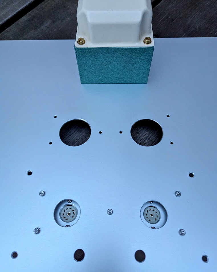

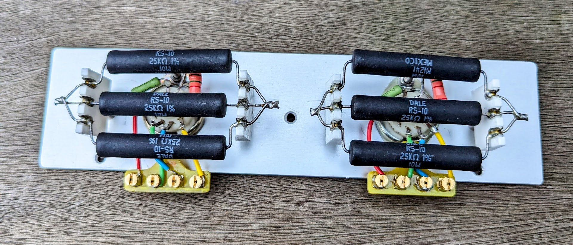

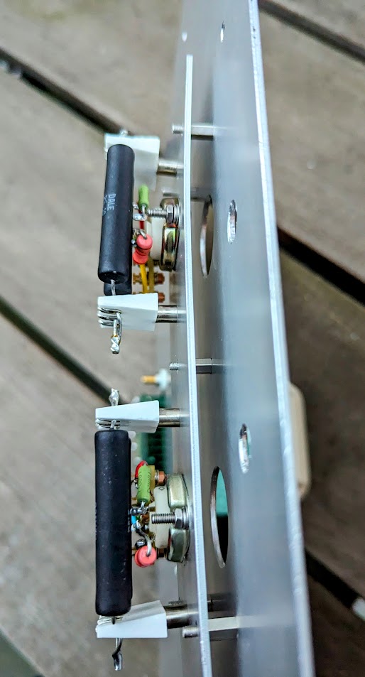

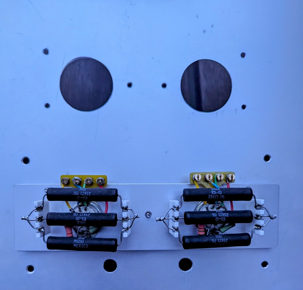

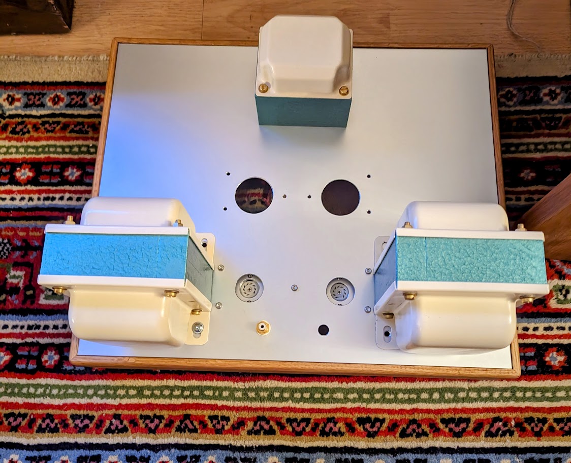

Hi Bas! Are you going to put the EL84 (and2A3) on a sub chassis, as you did with your previous build? Asking as with these power resistors and corresponding heat, you will want some big holes for proper ventilation.
Yes! I am hoping the tube holes will do the trick.... 🤞Hi Bas! Are you going to put the EL84 (and2A3) on a sub chassis, as you did with your previous build? Asking as with these power resistors and corresponding heat, you will want some big holes for proper ventilation.
But there will be more holes. For the filament controller board to name one.
Ok, lets see, and maybe measure. For my amps I made a cabinet with some openings at the top, and thought that "hot air raises" would be enough... One could barely keep one's hand in there, even OPTS were hot (absorbing radiation from the tubes). So I put 4 Noctua in the top plate running at half their nominal voltage, gently pulling air through the amplifiers (they are completely open, you know my building style), and now everything is cool. It surprised me how that hot air didn't move out on its own, even though the top and bottom had openings.
Yes. I've experienced that as well with my EL509 SE. Drilled a hole...did not help...the radiated heat was all absorbed by the aluminium top plate and boy did the top plate get hot....so I know it is deceiving. But I'll cross that bridge when I get there.and thought that "hot air raises" would be enough...
Tell me please more about the 509 SE?Yes. I've experienced that as well with my EL509 SE. Drilled a hole...did not help...the radiated heat was all absorbed by the aluminium top plate and boy did the top plate get hot....so I know it is deceiving. But I'll cross that bridge when I get there.
