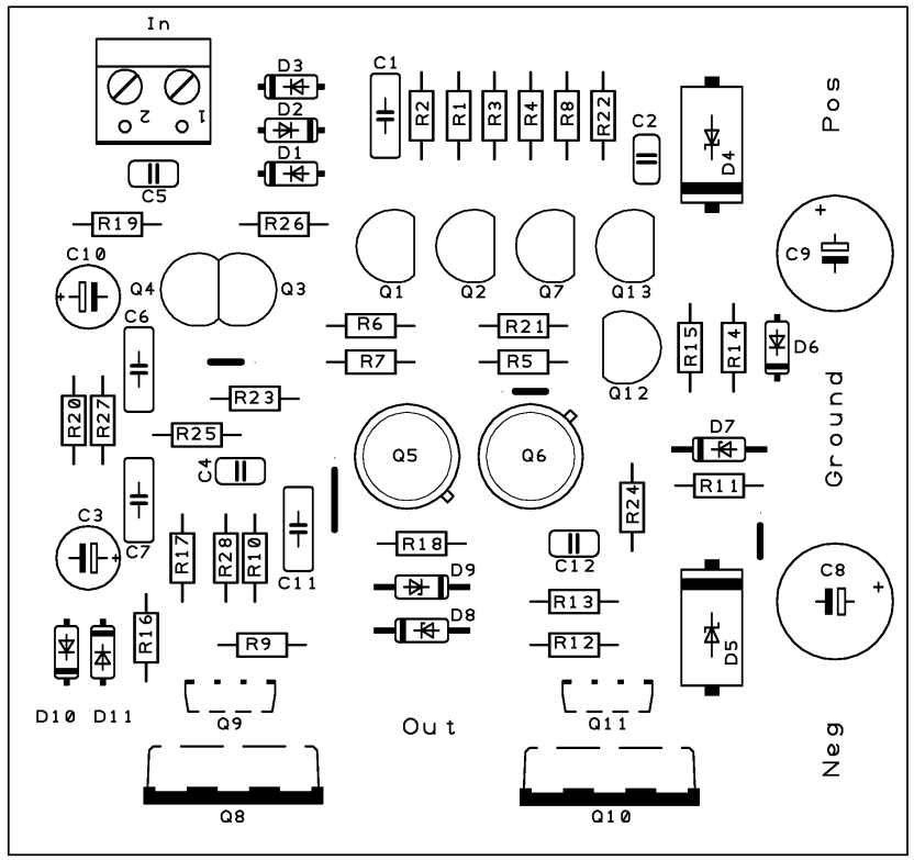

Hello everyone!
I realize now the DX Super A DestroyerX but I found circlophone really interesting and I also realize it.
I have some 2N1711 I think to put Q5 and Q6.
I designed a circuit that apparently has no errors but I do not know if it is well optimized, so if you have suggestions, do not hesitate to tell me.
Regards!

Hello Project16!
I like your layout. I think Circlophone is going to be amp that have most altered PCB revisions. On first sight, placement of D4 looks weird. D4's cathode must go to Q8's collector directly.
2N1711 has only 50V Vce which limits rail voltage usage up to 25V. Cob is 18pF but there are many other good alternatives for Q5 and Q6.
EDIT: I see many other errors in layout. You have to check whole circuit from scratch imho.

You welcome. Hope you check the whole circuit from scratch.

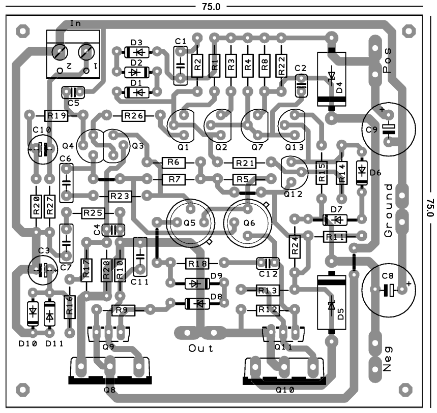

Layout Update
Hello everyone!
I corrected some mistakes that included my drawing pcb and I repost here for your opinion before going to production.
If everything is correct, I'll post the necessary files (. pdf) here for those interested here.

Good thing about Darlington pcb is that it is easily adaptable to mosfet version without altering the layout. According to post #62 it is easily attainable by replacing 120R's with 390R. Darlington version was only exist on simulation but it is real for now. So why not for mosfet/hexfet?
Good idea!...I am thinking of the Latfets they seem to have more reputation than Hexfets when it comes to audio application. 2SK1058? :scratch2:
Lateral/Power fet outputs are very durable! The main limitation is thermal interface size, so if we used the TO-3PBL/TO-264-3 sizes, that could make high power Circlophone a reality. Fascinating!

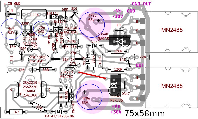

I modified my Darlington PCB layout for a possible higher wattage build.
* All transistors are Japanese type
* Traces are more 45 degree friendly
* Negative feedback cap should sit on plate now
* Input LTP face to faced
* Traces thickened a bit
I actually tried MN2488 (from Ebay) for myself but I'm not sure they were counterfeit or not. I don't remember that I have tested it with o'scope. I just listened and they worked just fine.
Servo transistors are that I listed are not that known type I know. They are not extinct and their specs are fascinating.
Any opinion are welcome.
