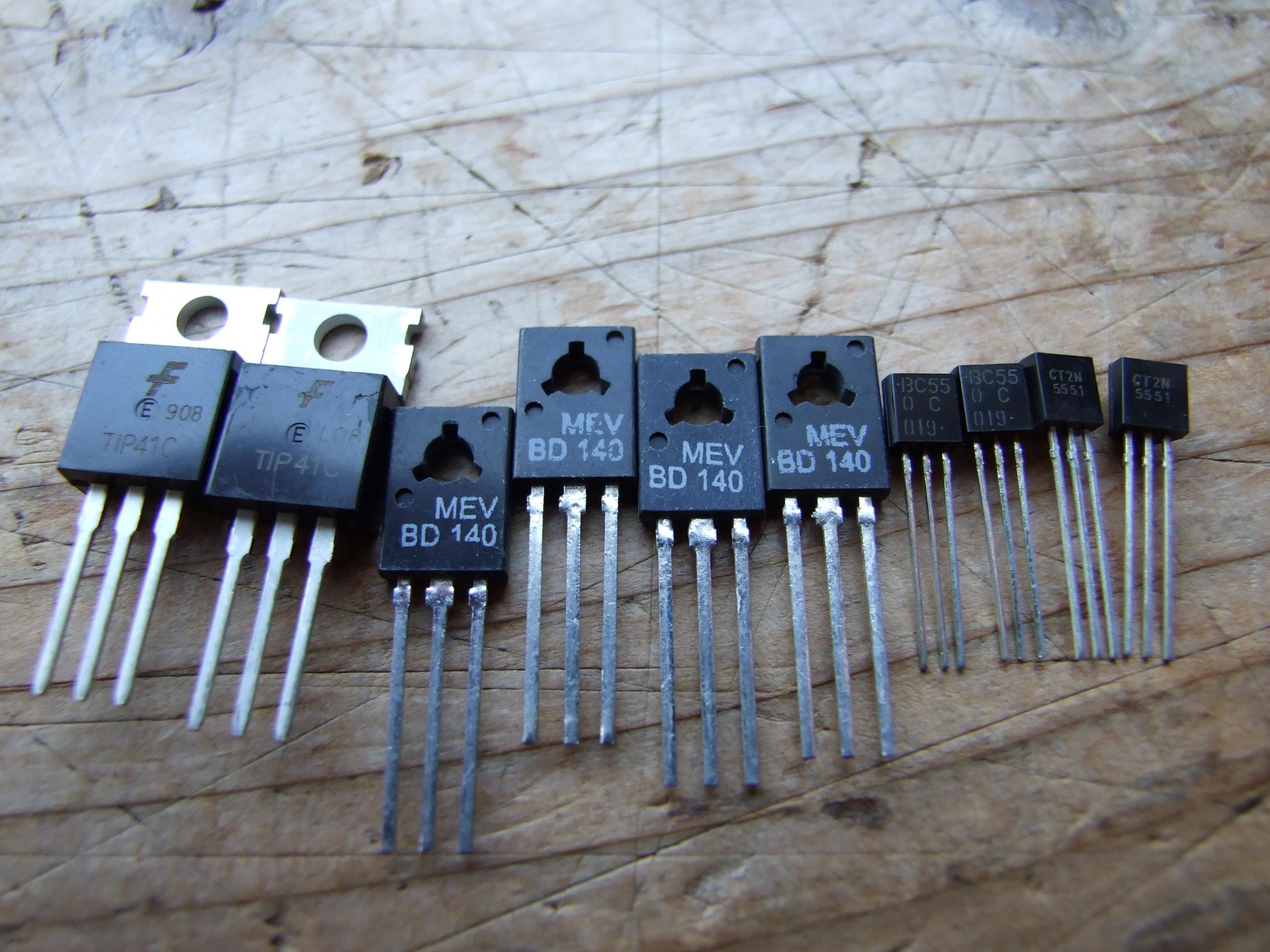

woke up far too late so i wasnt able to find too many open shops,AND this is all i could find.not even a copyer shop was open so i cant even make a pcb
here is what i bought,they seem like originals,dont they?
They all seem to me genuine. If your multimeter is capable of Hfe rank measure, at least you can get an idea about them. Especially with small ones. MEV ones seem 30 years old but this is not a bad thing -if they are healthy-.
Thanks,my multimete has hfe measuring function but it always gives false readings on ohms and voltage but not on current,never tested the hfe but ill test it now and post the resultsThey all seem to me genuine. If your multimeter is capable of Hfe rank measure, at least you can get an idea about them. Especially with small ones. MEV ones seem 30 years old but this is not a bad thing -if they are healthy-.
it gives a reading but dont know how good it is, 2n5551 score is 29 and 49
bc550c score is 204 and 217

No way ~200 hfe for a BC550C. Even my BC546 ones have ~350 Hfe. BC550C's must have minimum 420 Hfe according to Philips/NXP datasheet. If you are sure about your multimeter, I suggest to find another good one. You can distinguish Philips/NXP ones with their silver color.
Same for 2n5551's.. Mine ones give ~150-200 rating. It seems you are in bad luck with these ones.

im pretty sure its the multimeter,my dad promised me he will buy another one for me,i need to find a good one for less that 35 $,No way ~200 hfe for a BC550C. Even my BC546 ones have ~350 Hfe. BC550C's must have minimum 420 Hfe according to Philips/NXP datasheet. If you are sure about your multimeter, I suggest to find another good one. You can distinguish Philips/NXP ones with their silver color.

I meant, If you are sure about that your MM is not faulty, then these transistors are problematic. I suggest you to find another transistors for compare. I didn't suggest you to find another MM. Hope there is no misunderstood.
okI meant, If you are sure about that your MM is not faulty, then these transistors are problematic. I suggest you to find another transistors for compare. I didn't suggest you to find another MM. Hope there is no misunderstood.
