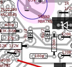

I modified my Darlington PCB layout for a possible higher wattage build.
* All transistors are Japanese type
Any opinion are welcome.

I'm thinking about altering final layouts :
* BC/2N type small transistors (zener and zenerless)
* Japanese small transistors (zener and zenerless)
Total 4 different layouts. Each layout can be used by inverting polarity and device type at each side, thus 8 different implementation according to builder preference. If we count mosfet and darlington output versions separately, then 16 different implementations in total.
For Japanese + zener option, my previously posted layout seems finalized, should be applicable at least. I will send you pcb print file for it.
I just figured it out we can use a single layout for zener or zenerless builds if transistor is going to be base-to-ground. I'm working on layout.
Hero!I just figured it out we can use a single layout for zener or zenerless builds if transistor is going to be base-to-ground. I'm working on layout.

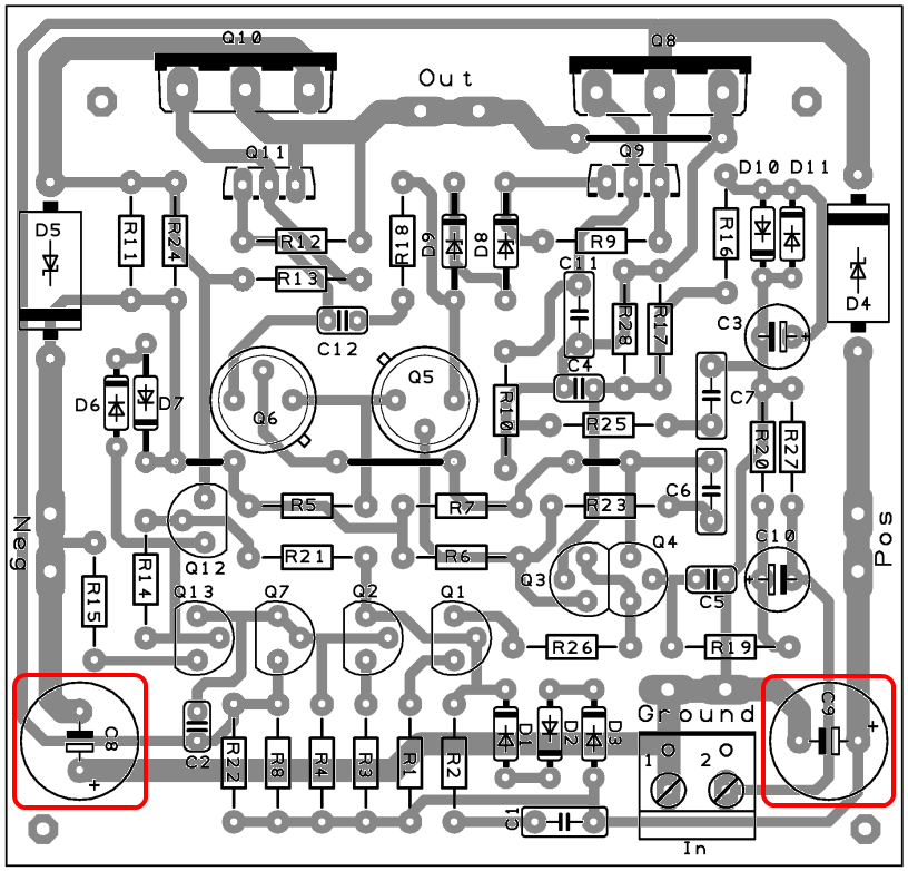

Hi everyone!
I still change my circuit design but I have a little doubt tracks two tracks that pass between the two capacitors, any suggestion is welcome.
For Schottky diodes (D4 and D5) I have SB560 (60v - 5A).
http://www.vishay.com/docs/88721/88721.pdf
It is ok?

Hi everyone!
Did you check the whole circuit? R22 seems an extra resistor that doesn't exist on original circuit.
I added R22 to possibly get two 2ohms 1/4w resistors (R8 => 1ohms - 1/2w) but I will certainly remove it to remain in the original scheme.
Regards!
Layout updates
Changes :
* It is now Transistor/Zener option on same layout
* Some resistors laid down at input stage
* R21 pads thickened due to possible two pin CCS small module card insertion
Note: 25-50V per rail voltage range is a theoretical estimation.
Changes :

In this board minimum Vce spec'ed part is at 120V. So, I didn't bother to show 50V there. It is going to be the same as mosfet version - except 120R's and output stage of course.
I haven't arranged a BC/2N version of PCB yet. In this case, supply margin will be limited by BC5X0C's at max 38-40V.
I don't want to limit the builders. I just want to prepare a template for different possibilities and requirements. BC/2N version should be applicable for mosfet version too. Hope you get my idea.
I arranged 180pf/270R comp network for transistor version and I didn't altered for zener version as shown in original schematic. Simulation doesn't show any difference with this setup. Should I re-arrange the comp. for zeners (270R to the other side of zeners) as shown in original schematic? It is very easy. Elvee?
It is completely equivalent: the zeners dynamic resistance when they conduct connects the two nodes in ACI arranged 180pf/270R comp network for transistor version and I didn't altered for zener version as shown in original schematic. Simulation doesn't show any difference with this setup. Should I re-arrange the comp. for zeners (270R to the other side of zeners) as shown in original schematic? It is very easy. Elvee?
