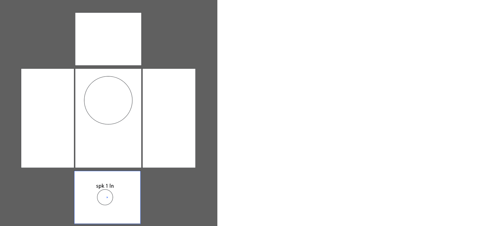

To summarise, Richard says 3.5 litres for the ported enclosure and 1.0 litre for the closed box.
Weems says "An optimum volume ported box will always be somewhat larger than the closed box for the same woofer".
Weems gives figures for one particular woofer that show the closed volume to be approximately one third of the ported volume
That would imply a closed box volume in the OP's case of 1.2 litre - in line with Richard's 1.0 litre.
So, if you want to keep it simple @rlogjk, I would plan for a 1.0 to 1.2 litre closed box and hope for the best!

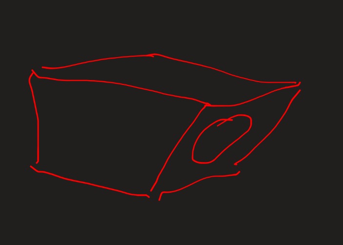

This arrangement protects from dust in the long run, tooI saw an installation that had speaker boxes on the floor and they angled the speakers down at 45 degs. Imagine a rectangle but with a 45 deg cut at one end and then put the box down on its smallest face. The advantage is also that it gives good protection. Happy holidays.
Terrible scribble, and the floor was very reflective.

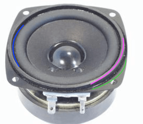

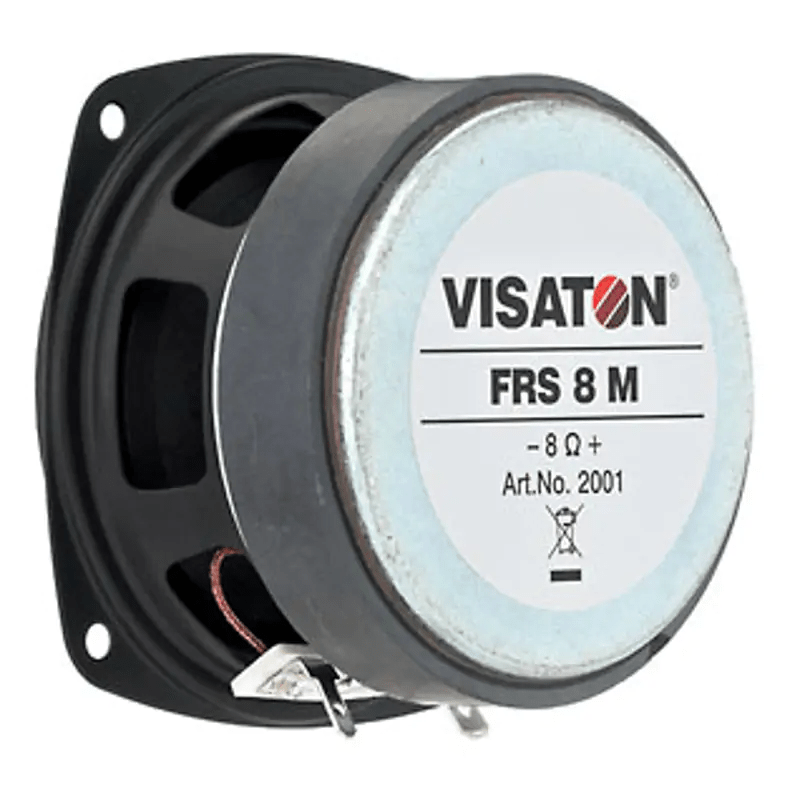

The gasket ring (the outer narrow ring that stands out proud from the frame of the driver) has an outside diameter of 75 mm.
A silicone adhesive is applied to the outside of the gasket ring and to the frame of the driver (the part with the four screw holes in it).
The driver is then inserted into the 75 mm cut-out in the box from behind. The silicone adhesive will both glue the driver in place and seal any gaps between the gasket and the cut-out. Lay the box with the speaker facing down overnight until the adhesive is fully cured.

Correct me if I wrong but what I understood from the comments here is that the only way to mount this driver is from the back. it won't be possible to insert the driver from the outside of the box through the mounting hole right?Fully agree, but I was suggesting an even simpler solution: placing cabinet facing up and mounting speaker from the front, to avoid needing a removable back.
In that case I could just use 5M screw to mount the driver through the mounting holes (?)I am suggesting you insert it from the front.

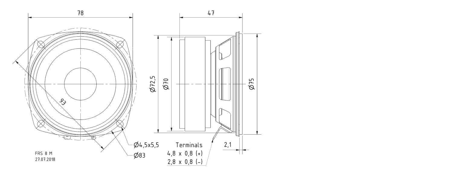

The design of the driver doesn't lend itself to front mounting. Note the "lip" which is visible in this image that prevents flush mounting.
I am in agreement with your statement.
Addressing both doubts 🙂
I suggest:
1) cutting a 72.5 mm hole on baffle front.
2) if you put it face up on a table and place speaker there, it will NOT fall through the hole (look at speaker dimensions) but stay there, held by narrow edge all around.
Round part of speaker frame is 78mm diameter.
3) once you checked it fits, pull it, place an even silicone bead/ring around, then replace on baffle.
Thick and elastic (once cured) silicone will both glue it there and seal it.
4) mounting "ears" will NOT sit flush with baffle front but a couple mm away ... who cares?
5) no screws needed.
In any case I would not trust them much when screwed to 3 mm thin plywood/MDF
6) please check 70 mm magnet does indeed fit through 72.5 mm hole

I'm sorry to ask again but I'm not sure I got it 100%.A silicone adhesive is applied to the outside of the gasket ring and to the frame of the driver (the part with the four screw holes in it).
The silicone should be on the blue ring? the pink or the green?
