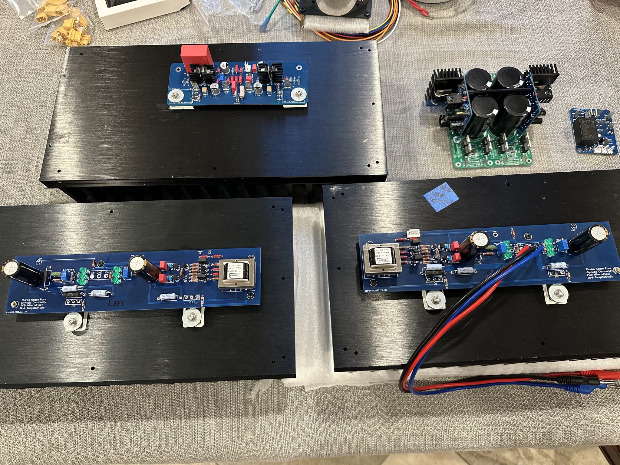

Made some progress on Bliss this relaxing first day of the new year.

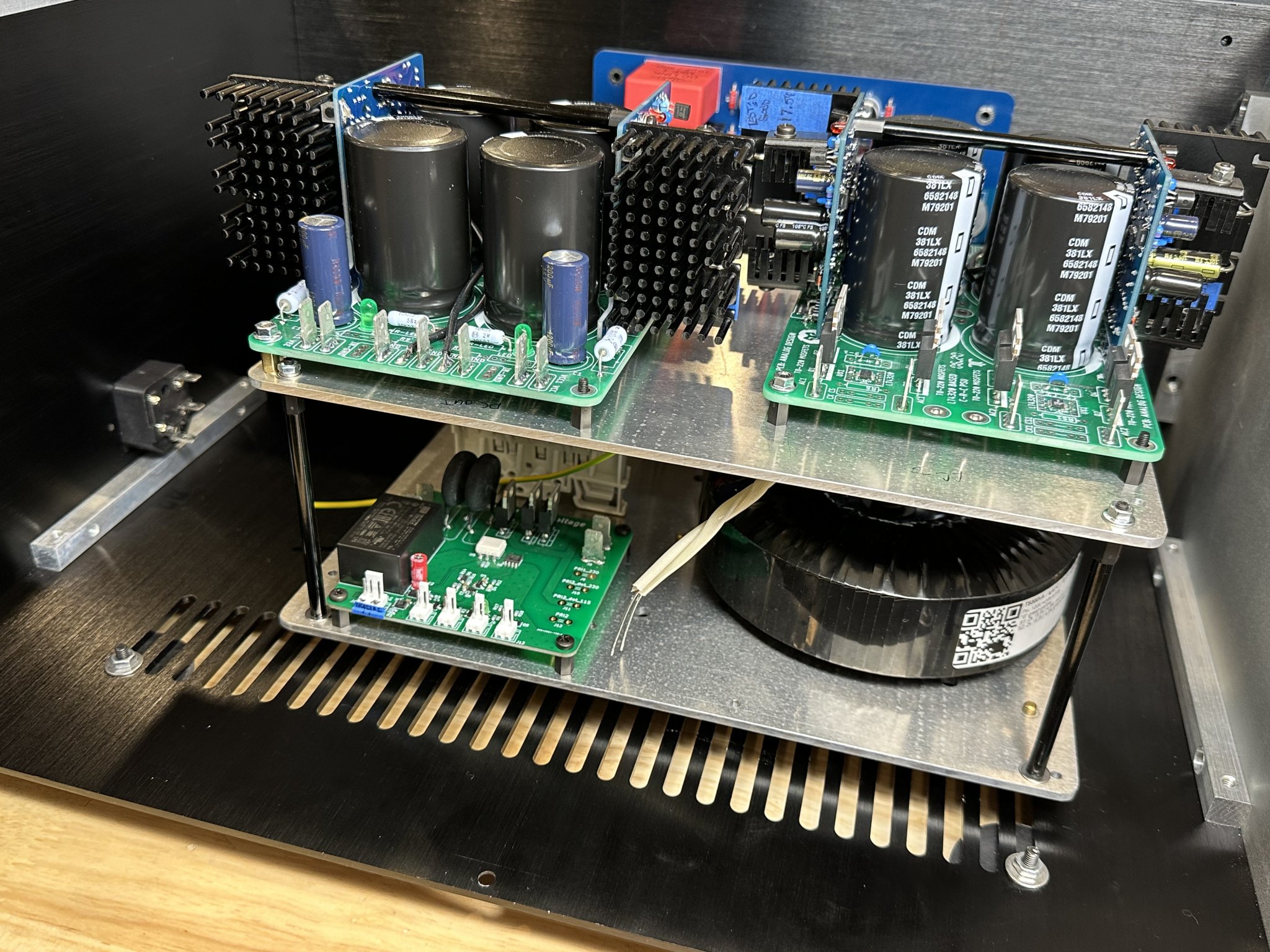

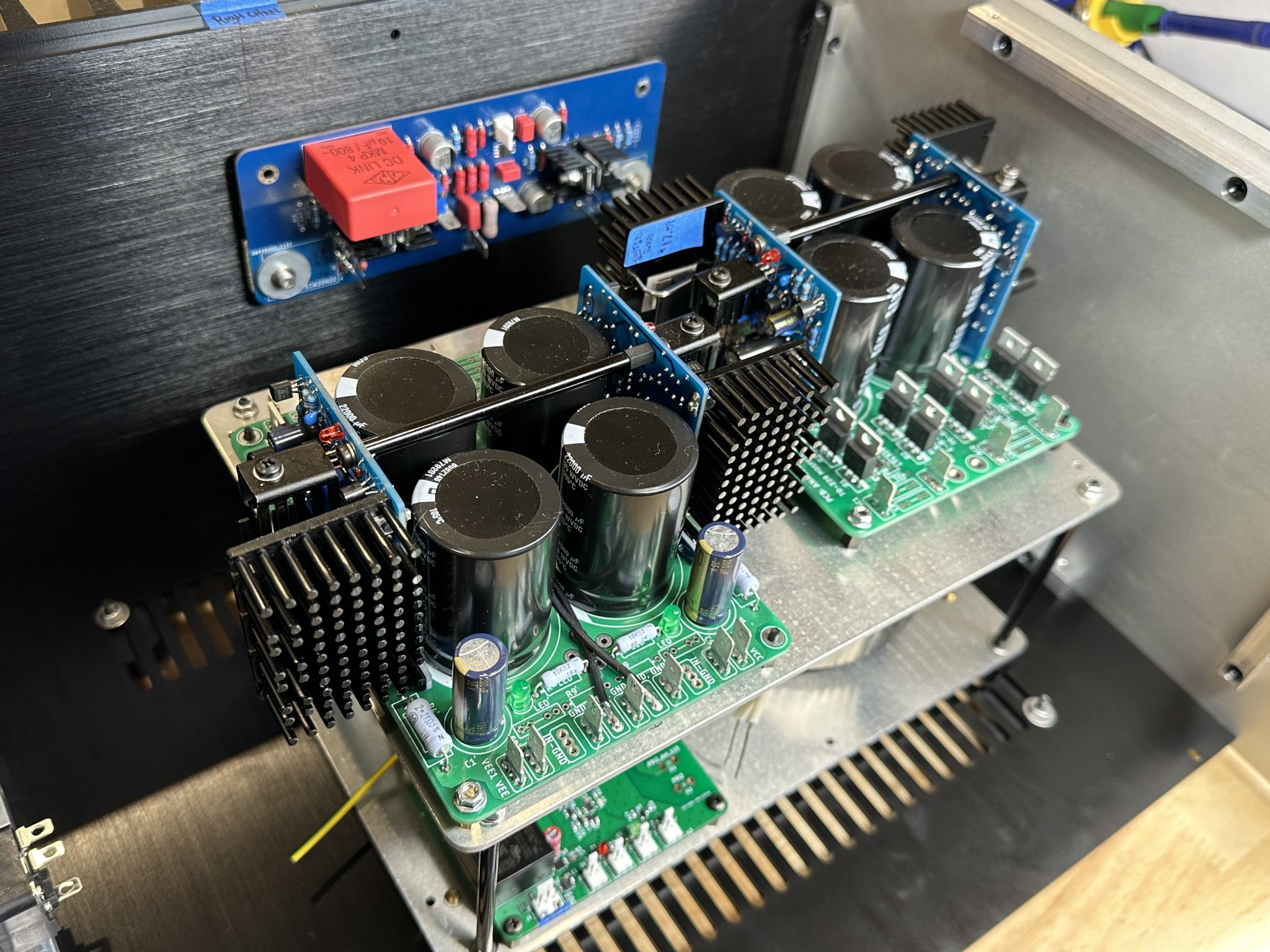

Worked on the PSU mechanicals and fitment today. She’s a double decker!

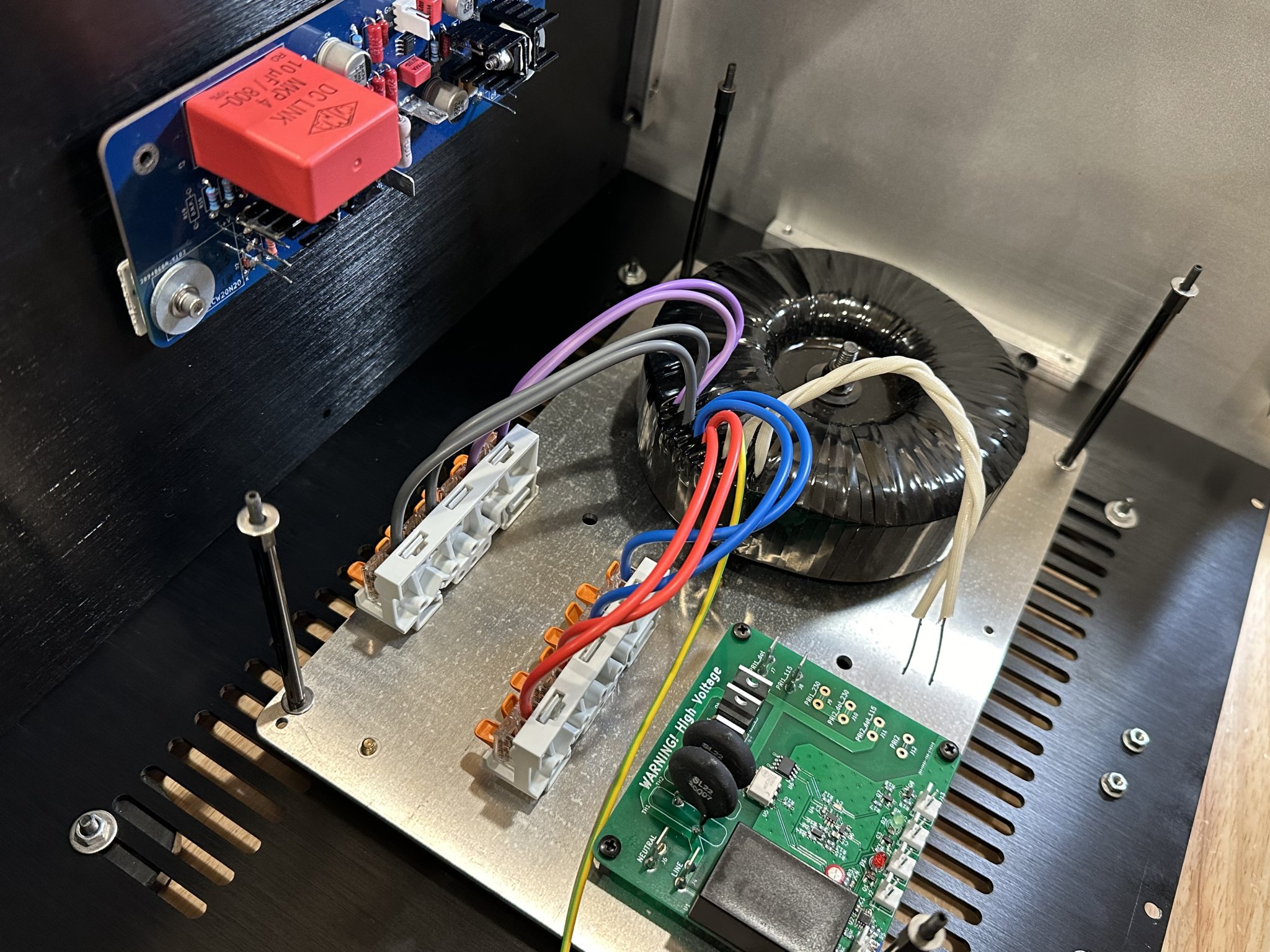

I like to use WAGO connectors in order to made changes/modification easier.
Rear panel layout and machining is next up….
What are 'WAGO' connectors, V?

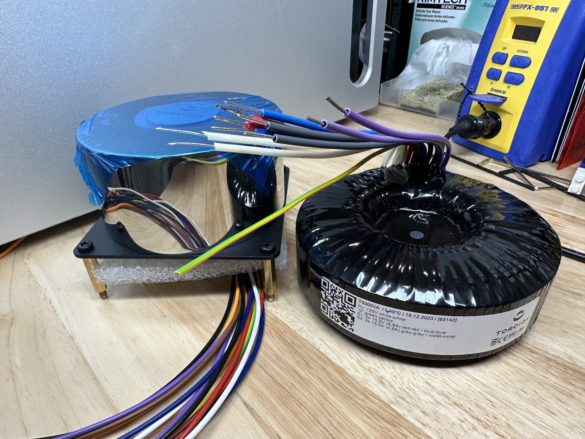

The plan for this chassis is to share time between two amplifiers. (F6 Diamond and Bliss)
Swapping heatsinks and power transformer then adjusting R21 modules for proper output voltage is all that's needed to pull this off. The WAGO 221 connectors will make swapping the Toroidy's super easy and convenient.
