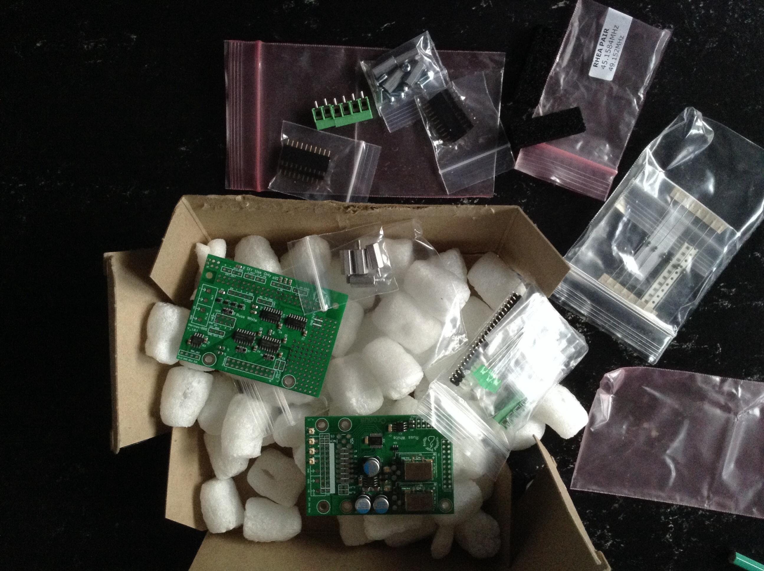

I have been following this thread from the beginning, more than one year ago. And look what the mail brought today:
Thank you Russ, Miero and everyone that has contributed in the development of this nice little gem! :grouphug:
I can't wait untill it's saturday and I have time to build it up.
