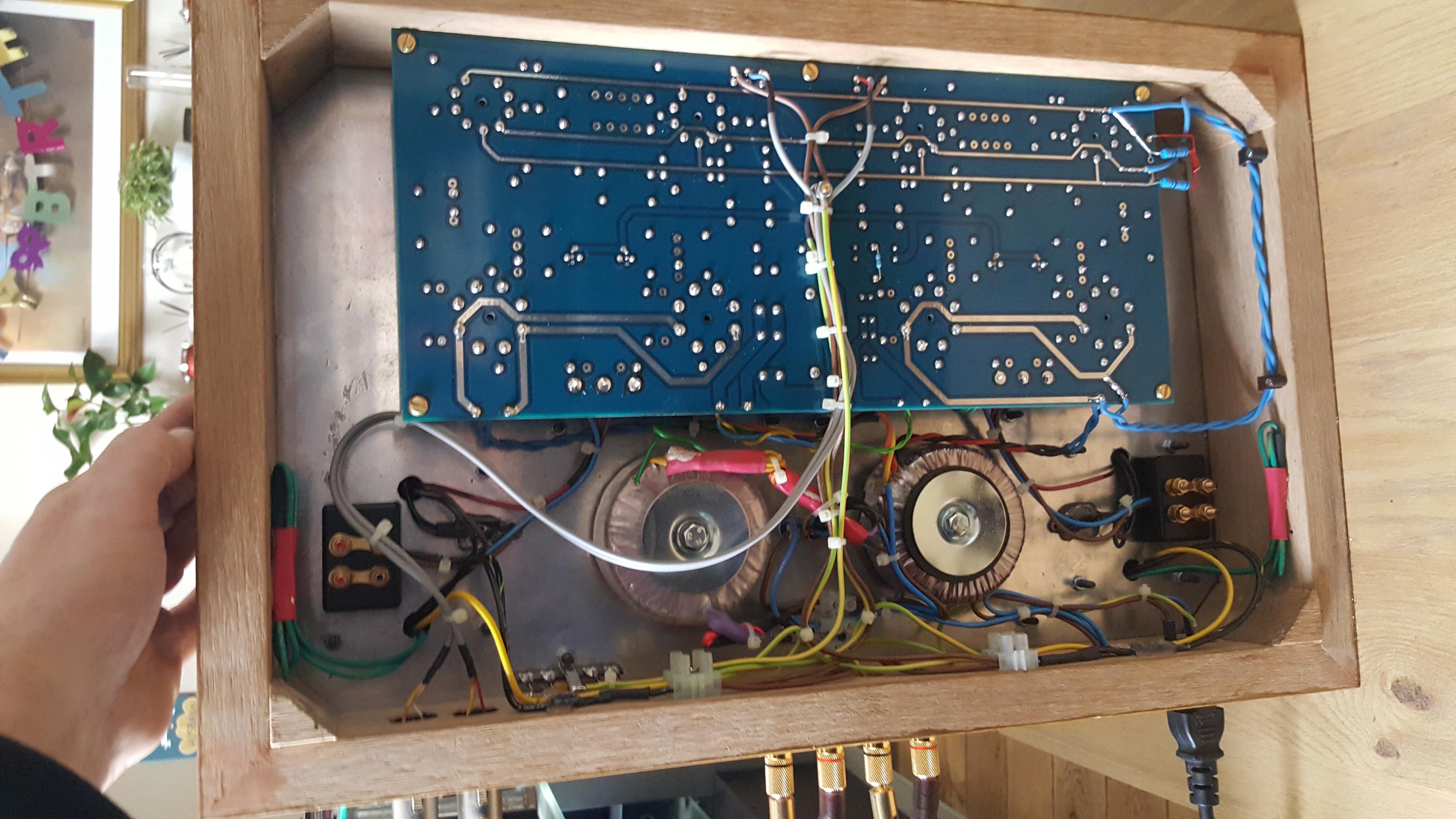

Finally, it is working, just a few minor issues to sort out.
I did get a refund for the blown EL34s from the board supplier.
Just to re-iterate the PSU requirements for this amp and how I implemented them.
B+ is derived from 320VAC at approx 400mA.
I used two 160VA transformers with their secondaries in series.
0-120V + 0-120V + 0-35V + 0-35V. Under 400mA load these toroids provide 320V.
The heater supplies are 6.3V at 6.5A.
This is a single 50VA toroid with 0-6VAC at 8.5A.
Surprisingly this gives almost exactly 6.3VAC under load.
The cathode bias is derived from 70VAC.
This is a single 50VA toroid 35-0-35V.
This results in about 105VDC but this is OK as discussed previously.
The two B+ toroids are on top of the chassis under the top hat covers.
The other two toroids share the same bolts and are mounted each under one of the B+ toroids.
All these transformers are currently available voltages which gets around having to try to source a rare specialised valve transformer.
As Far As I Know, this is probably the easiest kit to source parts for.
The Hammond 1650H OPTs are available from Digikey.
The EL34s and 12AU7s are commonly available.
Just be aware of the issues as discussed with the bias adjustment.
As supplied the PCB allows for the bias to be adjusted into EL34 killing country.

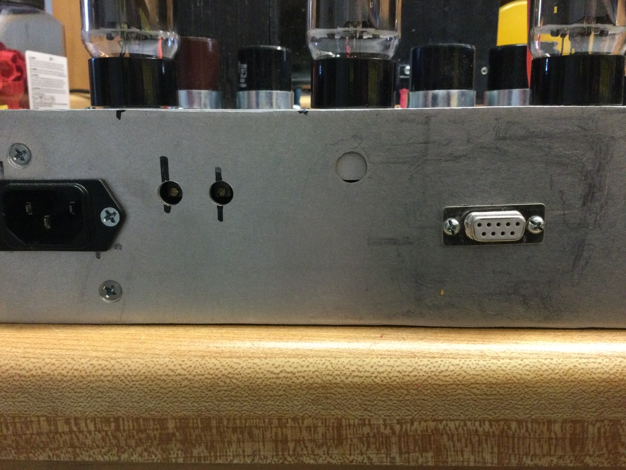

DO USE series 100mA meters when adjusting the bias. I tried measuring across the cathode resistors and, through poor contact, managed to destroy 2 x EL34s.
If I were to build this project again I would recommend two differences.

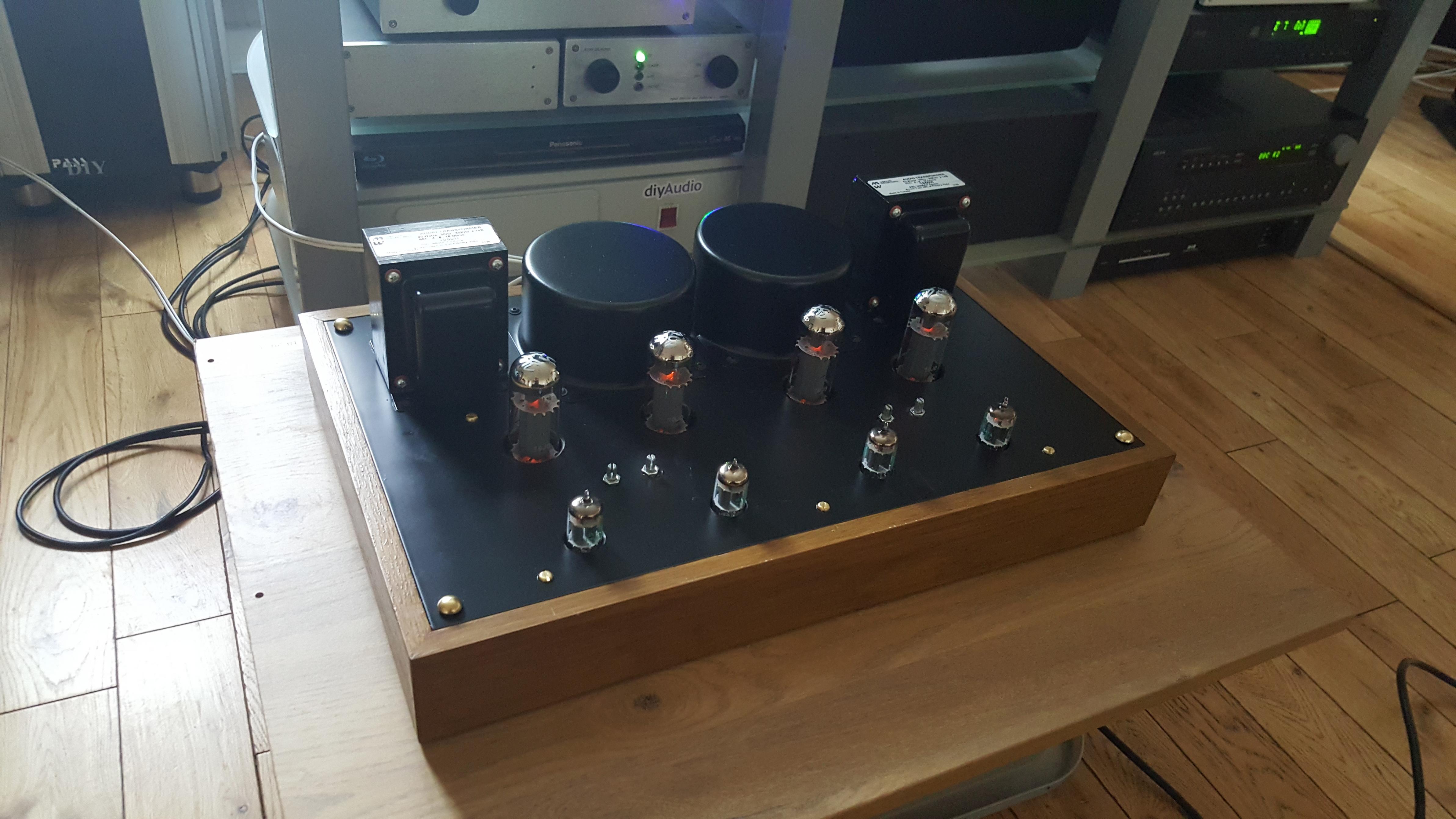

1. I've not found a paint finish that is hard enough to prevent any damage for the upper chassis. This is Smooth Hammerite and it is still very soft and easily damaged. In a second iteration I would consider anodising the finished chassis.
2. The chassis is very heavy. I've only got four fixing points into the Oak frame. It really needs more.
What is really needed to monitor voltage on cathode resistors is a connector on the PCB or chassis. Pig tail plugs in the D connector, universal pin out for all amps I build. Other end goes to gator clips. Some fancy amps use one meter built in and a selector switch. Relying on probe tips is a bad idea in general, as you’ve found out.
Even Duartex comes right off of metal. The only other durable finish other than anodizing would be powder coat. Either way is more expensive than spray paint.
Certainly you could save weight with the transformers. The cathode bias only needs a few miniamps. Having HT and heater separate can be good. Toroidy can make you a transformer to your spec. I don't know if the board can do UL. I try and buy the metal already black. I don't think powder coating is that difficult.
