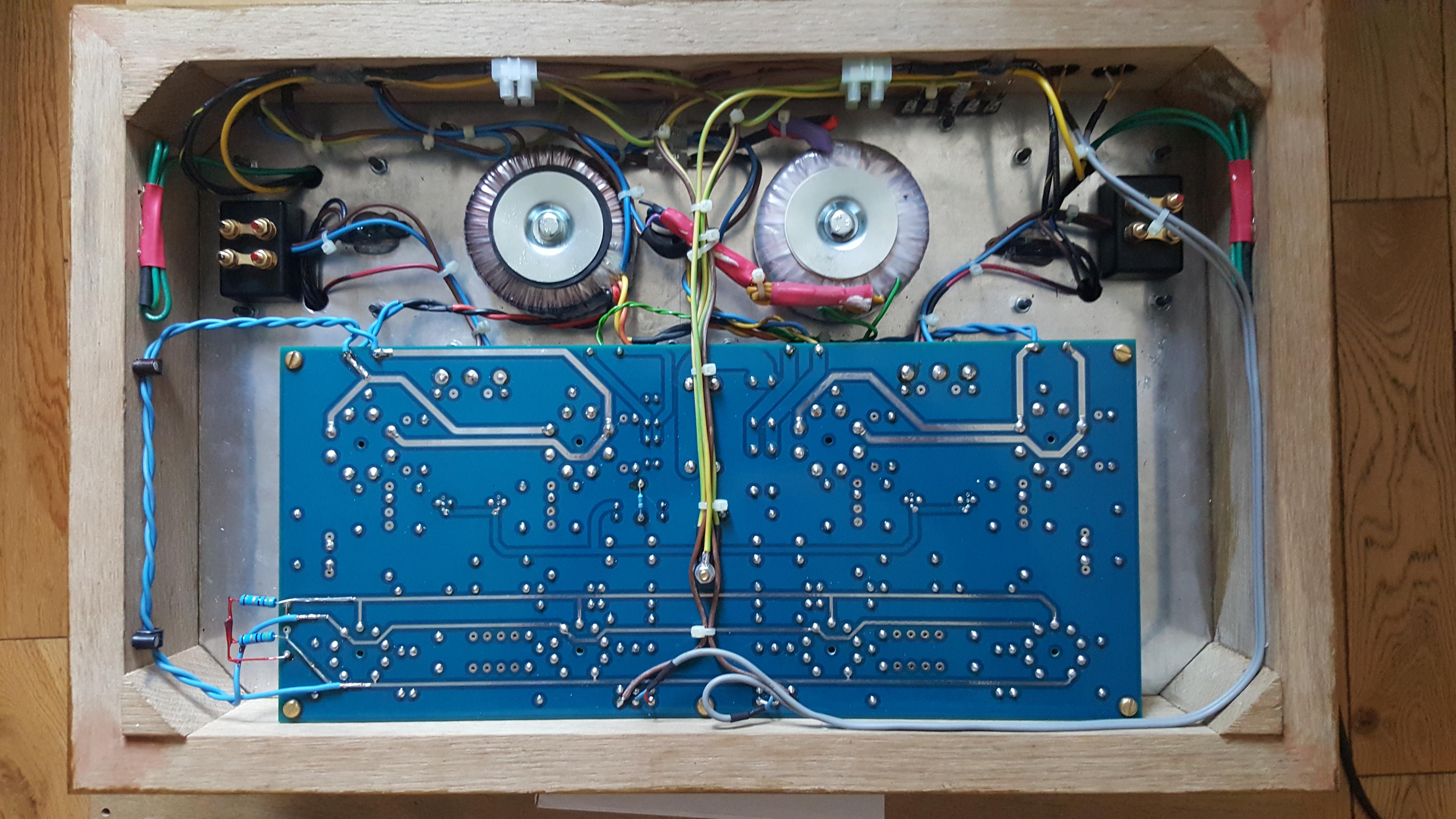

Try moving the input screened cables away from the toroid. Please to see they run together to prevent a differential loop.
A few ways to include/exclude your hum/noise. For example,
- battery power the heaters.
- temporary short across the pcb signal input terminals
- pull out V2
- do all of the above with and without GNFB connected
- measure what your GNFB level in dB is (ie. if you are only applying 6dB feedback, then increasing that to 12dB may drop your hum by 6dB - but you then should preferably measure your stability margins)
- how well did you balance the EL34 cathode currents? (and btw how do you access the bias trimpots?)
- what are the dc circuit voltages at idle (eg. mark up the schematic)?
But you should aim to use a meter or hum level benchmark measuring of some sort to determine the change. The better method imho is to prepare soundcard/laptop/spectrum analyser type measurement tool, so the hum frequencies and their magnitudes can be identified.
Are the brown wires going to the pcb (near the input signal wires) the output wires used for feedback? As they have a relatively high signal level on them, it may be preferable to distance them as much as possible from the input signal wiring, and to separately shield them on their way back to the pcb (to avoid cross-channel coupling and stray pickup). Is each output grounded separately at the pcb common gnd point? It may be better to ground each speaker output directly to the ground end of their respective R2, although that may depend on pcb layout as the speaker ground would carry parasitic capacitance current from the output stage main signal loop.
What are the two power transformers specifically for? Do they have a large steel washer between the core and (aluminium ?) chassis ?

TROBBINS, the bias pots are remote and on top of the chassis so easy to reach.
The bias is 40mA / valve as close to zero tolerance as I can see on the meters.
The green loops at top left and right are the unused taps from the OPTs.
The black boxes are the breakout boxes for connecting the mA meters for bias adjustment.
You can clearly see the central 0V point on the PCB. The only connections are the 0V returns from the OPTs and the GND lift to Earth.

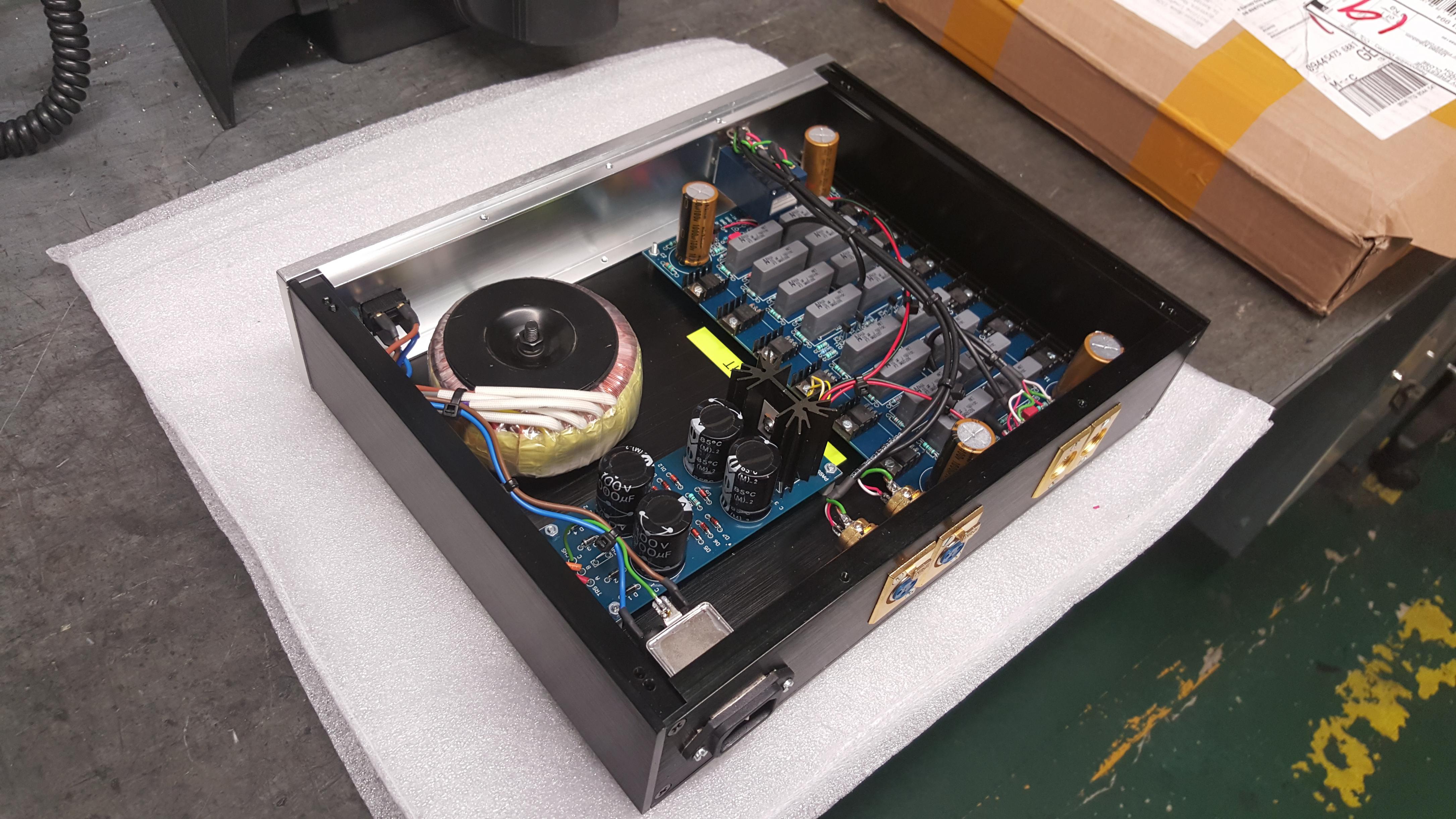

I do tend to favour the transformer approach, I've just ordered a pair of 10K:10K transformers.
WG_SKI.
The only reason that I went down the "balanced" route is because I built the Aleph 4 and the Aleph J which both are balanced designs.
The Aleph 4 really benefits from having a balanced input, if only to achieve its stated output.
Hence the pre-amp is a balanced Aleph P1.7.
I had to build a John Gilmore Unbalanced to Balanced convertor to take my unbalanced sources and convert them into balanced inputs for the P1.7.
While I am waiting for the two 10K:10K transformers to arrive I might just try building a simple passive attenuator and see what happens if everything is unbalanced.

I can now confirm that the Aleph P1.7 does not have ground lift. The 0V is connected to mains earth.
This is not an issue with my other power amps, the Aleph 4 and the Aleph J.
