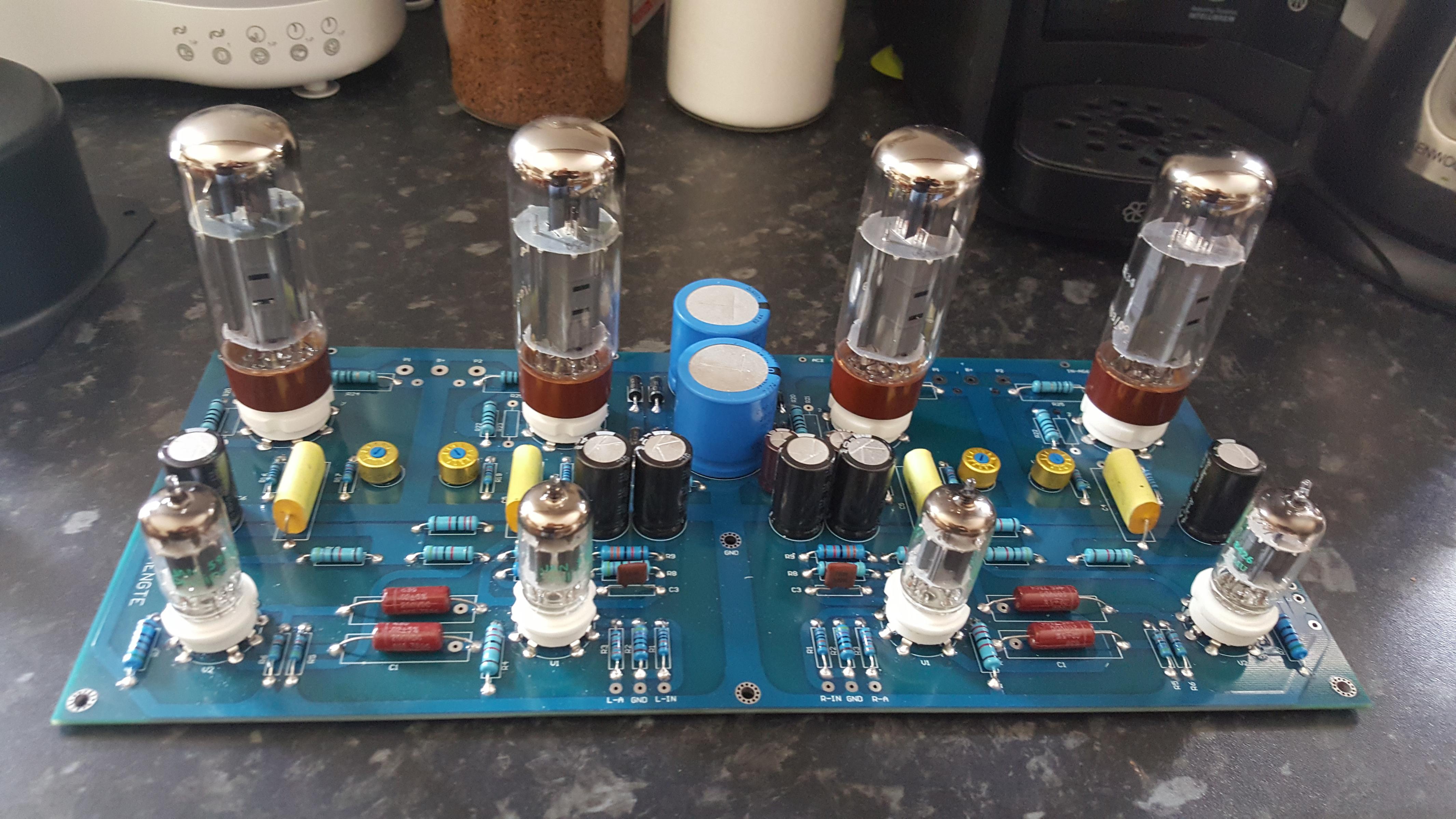

Has anyone ever seen "valve base extenders" ?
In my application the tube sockets are mounted on the top of the PCB. The capacitors then necessitate the use of 40mm spacers so that the PCB can be mounted under the chassis.
That's OK for the EL34s, enough of them poke through to make them visible.
The 12AU7's - I only get to see half the tube envelope.

Mount the caps on the underside of the PCB and use smaller spacers? That's what I've always done.
Great idea! I put the valve sockets on the other side before but of course that requires a mirror layout of the valve.
As the PCB is pre-assembled and double sided I didn't really want to remount the caps.

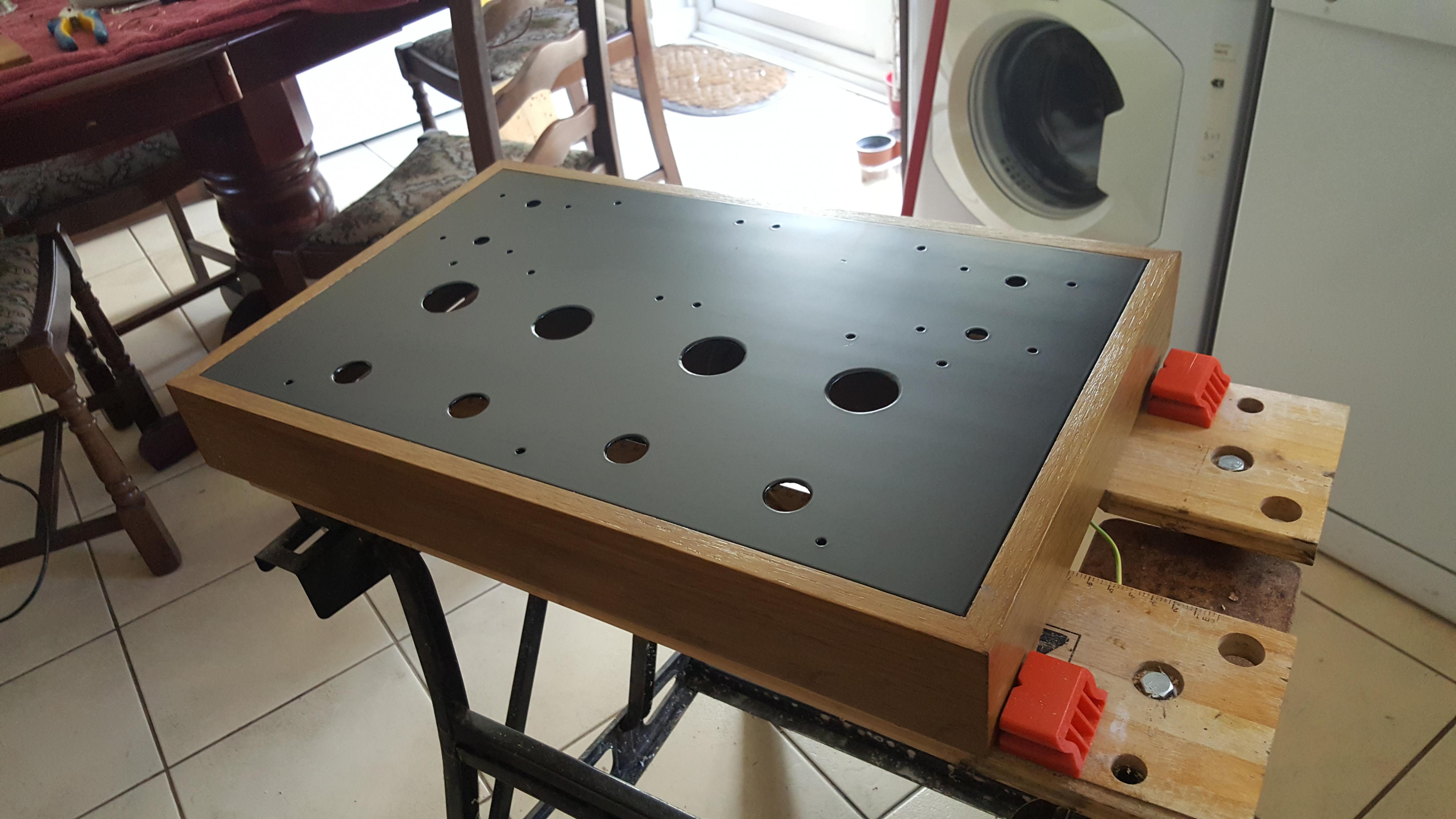

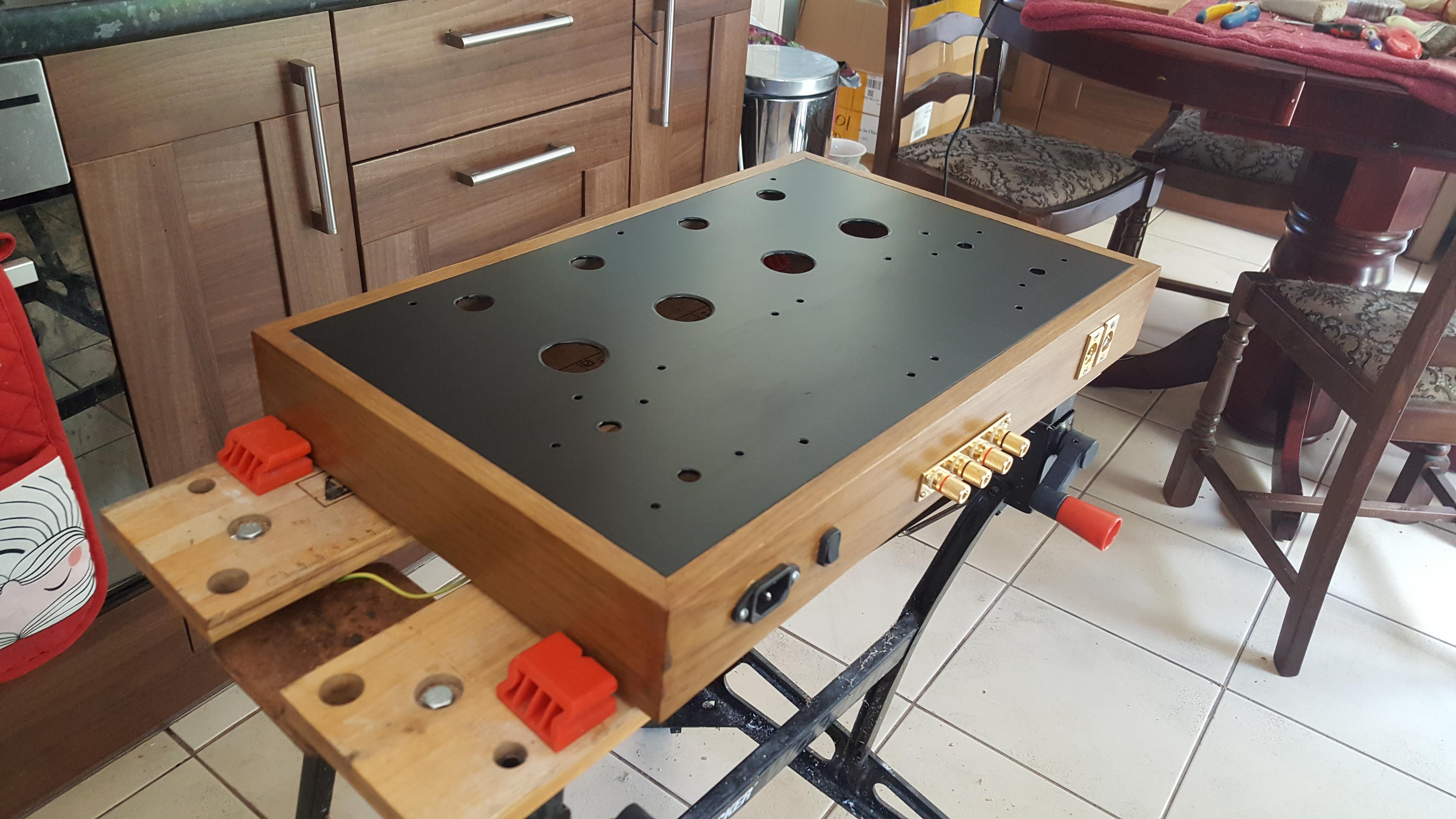

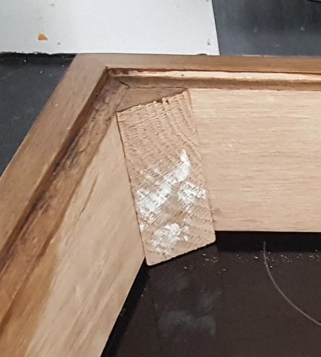

I'm pleased with how the chassis is turning out.
There is a slight stain from the wood filler on the rear of the woodwork that I didn't notice until the varnish dried, never mind, it is out of sight.

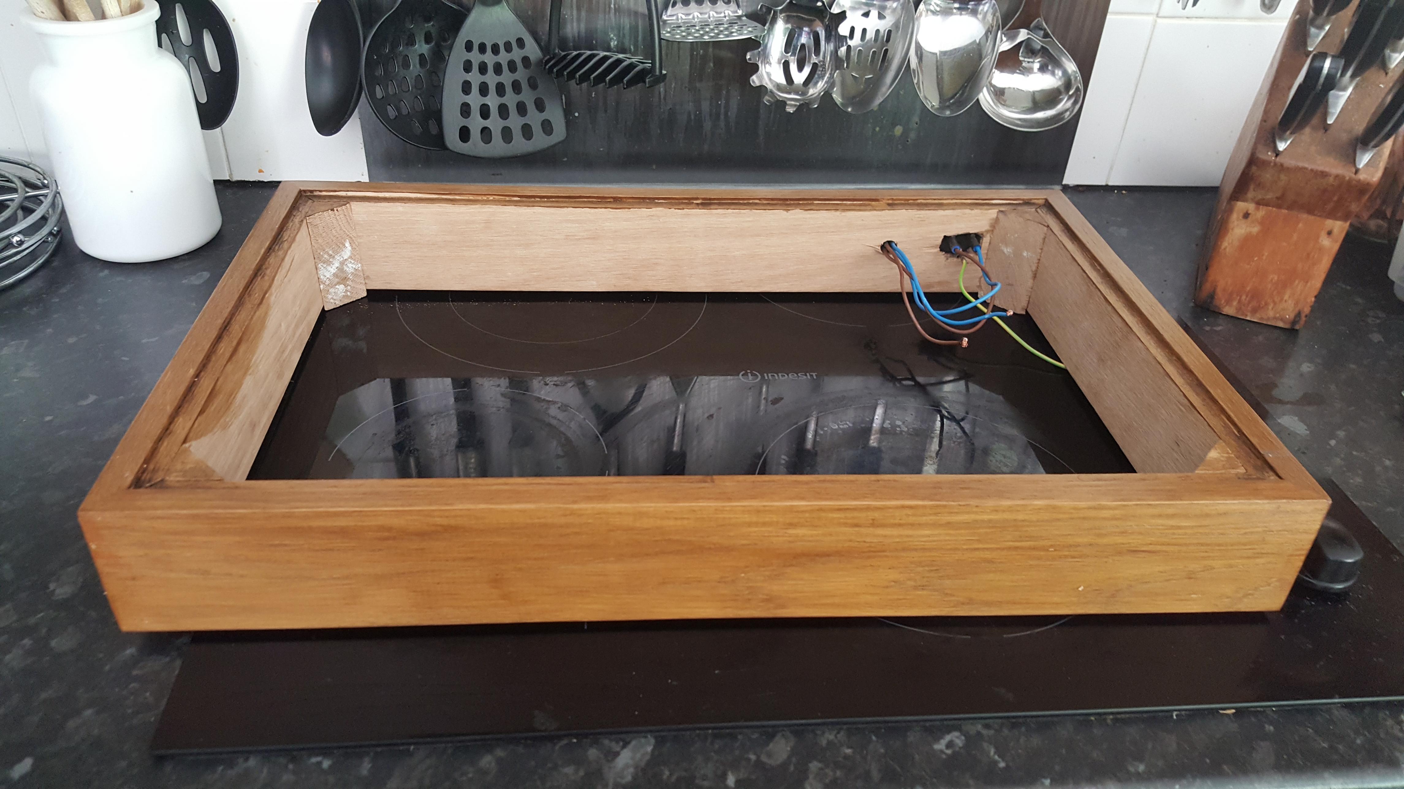

A bit of advice needed from more experienced carpenters
At the moment the metal chassis is just a tight fit in the woodwork.
If I was foolhardy enough to pick up the amplifier upside down, the weight of the transformers would easily pull the metal work out.
The woodwork is genuine Oak.
Where would you put the screws to hold the two together ?
I've got 4 x nice brass topped screws.
I was thinking about the corners but the wood is not at its' strongest there.

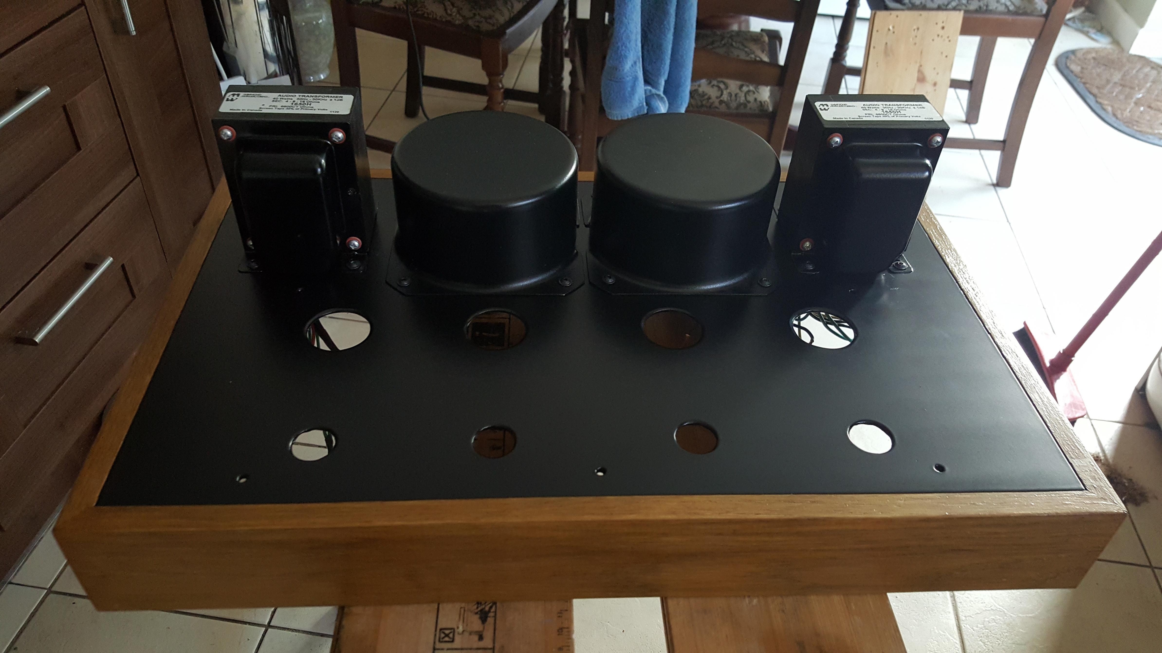

This project is very heavy. It contains 6 x transformers.
2 x OPTs
2 x 160VA toroids providing the B+
1 x 50VA toroid providing the HTR supplies
1 x 50VA toroid providing the 100V bias supply
The two main toroids are on the top of the chassis, the two lesser ones share the same real estate underneath the chassis.
2 x OPTs
