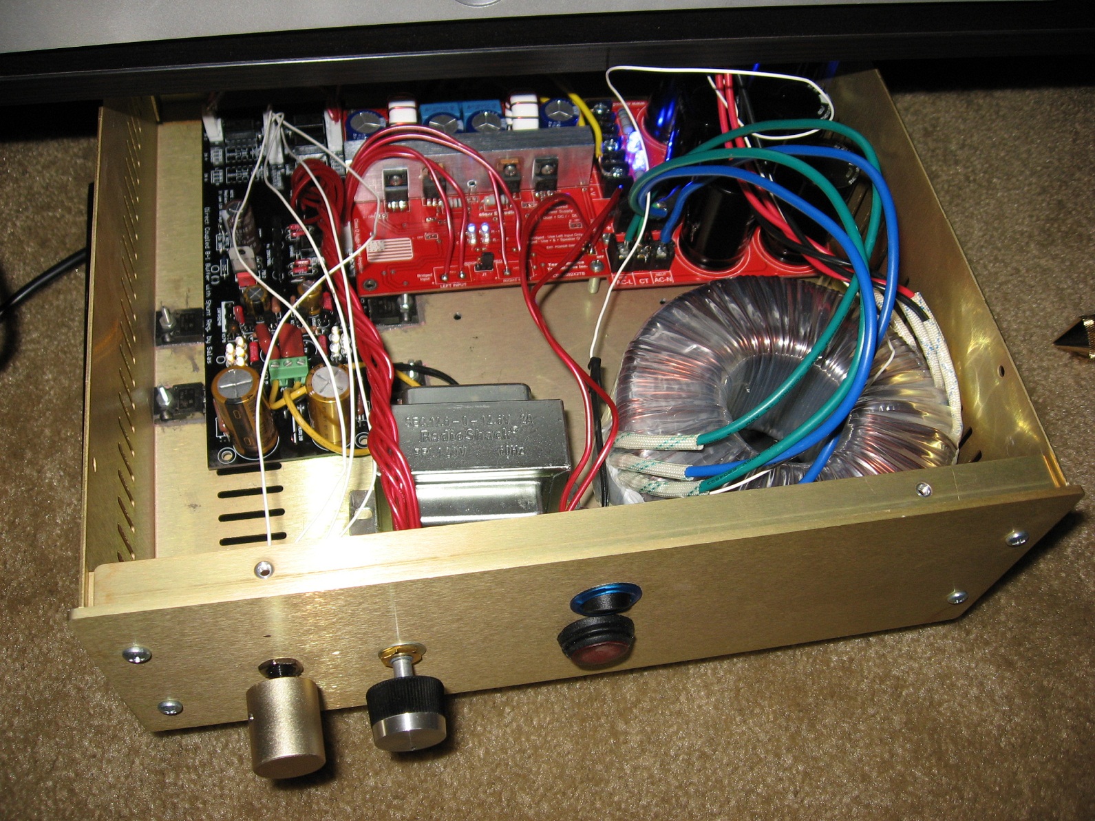

Here is my build: Integrated amp of Mez board w/ Classdaudio CDA-254 amp.

No buzz with so big transformer in there? What are those brownish film caps? Orange drops like? Mind you those have a say on the final tone. But let it settle for more play hours as you say. Congratulations for having it working as an integrated on first go.🙂

Btw, the wiring has been cleaned up. That pic was from my 'test' run.
No buzz at all, although I wonder if getting a steel cover for the toroid would be of benefit?
The film caps are PPS .1uf. I am unsure of what they may add to the sound, I just read they were good and were available from digikey with my other purchases. Hm, I guess I will have to try some other caps then to see what difference can be made...
Yes, my opinions are based on total synergy w/ the classdaudio amp and others will have different impressions. It is a very smooth amp, very transparent, very dynamic.
My speakers are 4 ohm DIY MTM w/ Dayton RS180 woofers and Seas 27TDFC tweeters. XO designed by Jay Kim. 250w is more than I need but it was only $15 more than the 120w version, so hey why not!
Its good having spare power. Such MTM speakers (4 Ohm also?) can be current sinks when under 90dB 1W/m. 3dB for a higher recorded peak is nothing to the ear but its double power. Especially with vinyl records over 0dB is common in enough. PPS is a great and not much appreciated dielectric IMHO. You can compare some but those you have may prove no slouches. Currents, offsets, voltages all OK I suppose?
No don't cover the Tx if there is no buzz. Let it breathe.

Looking at your picture, I can see a radioshack transformer. This has been VERY bad reported by other builders of this boards. The say that it runs very hot and buzzes.

I read about the RS issues, but I hear zero buzz and it doesn't run hot at all... and I've used 2 of them.
Those Mosfets still amaze me with their ruggedness. So tiny sinks and they survived. Didn't I tell to use proper sinks or bolt to thick floor so many times? You can't run on same sinks you use for regular setting a hot rod. OK, killing a Mosfet is no big deal, but if someone uses a DC amp without output relay DC sense, bye bye speakers.
