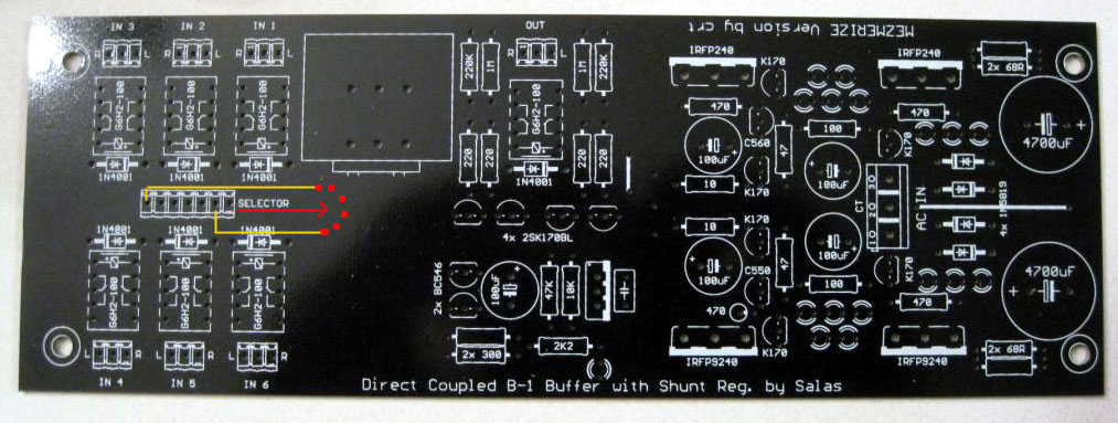

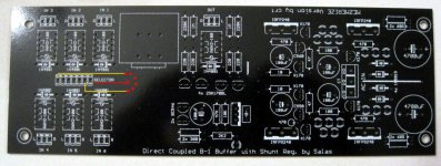

The single pin of the selector (the one that you would use as 'out' if it was signal selection) goes to ground last one on the right, and each position pin goes to each relay's number on the selector marked strip on the pcb.

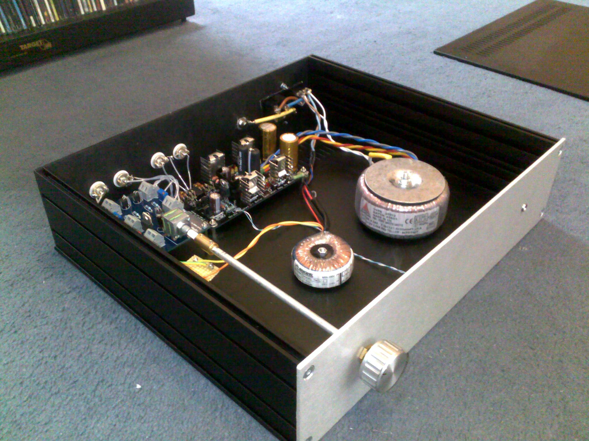

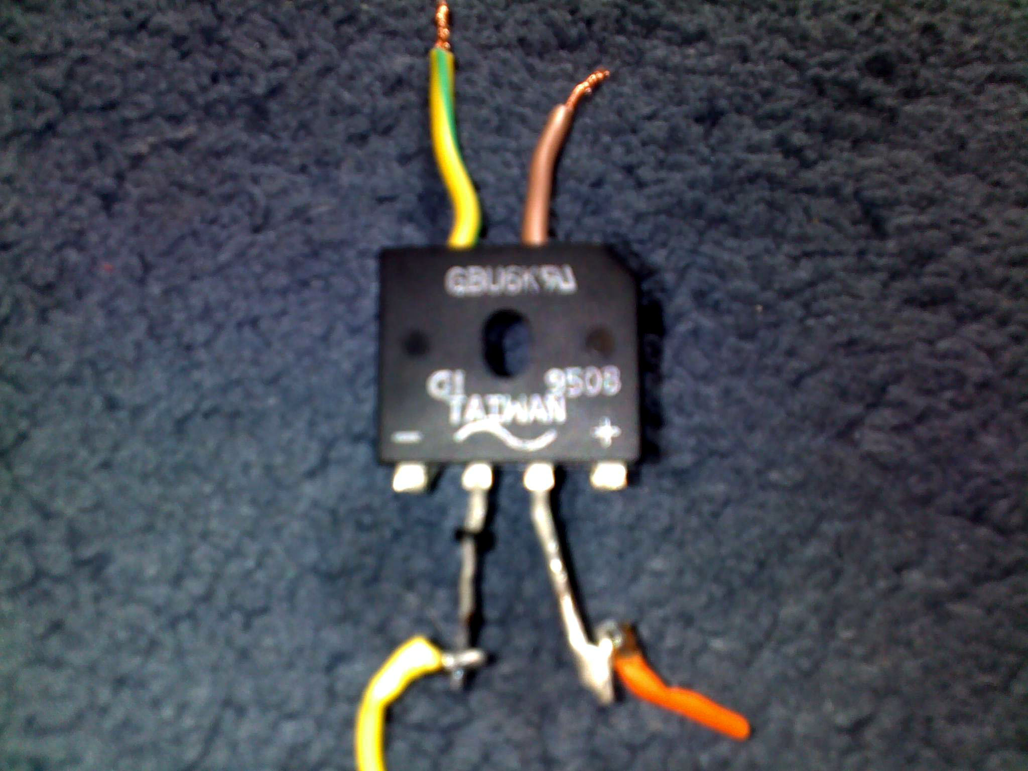

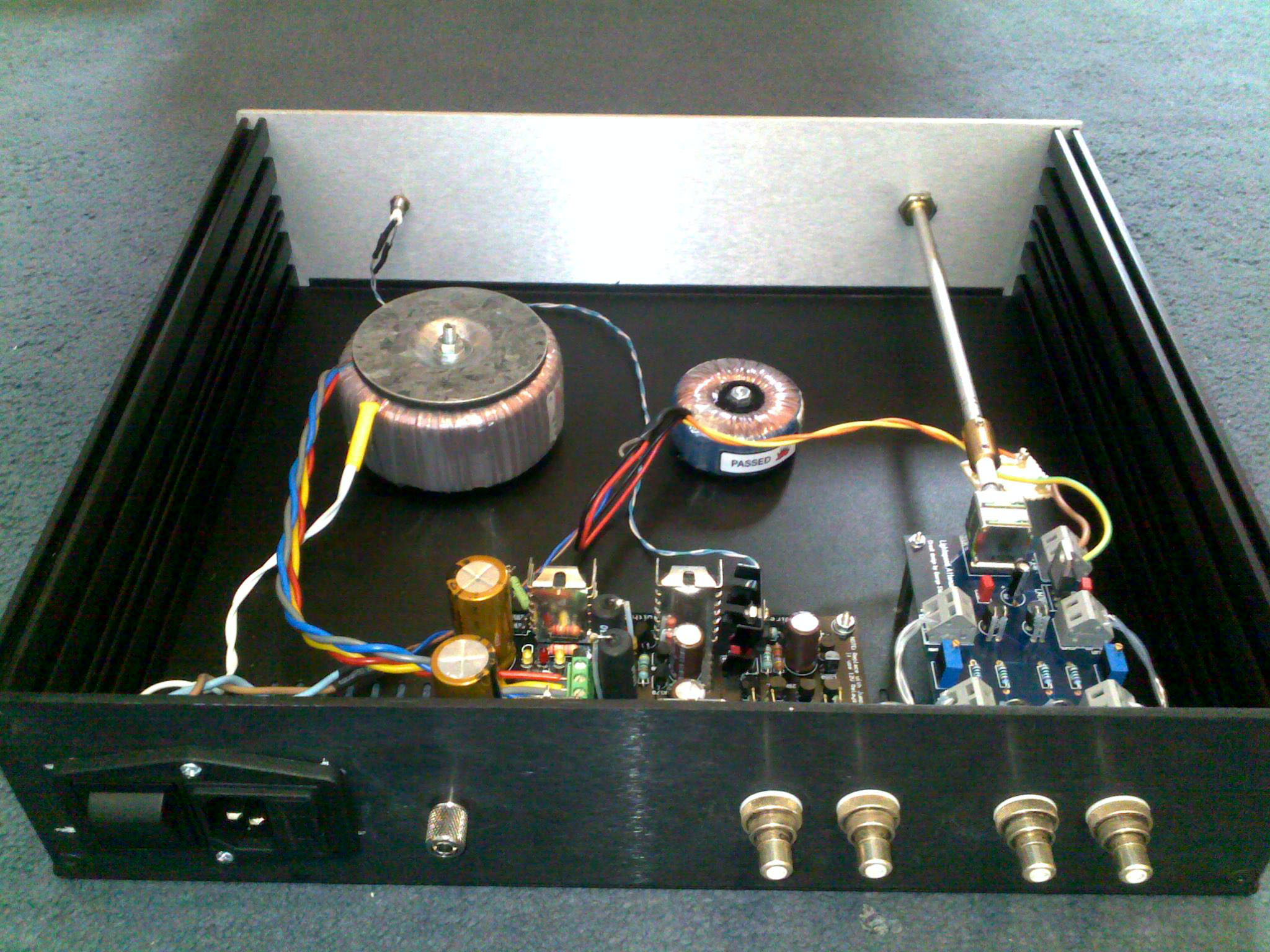

Today i removed the 200ohm resistor, to go back to 50ma in one channel and 60ma in the other. There was absolutely no difference in sound to when it was balanced. I could'nt hear any difference, so Salas you was correct, such a little bit of imbalance in the ccs makes no difference, and so i must credit the improvment of sound i heard, to swaping the diode bridge supplying the Optical volume control with 4 mur120's...could a simple change like this bring about such an improvement in sound??? Well i definitely heard an improvement...so i think yes.

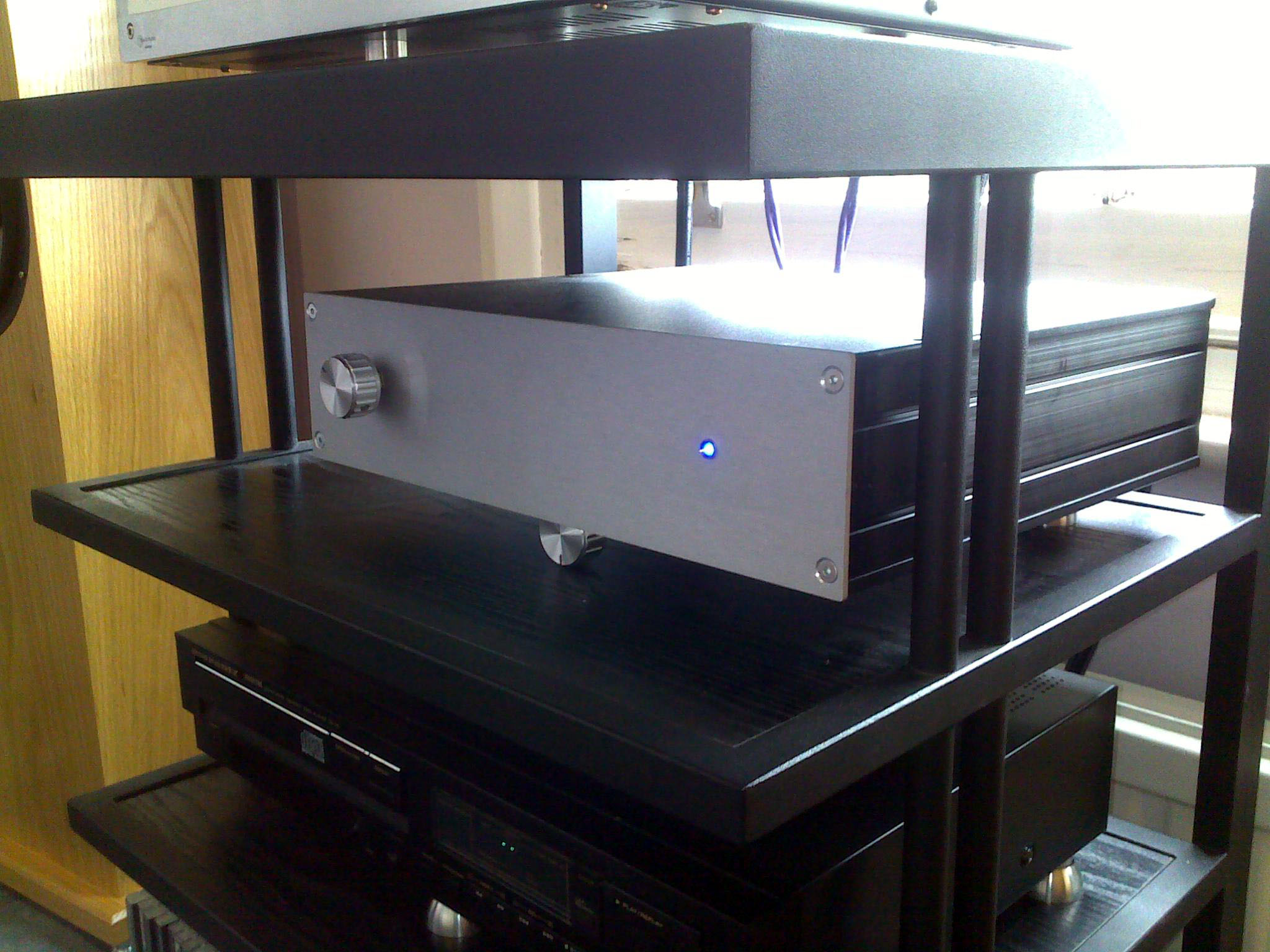

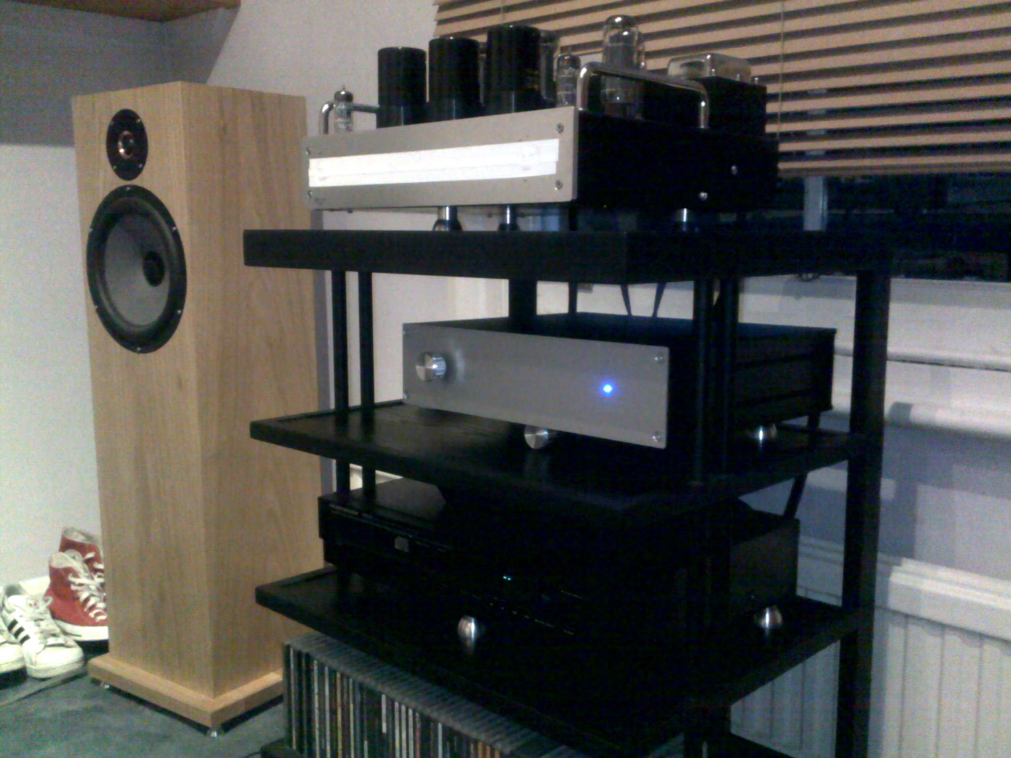

As requested here are a few pics of my Dcb1
And this is the Diode Bridge that i swaped out for 4 Mur120's
Next up, i will hotrod it...I have found this place for the heatsinks.
Heatsinks, Custom Heatsinks, Boardmounting Heatsinks, Anodised Heatsinks
Would someone be kind enough to suggest what heatsinks i should get? I intend to take the current to about 200ma per channel.
