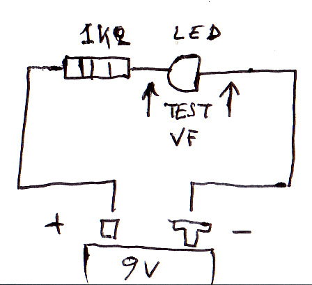

2. MATCHING THE LED STRINGS
Your goal is 9V total for Vref string and 5.4V total for CCS string.
So match your Vref strings by testing your leds with 5-6 mA. Try to get elements that add up to about 9.4V for a row of 5.
Salas.
NOTE: Salas recommends using a 9V battery and a 1K2 resistor to test the forward voltage of each LED independently.
NOTE2: The Vref string is the string of 5 LED's, the CCS string is the string of 3 LED's.

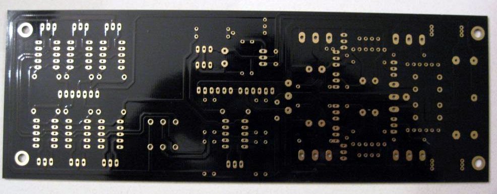

PCB pics:
http://www.diyaudio.com/forums/showthread.php?p=1937486
Overlay1:
http://www.diyaudio.com/forums/showthread.php?p=1909777

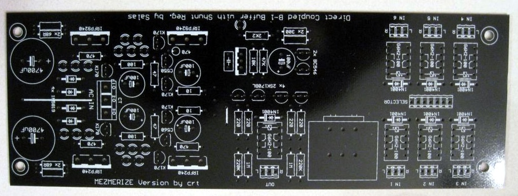

6. BOARD SIZE AND OUTPUT IMPEDANCE
Hypnotize basic board is 127X68.58mm
Mezmerize is 197.49X68.58mm
Output impedance: Has a 220 buffer resistor +30 to 40 2SK170BL internal = 250-260 Ohm output impedance and Idss current drive capability. 8.5mA BL mean average in my zip bag.
Salas.

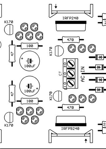

7. NOTES ABOUT USING THE HYPNOTIZE AS A SYMMETRIC SHUNT ONLY
Note for those who fancy the Hypnotize as a symmetric shunt reg board mainly:
As I have posted enough times before, this symmetric shuntreg has tunings for the DCB1 and will perform its best as a pair. It will work as a general shunt very well, but bear in mind that it is optimized for DCB1. It has a purpose built Vref current assymetry. Specifically I exploit the njfet's assymetry to run the positive voltage reference harder than the negative, in order to match the step responses of the two sides. The positive Mosfets have different drive optimization and damping needs than the negative ones in conjunction with differences between their NPN/PNP drivers. You will invariably see a 2.5-3% +V prominence in average with matched leds. This is due to they run harder in the plus side. The slight Vout assymetry helps find better DC offset by swaping audio side njfets that are not terribly close by nature. Its economic, intuitive, does not take much knowledge or special rigs. There are positive subjective findings also about the whole evolution of the DCB1's pairing regs and my final choices, but I will leave that out, its wacko enough as a basis of technical conduct.
So, in a nutshell:
1. You use the regs for the DCB1 as it comes on the boards, fine. Forget about it, enjoy some tunes. Done the weird part 4U.
2. You want very close +/- symmetry for some reason? Only for other applications than the DCB1, up R5 on the positive side until they meet. Best will be half road. Use somehow less Vref total leds on the + side's 5 string Ref, and up its R5 a bit. It works like a faucet for the njfet under vbe and the mV across it.
3. Want more ICCS current for another application? Lower R1's. (3LedsVf-Vgs)/R1=ICCS. As it is, it should run 60-70mA. You may need +20% of the Ibias on class A circuit feed if conservative, but double or more is a bit better for ample dynamic reserve. It directly hits on dissipation, so sinks or Mosfet assembly underneath PCB a' la power amp style and bolding on metal floor or aluminum bar on insulation pads becomes mandatory.
Salas.

- start with the lowest profile components, i.e. resistors, and work up from there.
- the resistor and LED pads are a little bit smaller than some builders prefer, so take care with these pads. Best to double check your resistors with a multimeter before soldering them in, to avoid removal later.
