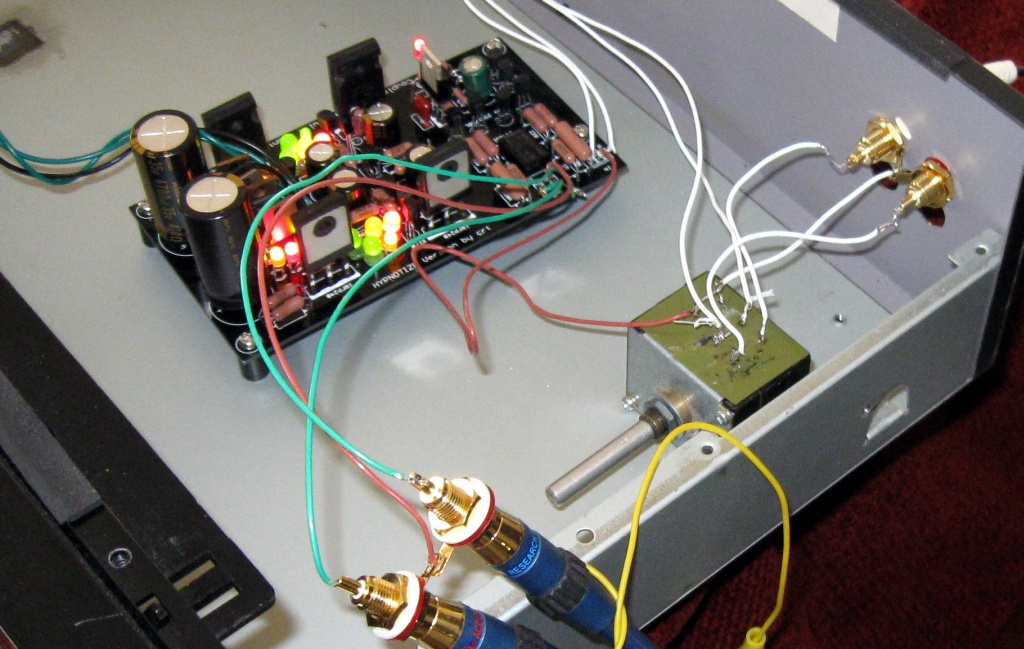

My Buffer Finally Done
Here it is....
It took a bit long time to find closest voltage of LED (finally i found around 1,8V LED, but then i realize that even i have all same voltage on LED, it won't give the same output voltage to supply the buffer because we dont match the transistor and other components, so we should compromise this by adjusting our LEDs. Therefore the LED voltage between positive and negative side isnt the same but resulting the same output voltage). The output voltage is about 10,7V - 0V - (-10,7V) with +/-0.05V ripple. Offset is about 0.7mV at positive voltage and 1.7mV at negative voltage.
I can feel more detail in sound. There are some resistors valued different from the schematic. They are:
37.4R 1W instead 34R 1W
464R instead 470R
215R instead 220R
Is this okay? Or is it degrade the sound quality from this buffer should offer actually?

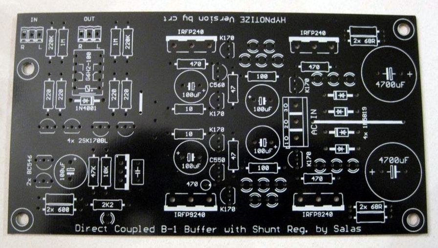

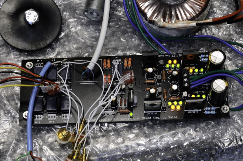

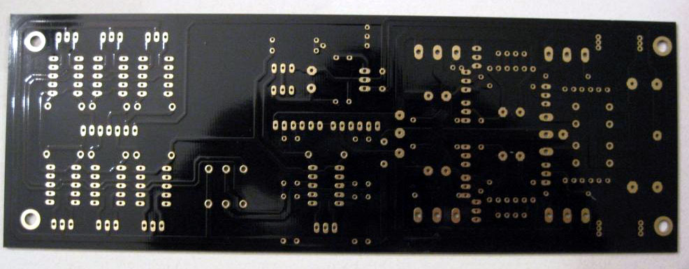

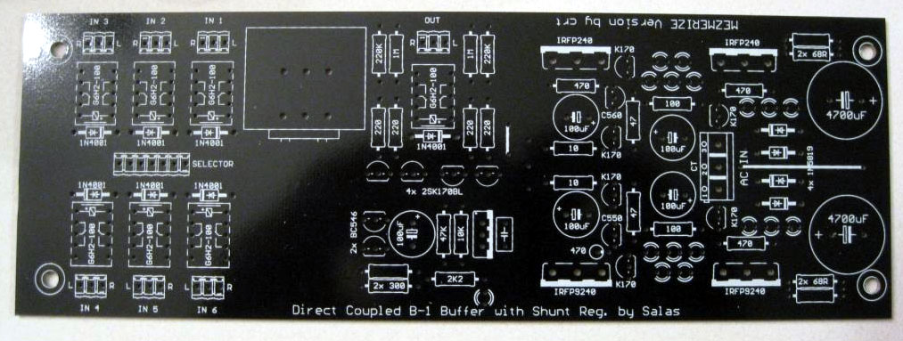

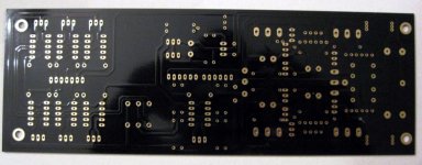

For those who don't follow the DCB1 group buy, the news are that Tea-Bag is the new GB manager. He has already given proto PCBs that Crt designed, out to several members and the protos are testing OK. He has opened a google document for everybody originally interested in boards to sign up. If we hit more than 100 pcs we are talking sub $10 per board. There are 2 options. The Hypnotize with only a delay relay on output for avoiding DC offset hick ups during on/off and it can be used as a one input buffer or augmented with a classic input switch, and Mezmerize, that sports 6 inputs via relays. Both need a 15-25k stereo log pot.
If you had your name on the original old wiki GB or new to it, sign up here:
