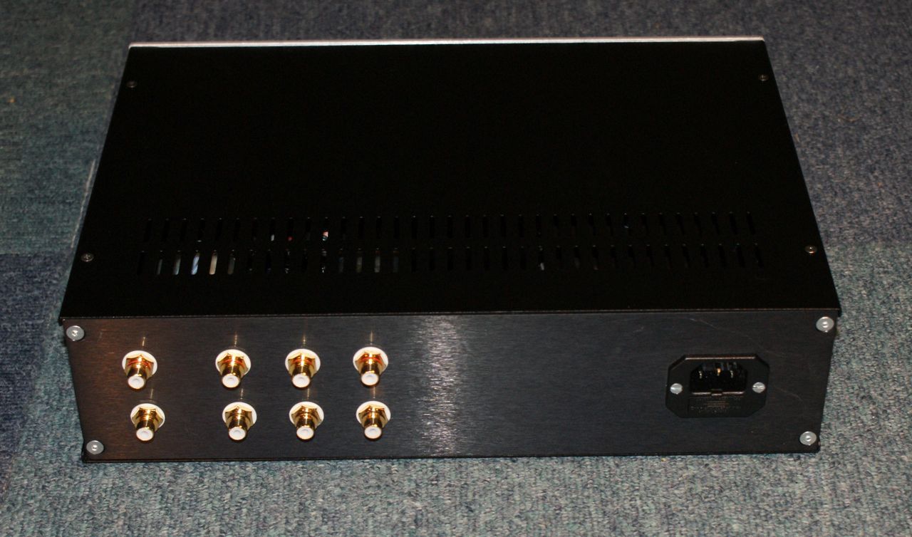

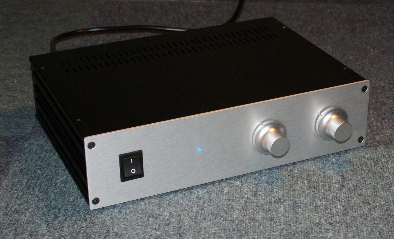

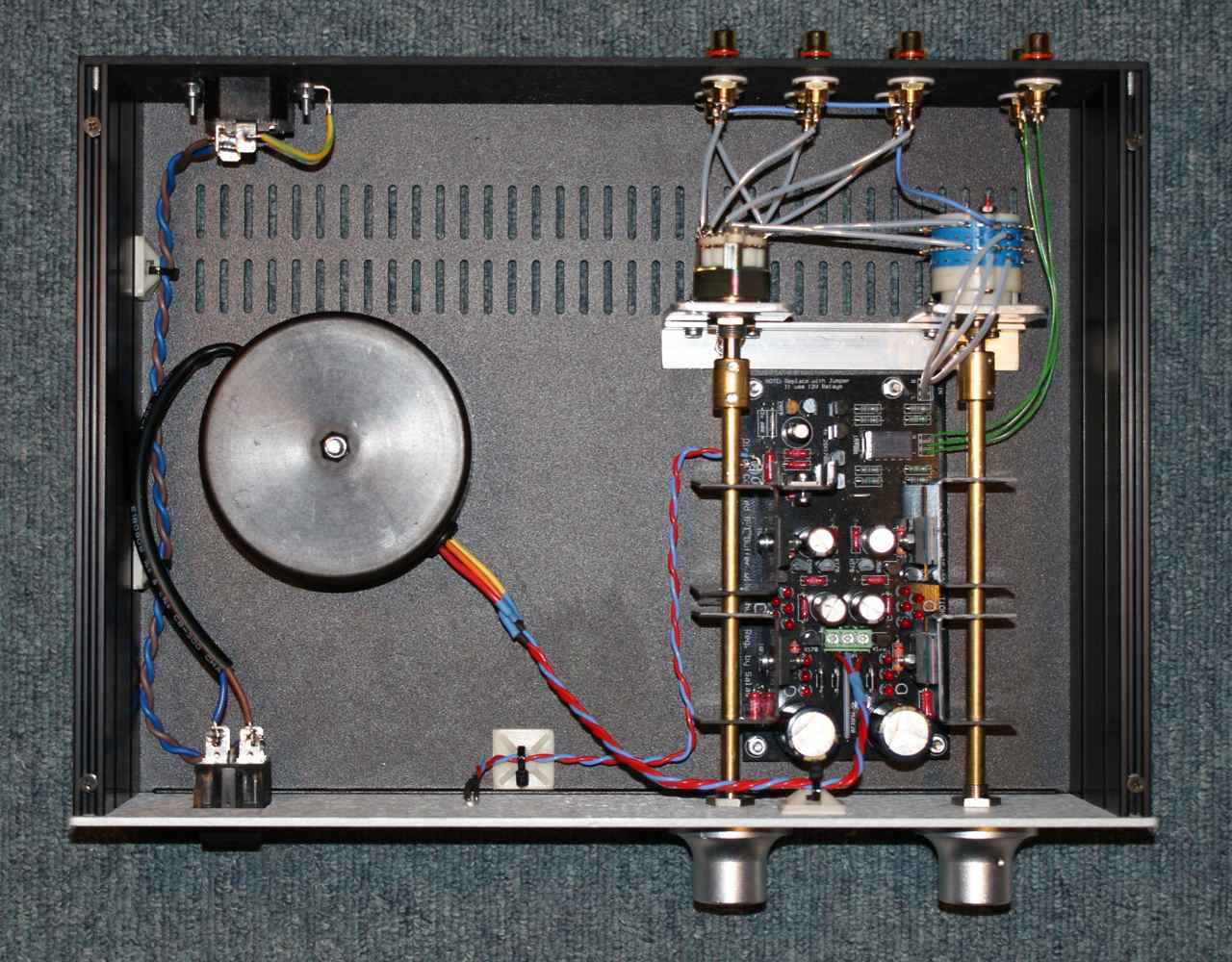

Today I finished my B1. The wire, attenuator and sinks still need attention but it is good enough to be put in production.
It sounds very good (no break-in time yet) in he sense that the music was still very detailed. If it changed anything I will never know as I removed the selector switch and attenuator from my tube-amp and I do not plan to put it back. I just needed a pre for my coming F5 and Tubelab SE.
Thank you very much for the circuit, pcb and support!!
Jeroen

Very orderly construction. Happy listening. Are those Takman Rey in the audio lines?
Thanks. Yes, they are Metal Takman. My other board is exactly the same but then with the Carbon Takman. Curious if I can hear the difference. Probably not....
Great layout...
Nice short wires!
Thanks. The green wires need to be replaced by something bettter though. And... if I hold my hand between the transformer and board I can see the "noise" going down. Or better, I measure less mV AC on the output (very quick and dirty measurement without any input shorted etc).
Jeroen

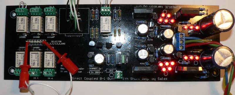

Got mine working, no case yet. Relays are different because could not find the Omrons close, but they work fine.
The DC offsets are -2.1mV and 0mV when the relay goes on, and they drift to 0.7mV and -0.7mV slowly, takes few minutes. Maybe need to do some changes to get them lower.
