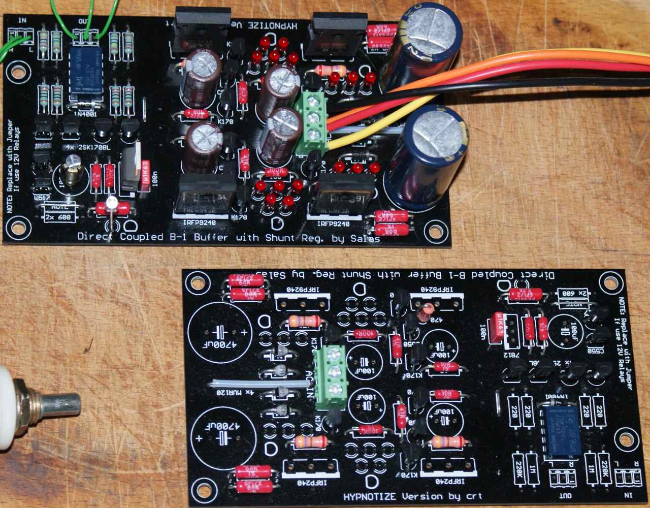

The leds that I got from farnell (per the BOM) al measure around 1.72V using a 9V battery and 1K2 resistor. Making matched strings will be easy but they will be a bit lower than advised.
What is the margin for the string values?

The 3 led strings are upping the current as much as they widen from CCS Mosfet Vgs and vice versa. In your case you just may get a little less current running in the regs, which is a multiple of what is needed anyway by enough times.
The Vout gave me enough contention around the 10V mark +/- 0.5V-1V. That is not about working, it could work in a wide range.

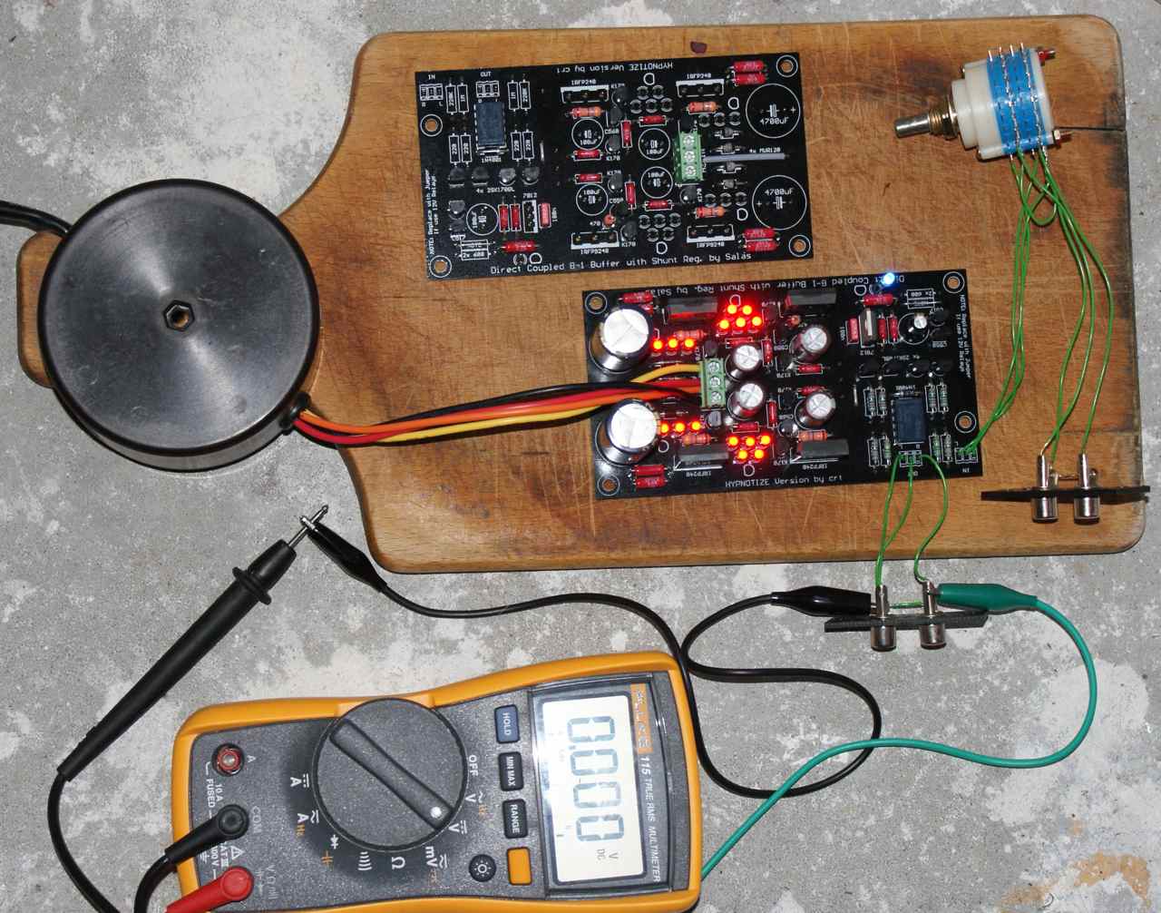

I used the parts from the BOM and matched 170's from Spencer and all worked the first time. The output shows 0 to 1 mV.
The unit tested ok on my 6v6SET. I listened just for a few minutes as it a test setup so I have no listening impression yet.
And now for the casing...
