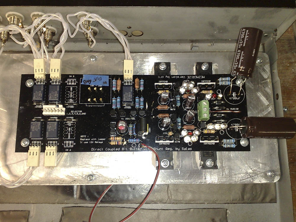

Well, I powered mine up tonight!! She lights up like a christmas tree and all seem well.
I get 10.1V and 9.6V at the output of the shunt - on an exceptionally low line voltage tonight of 220V. Tx were putting out 10.6 and 11.2VAC - normally this is a little above 12VAC (this could be why the neg reg has a slightly lower output).
The muting relay clicks in after about 5secs. The other relays all work AOK, tested by shorting the input pins to gnd.
Salas - the 270R for the V-drop for the 6V relays worked AOK,they are being fed 6.2V. I have a clip-on heatsink on the 7812 but its cool - could get away without one handy enough I'd say.
No buzzing or anything with the BC550 instead of the BC517.
2 separate transformers seem to work AOK.
DC on the outputs: 0.3mV and 1.3mV after being on for ~30mins
IRFP140/9140 barely get warm sitting on the bench (admittedly fairly cold out in the workshop tonight.

Your Tx secondaries are below spec when you have low mains. You need to measure the DC voltages on the main filter caps and the voltage drops across the 3 Led strings & 68R//68R and let me know.
Yes a single 10R 5W will do so to run the shunts high if you fancy. But run the system in using some normal pot so to get acommodated with its sound before you will either up the CCS current and/or add the LSPD, so to appreciate and communicate your impressions better.

Measurements:
V at filter caps: 13.8 and 13.8V
Drop across the 3 LEDs: 5.45 and 5.49V
Drop across the //68R: 1.789 and 2.150
Line is low again tonight at 219VAC. Every other time I have ever measured it, its been >230V. Maybe I would be better with a transformer with 15V secondaries?

52 & 63mA running current. I would like to see 16-17V on the caps so the CCS could reject wider ripple amplitudes as a margin, but I doubt you get any more than in 100-200mV range. If when you listen to it, you still can't perceive any roughness, then you should be OK. Else, you should up the secondary specs with the mains low plateaus you experience.

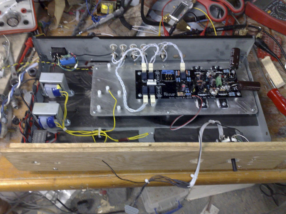

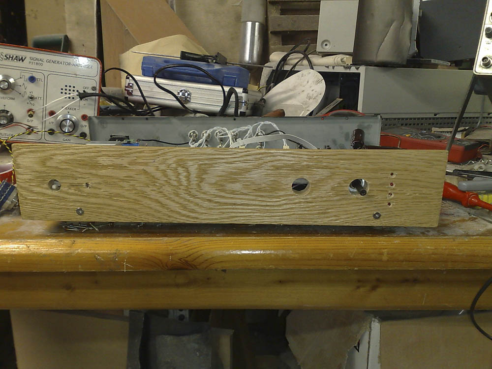

Thought I'd add a few pics up here.
Sorry for the fairly crappy phone pics.... the wooden front will match my F5.
