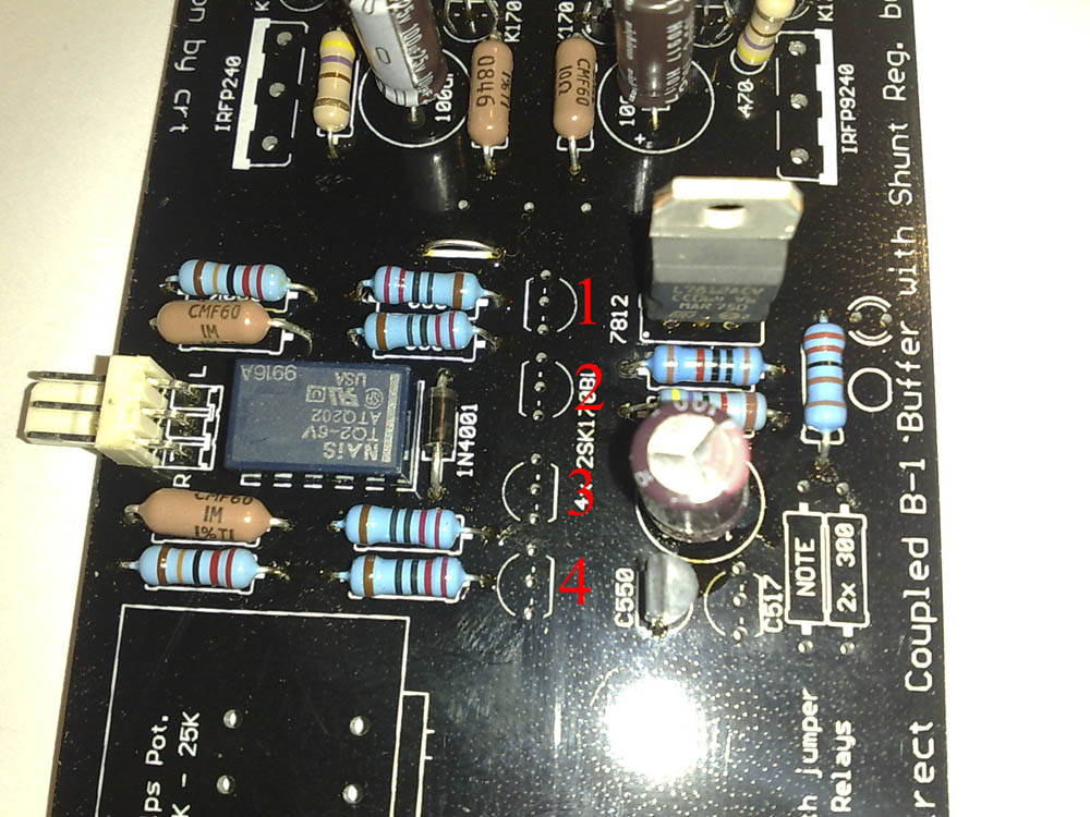

So I got to soldering mine together tonight and all went well - so far at least. I have a couple of questions - I would appreciate it if anyone can help...
1. Is it OK to use 2 separate 12V transformers rather than a centre tapped one?
2. I'm using 4 relays + muting (ie total of 5 relays) on my build. These are 6V NAIS ones. What size resistor for these would anyone know? I'm guessing about 300R or so....
3. Matching of sk170s - I have lots of matched pairs - but what is the orientation on the board - see the pic, are 1and 2 matched, then 3 and 4?

1. Never done it.
2. Check the Nais PDF, see the current consumption of each 6V Nais. Multiply it by as many you use. Use Ohm's law for a total resistor value of the parallel ones so you drop 6V across them from the 12V available.
3. 1+2 one channel, 3+4 other channel.

OK, thanks Salas..
The NAIS relays are 23mA each. So I have 5 in total - thats 115mA total - as opposed to 7 in the normal mesmerize with 28mA each = nearly 200mA. So higher resistance needed. Need to work that out, but bed calls. Maths is not my strong point!
I can't see anything wrong with using 2 transformers back to back like that. I suppose I'll find out when I fire her up!

Wrong.😀 Two at work in any one time. Not all. 1 input, and always the delay output engaged.
6V/.046A=130 Ohm. Use 270R//270R 1/2W each minimum is OK.
As for the trafos, you let us know.
