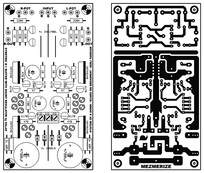

Hi, I could organise something like that but IMO the PCB still is not fully finished but maybe I am too demanding. I would like to see the rectifiers moved to the upper left corner where the transformer is normally located and that inputs and outputs find a more practical place. So outputs at the back of the PCB/case and inputs at the front/volume potentiometer side. IMHO the muting relay should be there and I would not mind to have the volume potentiometer and 4 source relays on the PCB as well.

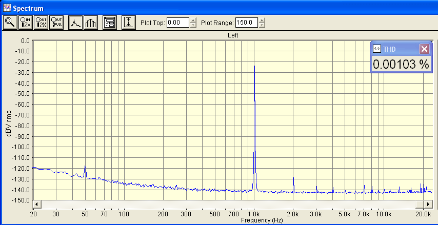

See attached, the noise floor relative to 0dB=1VRMS calibrated, and THD of my P2P symmetric. I don't see why I would want to put an op amp in the psu to imitate ground so to chase noise further. What noise? With shunts, it sounds even better.
Virtual ground via divider, exists in normal B1 with extra input RC filtering BTW.

Here is the PCB work. Anyone who likes to make, or carry a group buy, I have the Eagle files too. Remember, 2X68R is best for setting the current with no need for sinks on the Mosfet. 3X68R adds 40mA and makes the shunt ones kinda hot.

Please wait some more, La Ode will add some functionality to this shunt version. I asked him if he could move the power supplies to the left to avoid ground jumpers and make input and output wiring simpler. He replied that he will change the PCB but it will take some time.

thanh1973 said:
Hi Salas could you give us the dimensions of the pcb?
Are they the same as the original with linear regs?
By the way if we can get an order of 100 boards then I can get them made for $5 (US dollars) each + postage costs.
If you print it out at 124X62mm the Mosfets and Transistors / JFETs pitches look right. I did and compared with the actual semiconductors. The filter caps pitch looks smaller than 4700uF snap in that I compared. But there is pad space to drill wider. Maybe Crt used straight long pin filter caps. I emailed him to give us the intended dimensions. If you want the high resolution files and Eagle files, email me. Jean Paul wants something arranged differently, don't know about that. Me I find the current one practical enough.
