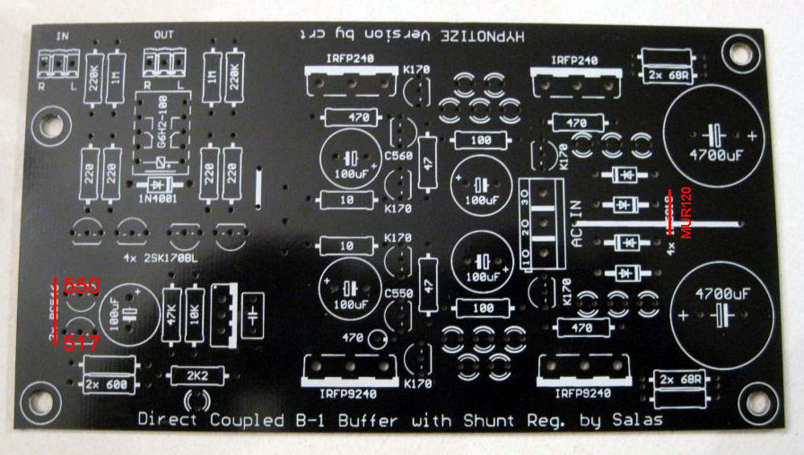

Building a symmetrical PSU B1 buffer

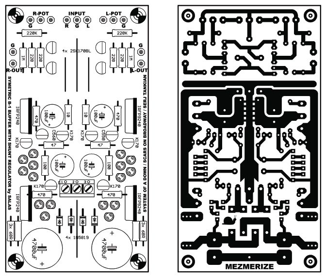

Good to see one custom encased. Will be easier to move around, do comparisons, and look like a pre after all.🙂 Waiting for pics.
The first one has better regulators. Both are the same for their audio part.
Those are good only for driving amplifiers with an input capacitor. They don't have a delay circuit, and DC is going to briefly appear on their outputs during shutdown.
