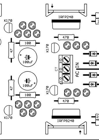

Help, Sorry I am sure it is just me but I can't figure out which way to install the leds. I read that the cath should be placed at the broken circle, but the screen looks symmetrical to me. Both sides are broken.
I have the ccs leds lit on one side, but I can not get the other side to light no matter how I spin them.

Cant grab the 2sk end of the resistor because it is so short. However I did get the DMM lead on the source leg of the first 2sk and the other DMM lead on the Rout and there is no continuity.
I will try to replace the resistor tomorrow without damaging the pad.

So we got it working.
Problem was the 220R was not even connected. The resistor itself is fine and measures 220R but the pad was incinerated.

I am happy to report that replacing the lower NPN with a Salas recommended BC517G and a upper 550c worked well.
This in addition to replacing the National Semi with STMicroelectronics 7812ACV removed the chatter I had currently seen. So I will ask Korben69 to put this on the recommended parts list.
I will also discuss with La Ode a possibility of updating the boards to reflect this change if we deem it will work for everyone.

Vice versa. Lower towards 2 resistors = BC517
Upper towards B1 audio part = BC550
