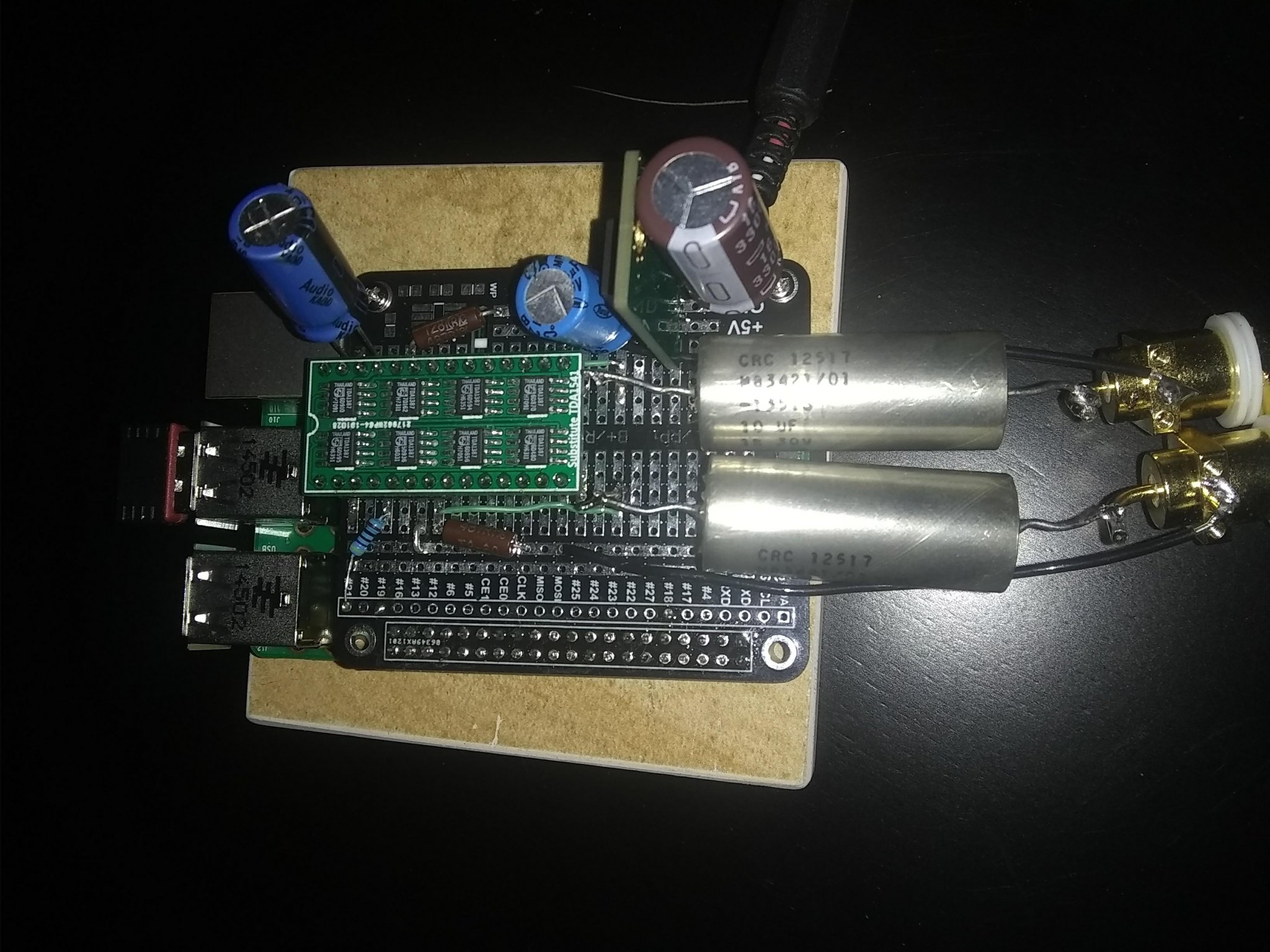

I think it's a great DAC for a first time DAC build project. I went with the TDA1387 8x TDA1541 replacement boards sold on eBay. The design can be as simple as passive IV, depending on what it is driving. I started with a minimalist build. Using an RPi Proto HAT board, two IV resistors 470R-500R, output coupling caps 10uF film, and 470R series resistors for I2S. I2S straight from the RPi GPIO. Powered using an LT1963 (7805) converter module with additional caps. The Vdd cap value effects the sound quality, so get a good audio grade electrolytic here. With the 8x module, C3 and C4 are the datasheet values and SMD ceramic. But, that's it. Try that to start, and add sophistication as needed. Great sounding DAC in my system.

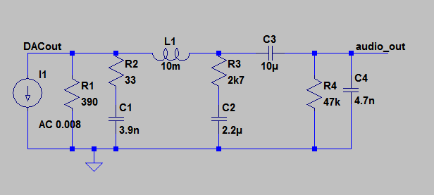

What kind of passive IV circuit did you use @hifiamps? Same topology as in the attachment (taken from @abraxalito himself in another thread)?

The passive IV circuit is as simple as it gets. IV resistors to ground. I don't have any post-DAC filtering. But since you are using it for a critical application, you will probably want to achieve a flat response in the final circuit. @abraxalito is the expert here. I'm suggesting to begin with the simplest prototype, and have a listen.What kind of passive IV circuit did you use @hifiamps?

Do you mean @hifiamps that the IV filter you use is the same I posted in attachment before? Or something even simpler than that? :s

I am not using an IV filter. I go straight from the IV resistor to the output cap. No filter. So it does not have a low pass filter at all. I think you should try it that way first. I suppose it has the sinc droop -3dB at 20kHz, but it sounds excellent to me. You could upsample 44.1 to 88.2 to make the response flat, but 16/44.1 sounds best to me as is, without upsampling. I'm not sure why that is the case. BTW: 24/96k and 24/192k sound excellent with this DAC, even though the lowest 8 bits are truncated.Do you mean @hifiamps that the IV filter you use is the same I posted in attachment before? Or something even simpler than that? :s
I generally try to avoid filters if they are not needed, and if they are needed, keep the fc well out of the audio range if possible.

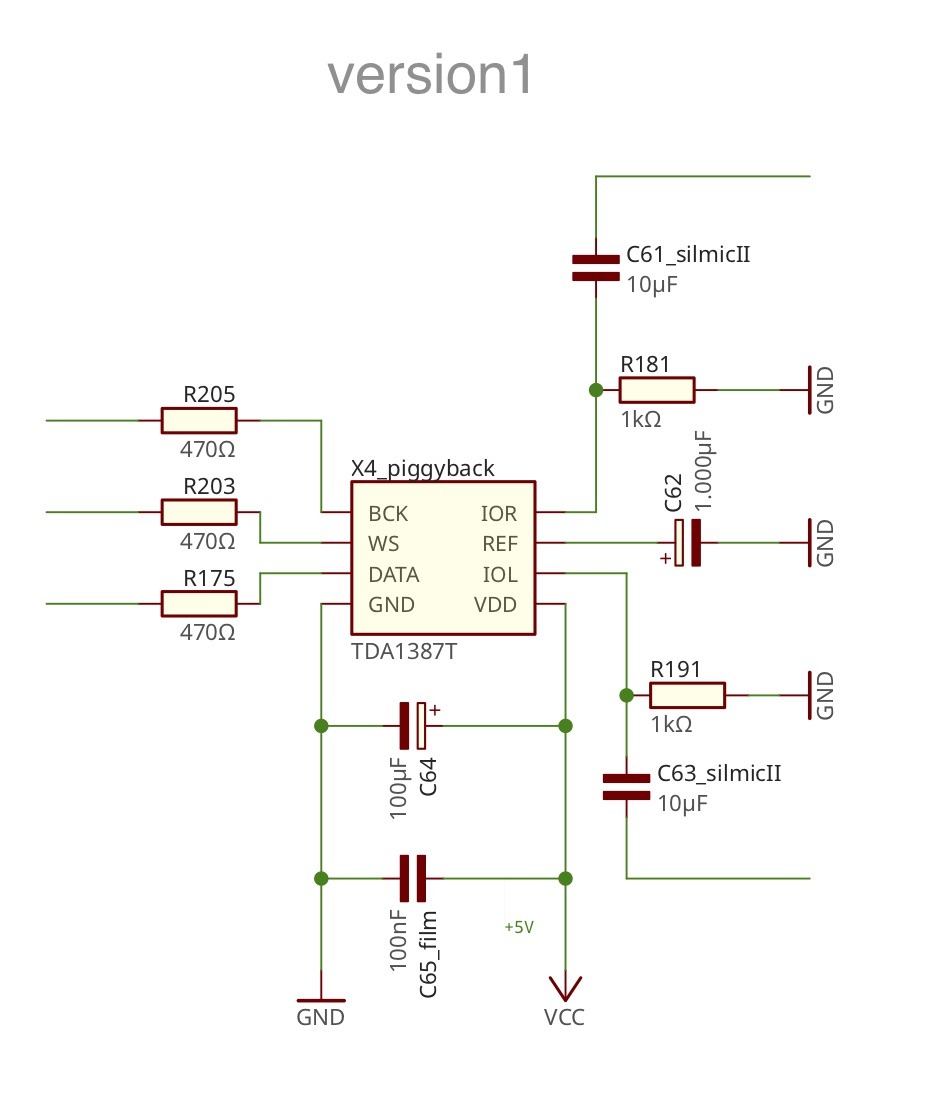

Is the following diagram interpreting correctly the minimal setup that you have @hifiamps?
Any mistakes or corrections to do? I'm not sure about the VDD cap, should it be an audio grade high value electrolytic or 100n film cap. Also, what kind of IV resistors are you using? Film? Your output caps seem very extraordinary too. What I have available here is mostly Nichicon electros and Wima MKS of all values up to 4,7U. Also some 1UF MKP are laying around 🙂 My resistors are all metal 1% tolerance. Anyways, I can always get additional parts may they make an importance difference.
PD: Please notice that I'm paralleling 4 chips.
The circuit diagram looks correct except for 4x TDA1387 you need ~1k ohm IV resistor (R181, R191). The 470R is appropriate for 8x, as abraxalito stated above. Traditionally, MLCC are used for C64 and mounted as close as possible to the chip. I think you would need only one for your stack of four TDA1387. An acrylic film SMD may be better. Adding a 1uF acrylic film SMD cap in parallel to C64 is beneficial. Can the stack of four TDA1387 share C62? I'm not sure. The 8x module has individual C64 and C62 for each TDA1387. The 4x module also uses individual caps. I use a 1000 uF audio quality electrolytic for Vcc mounted close to the 8X module. The output caps are very important for sound quality. The WIMA MKS 4.7 uF looks like your best bet. But since you are looking for the most compact package, a Silmic II electrolytic would be much smaller. Another possibility might be to somehow remove DC offset to enable direct coupling, and completely eliminate the output coupling caps. I'm not sure if this can be done in passive IV, but it can be done with active IV. Abraxalito probably knows the answer.

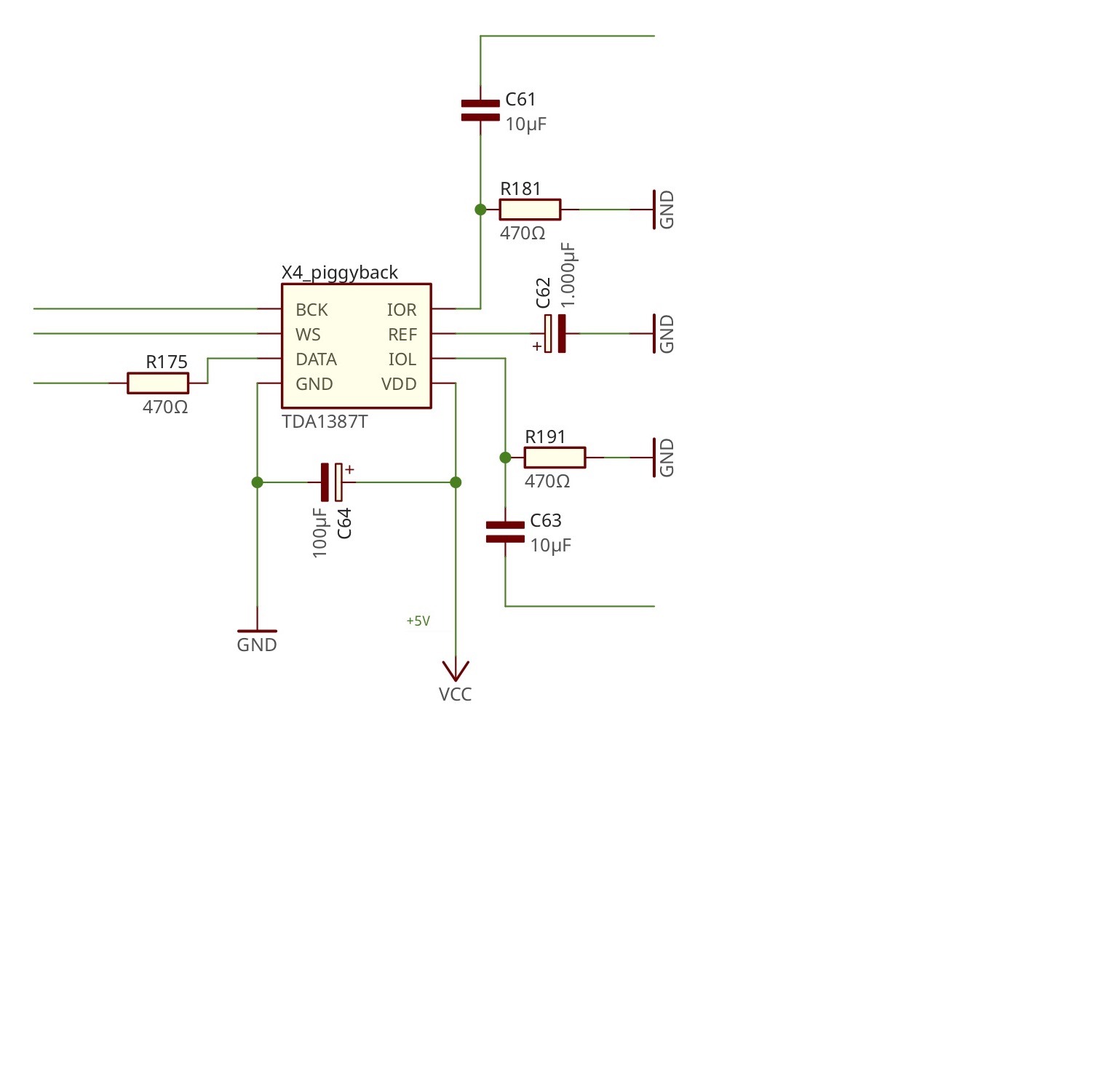

Thank you @hifiamps, I attach diagram with resistors corrected for the record. I'll try first with a 100u VDD cap, then move to 1000u if necessary. Plenty of information to experiment 🙂

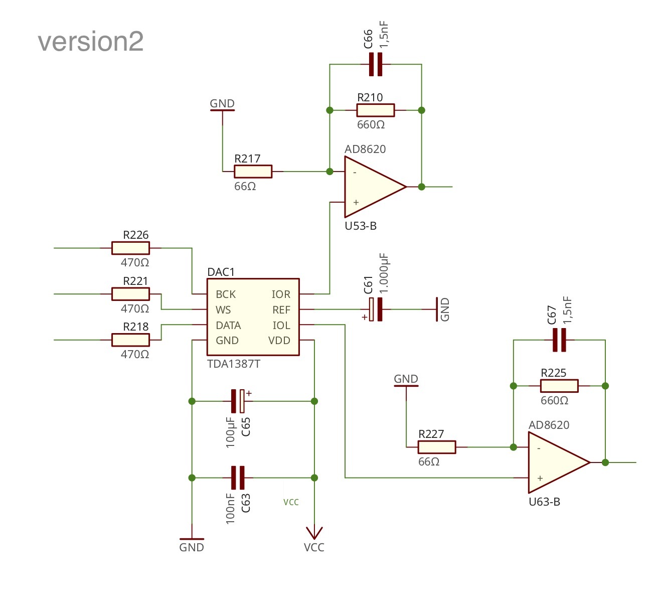

It came to me the idea of combining (for size reasons) an active IV with the headphone amp I was planning to use anyways after, which is no more than an inverting opamp. The idea is in picture "version 2". I don't know if this would work. What do you think @abraxalito ? Feedback resistor (R210 & 225R) is 660ohm (2.7k / 4). The 66ohm to ground should provide a gain of 11. Feedback cap (C66 & C67) follow the datasheet value of 1.5n as per datasheet, as I don't know how to calculate the maximum size before going into slew-rate limiting (50 V/μs @ AD8620).
Your version 2 schematic has the current outputs of the DACs going to the +ve input of the opamps as if the DAC's outputting a voltage. The DAC current outputs need to see a low impedance hence they go to the opamp -ve inputs. The gain at the output is set by the feedback resistor, no need for the 66Rs.
Are you running only a single 5V supply for the AD8620s? If so then the opamp's +ve inputs need biassing at some positive voltage to be calculated. [later] After looking at the DS for AD8620 I see its not a single rail design, its lowest operating voltage is +/-5V. So you'll need a -5V supply.
I see now that I need an inverting amplifier for IV. Thanks for the observation. The AD8620 is indeed dual rail and I'm planing to feed it with a rail split opamp configuration, which I use in other parts of the circuit to feed other dual rail mixers. The split however provides +/-6v max. and +/-4.5v min. depending on battery state (3 lithium batteries in series). Quite on the edge. Could you suggest me any lower voltage dual rail opamp to play the role of IV and headphone amp simultaneously (up to 100ohm impedance cans)? Or would it be better a single rail within the range +12v max. +9v min.? And since the cmoy wouldn´t work here, would a simple opamp in inverting configuration suffice to drive the headphones?
