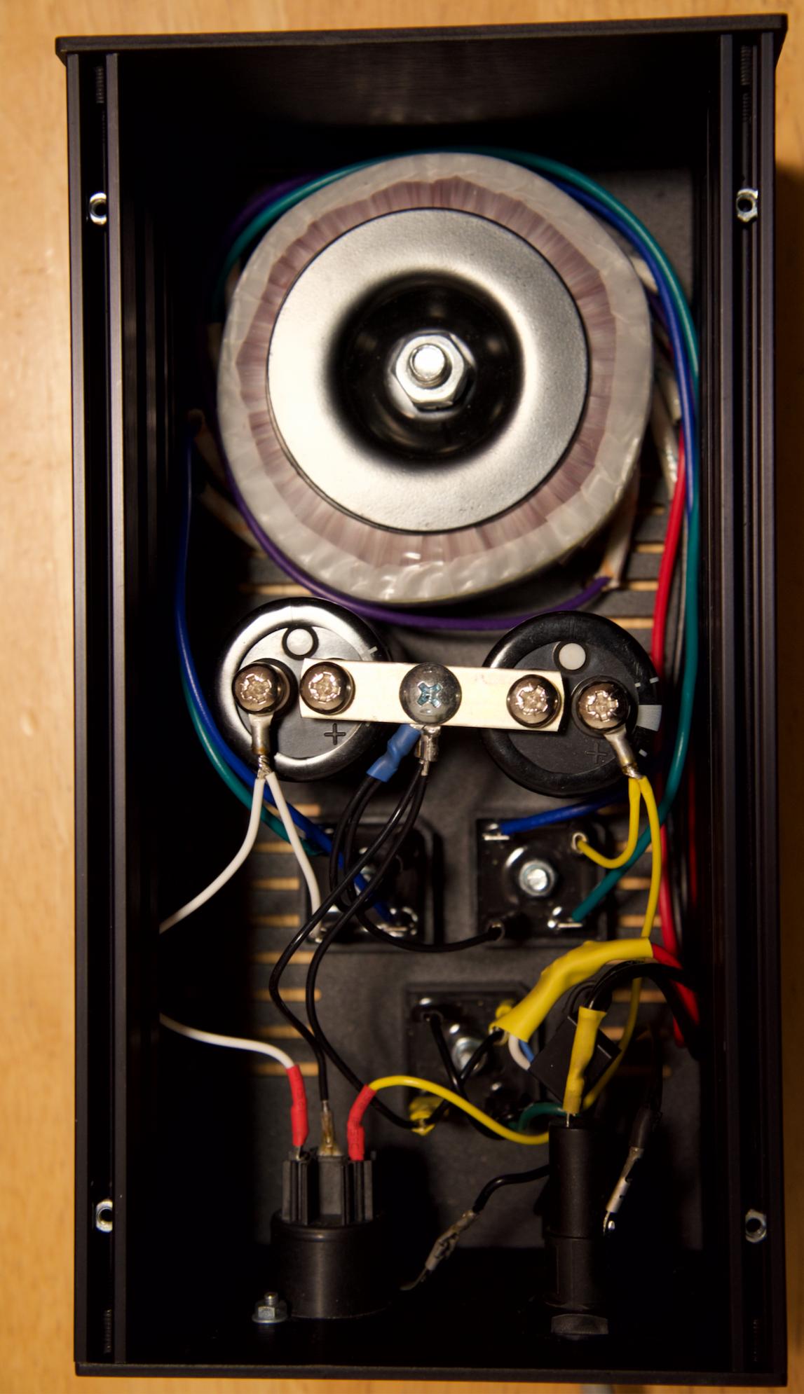

An update to my blown fuses... and thanks!
It was simply the result of my amateur mistake of not paying attention when inserting the measurement probes into my DVM. I inadvertently plugged the black into red hole and the red into black the previous time I'd used it to measure ACV. So at the tip of the probes +31V and -31V were reversed!
Thankfully, I figured it out the night before BAF. I'm even more relieved that when I applied power correctly I was able to easily adjust zero offset and the thing worked! It is dead quiet and a HUGE improvement over my old Parasound phono pre. It was great spinning vinyl through Nelson's F8 prototype at Burning Amp! Carlos Santana never sounded better!
Thanks Wayne!, for sharing your design of an incredible piece of equipment. Also thanks to all of you, especially Jim, for all of your guidance and encouragement that helped me overcome my fear of messing things up! It was well worth the effort!
When I have time I'll post some pics. 🙂

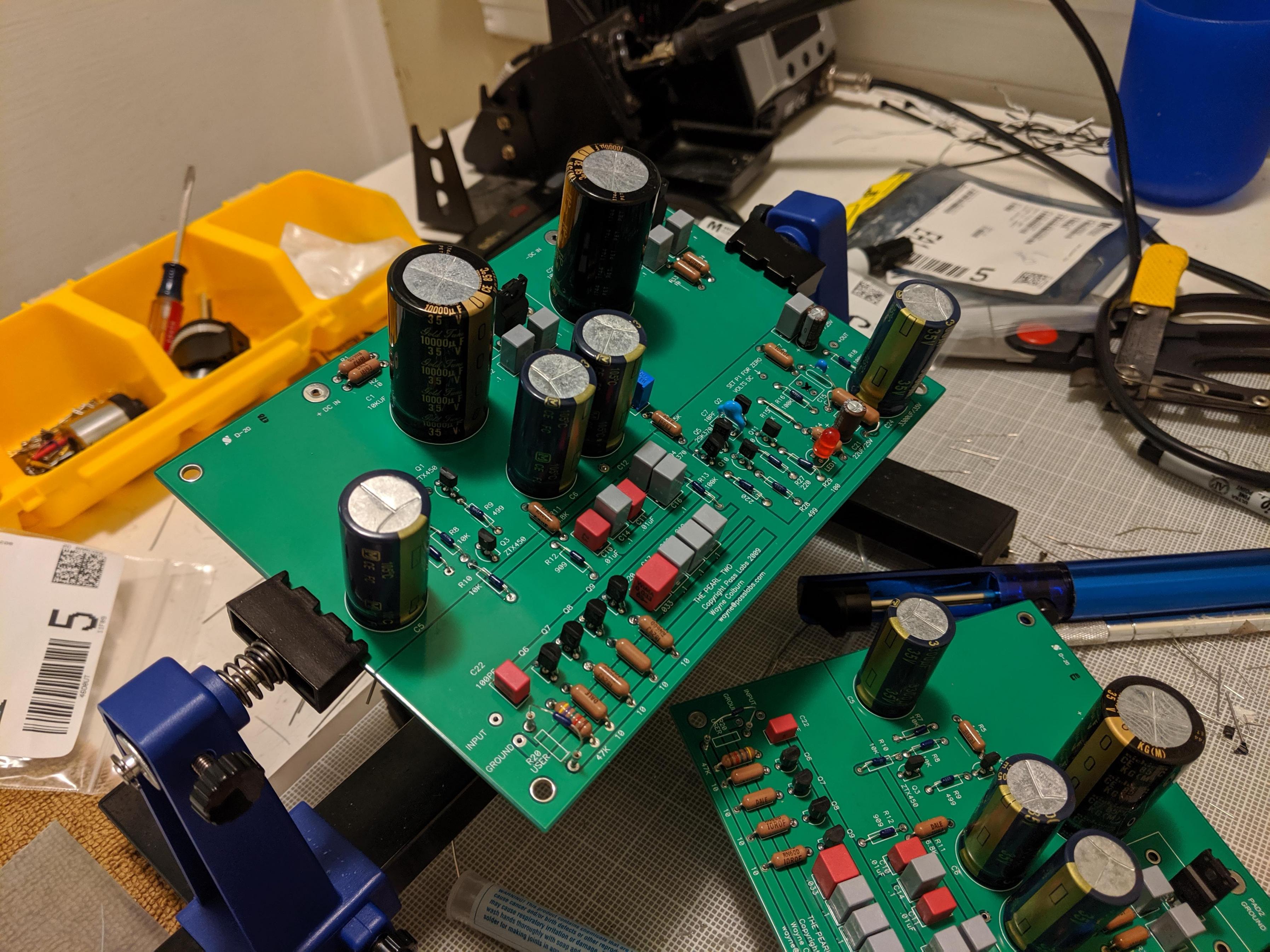

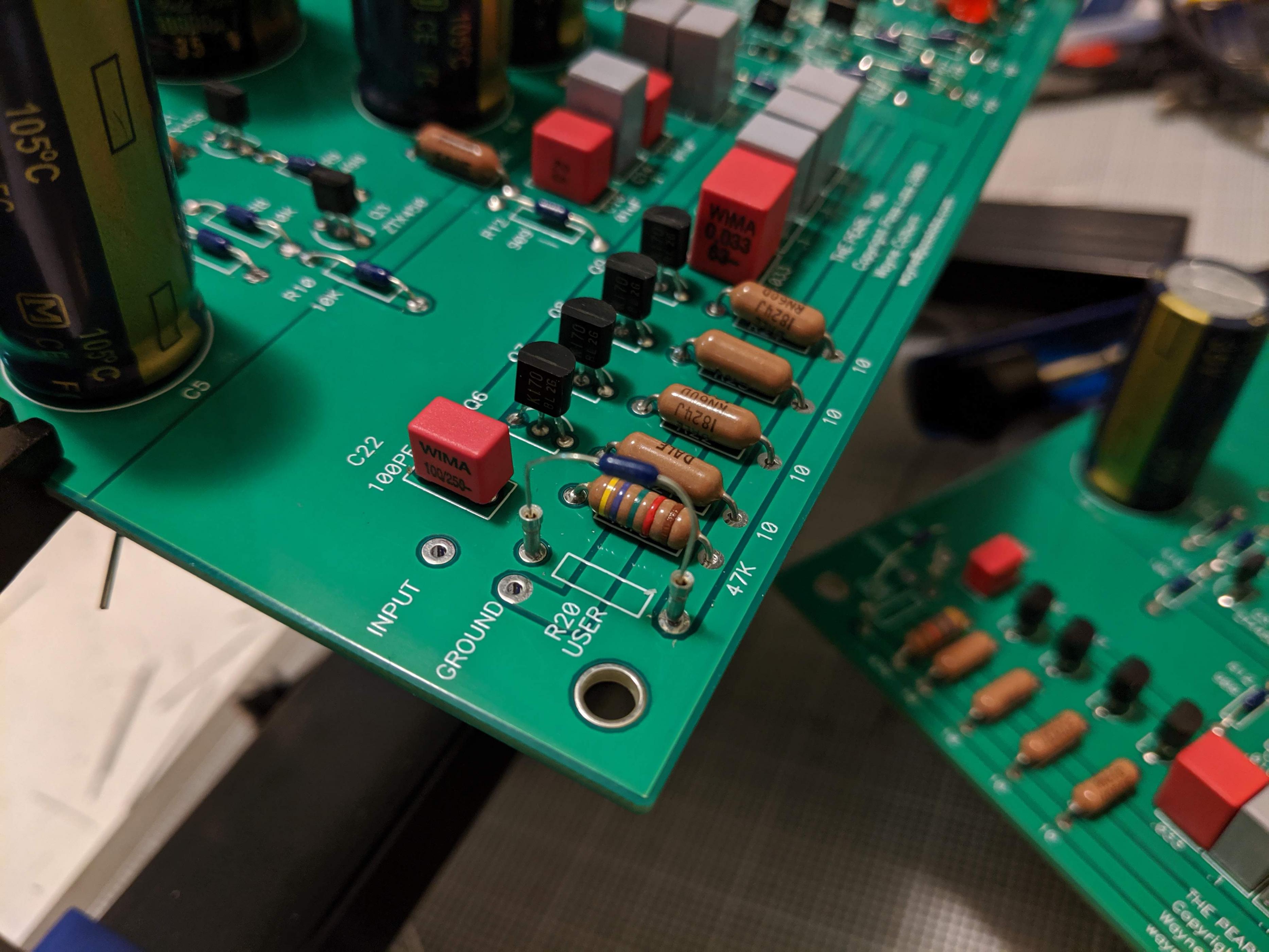

I am in the midst of finishing the boards of the Pearl 2. My first advanced DIY electronic project. I realized that I need to get better at soldering, especially big caps 🙂 While I am waiting for a soldering wick to arrive in the mail, does anyone have recommendations for a good switch that I can install for changing impedance on the fly? I am going to use this preamp with a cart I have not used before, an Audio Technica Art7, that has a very low output of .12 and there is not a consensus on the best loading value. Right now I installed resistor sockets but I want to avoid opening the case every time.

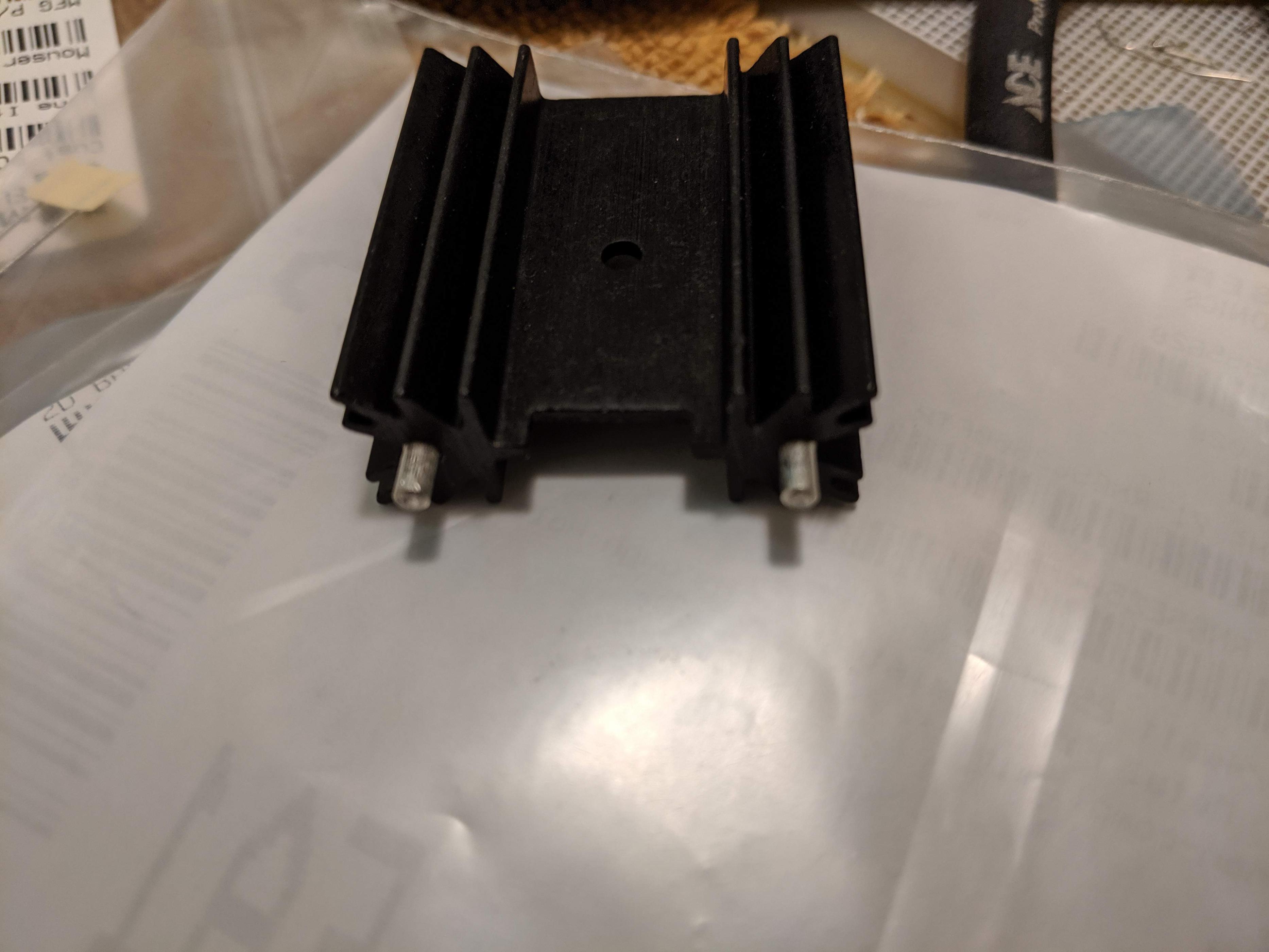

Also, I have never installed regulators with heatsinks before, I noticed that the heatsinks don't have threaded posts, do I have to solder them to the board? If so, that will test my skills for sure. 😱
Here are some pics of the progress. I had some soldering mistakes that I need to fix and one of the smaller caps I mistakingly installed backward. It's getting there. I had a bad injury so I had to put this on hold for a while.

How often are you actually planning on changing carts? I'd personally keep the sockets on the resistor and loading cap and call it good, since once you have it dialed in you'll not change it anymore.
The heatsinks solder to the board. It takes a while to get some heat into them, because after all, they are heatsinks...

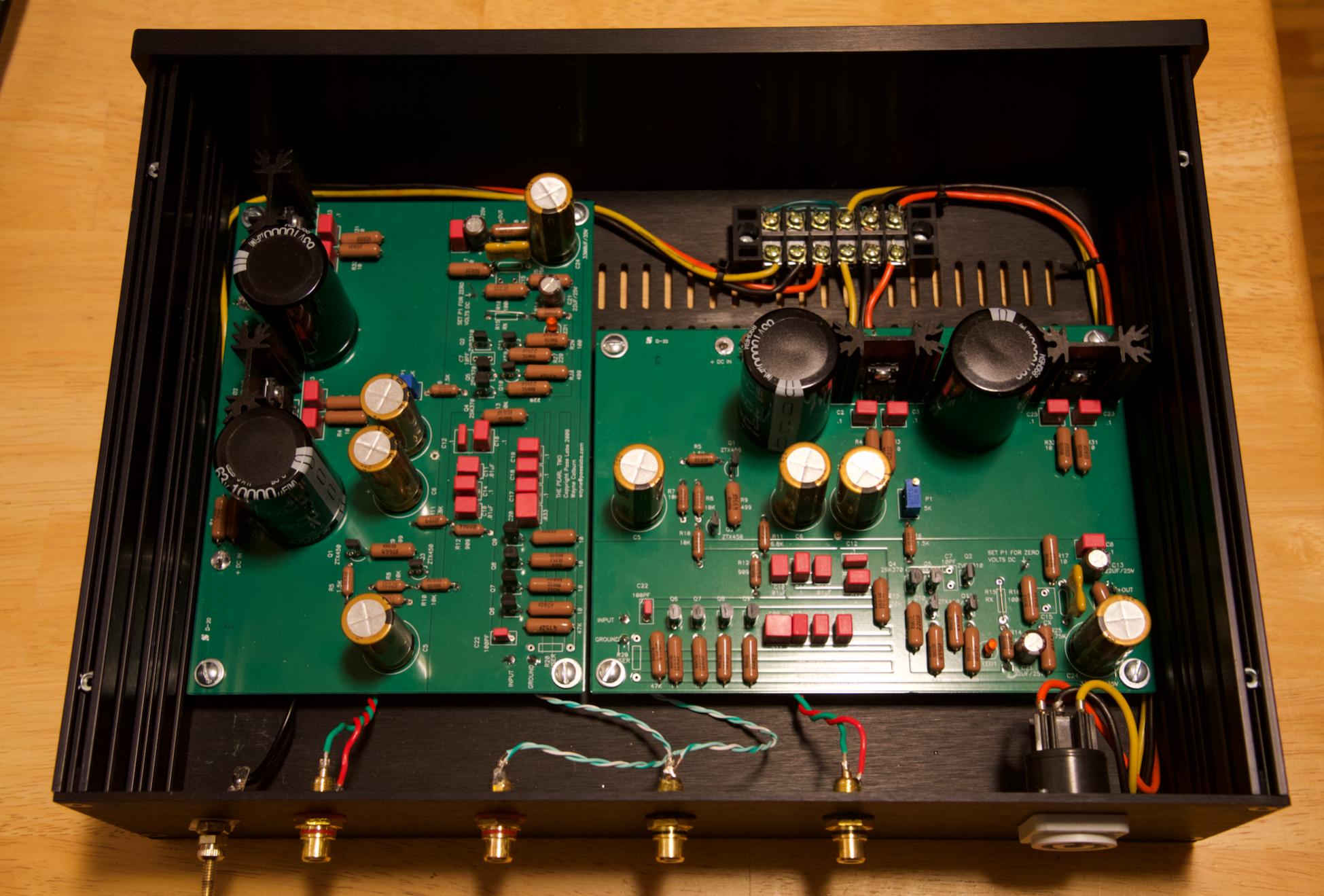

I'd like to put the two boards end to end in a Slimline 1U case if possible so it would fit in front of my record player in a long low case. Power supply can go at ground level below it.

Very nice. I’m thinking and out building the PSU the same way. How does everything?
How does everything SOUND?
