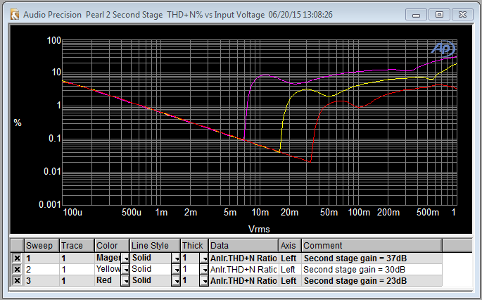

4mV cart is fine! I'm using an Audio Technica cartridge that has 5mV of output. Depending on the specifics of your gear, you may need to reduce the output of the Pearl 2 a bit by adjusting R14 a bit. Mark has a nice explanation of this here.

I'm running an Ortofon VMS20 mkii moving iron cartridge that has a 5.0mV output. My Pearl II worked fine with it built as the original schematic. The output was a little high but not in any way distorting, just not optimal. I put sockets in the R15 and C15 spots to allow me to adjust gain, and for the VMS20 I settled on shorting R15 and a 46.4k resistor in C15 to adjust gain at 1kHz to 45dB. I've left R14 at 1k. Works great!
