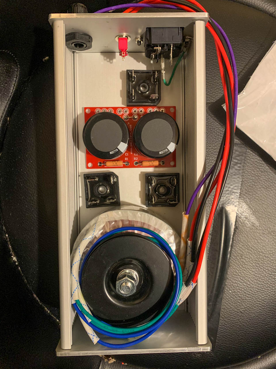

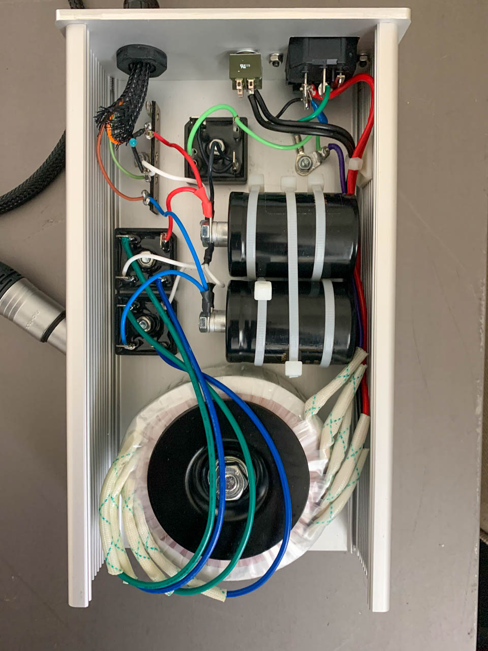

I can give a nod for the PSU in the design doc as well. For the first one, I had a bit of an issue thinking about mounting the caps and ended up using large screw mount caps, with point to point wiring to the bridges. The chassis was not huge but larger than I wanted.
For my latest one, I tried to make the case smaller and cost less. I'm using one of the small cap PCB's Pete Millett has on his eBay store with 2 bridge rectifiers. I had the rear panel made in FPE for the IEC, gland and SPST but you can omit the IEC entirely and hard-wire the power cord (so only circular drill is needed).
- Hammond 1455N2202 case
- Antek AS-0522 - 50VA 22V Transformer
- 3x Bridge rectifiers
- Misc -- IEC socket, SPST, cable cinch gland.
- Snap-in caps on a PCB
P.S. Check out Arrow.com for great deals. I've found that they have certain items that are much cheaper than other places, so instead of buying a specific part, I go there and sort by price.
For example, some of these CDE SLPX snap-ins at less than $1 ($3-4 elsewhere), and GBPC3504 for $.60 whereas $3-$4 elsewhere (parts used in this build). Same for C&K SPST toggles.
If I were to do it over once more, I'd design a small PCB for the 2 caps and 8 discrete rectifiers. The PCB cost is cheap.

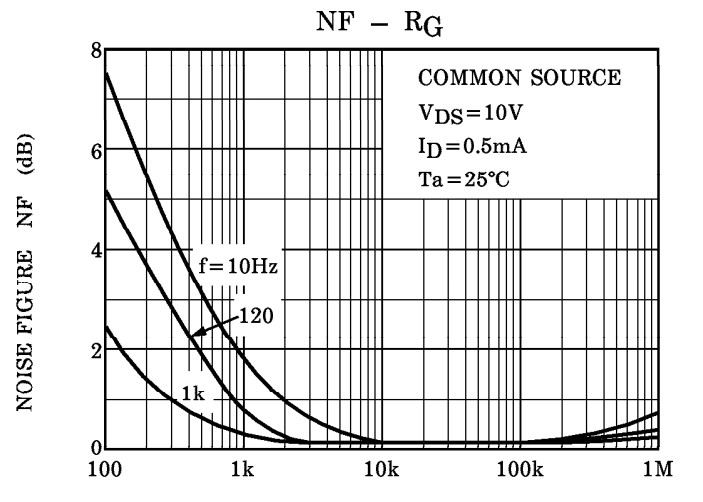

The noise figure vs. source resistance curves for the Toshiba j-fets show increasing noise for >100kOhm signal source resistance.
For increasing the gain of the second stage, does that mean I would be better off decreasing R14 than increasing R15 + R16 (numbers referring to the original schematic) since R16 is already 100kOhm?

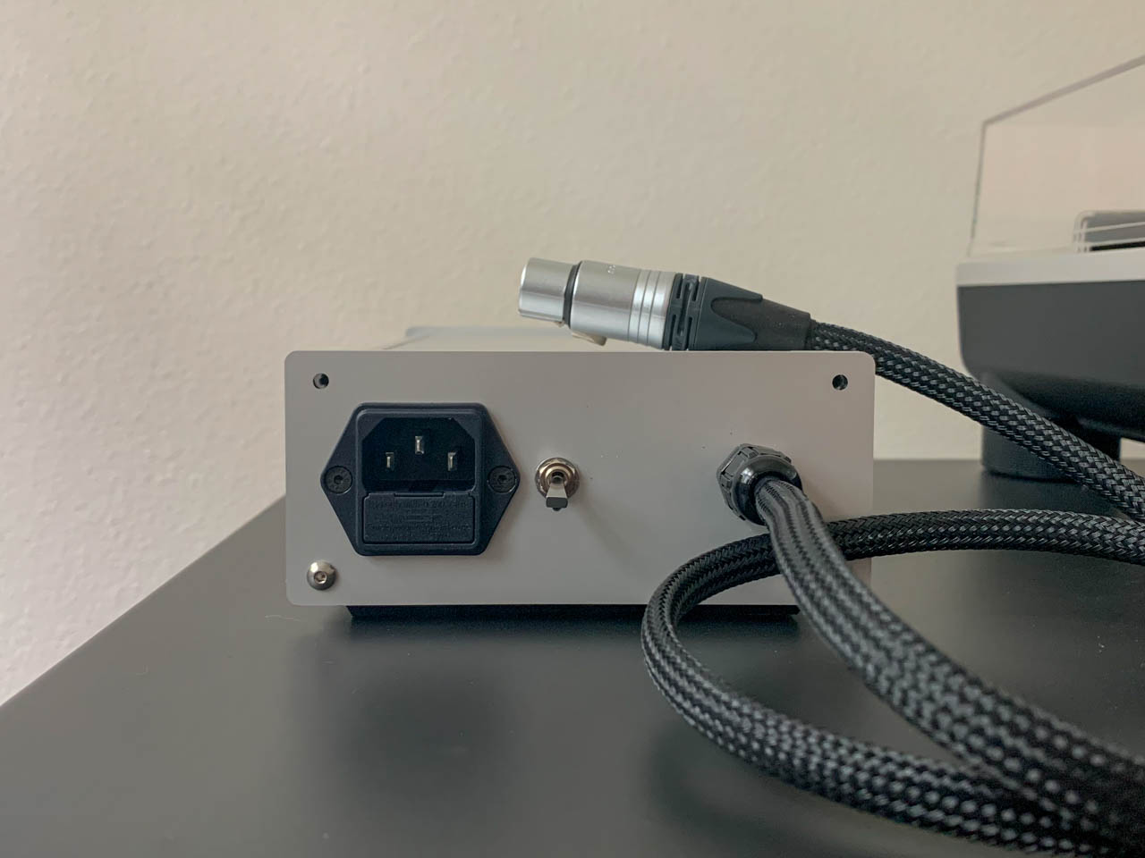

I wanted to ask you about how you secured your umbilical. You made that cable, right?
How does the "gland" you've used hold onto the braid and not collapse onto the internal wires? Is there an internal compression ring that grabs the braid?
Is there something similar at the connector end?
I guess I'm just asking, how'd you make that look so neat... and good?
itsikhefez- Great build. Very inspiring.
@itsikhefez
Yea the gland has some form of rubber that compresses as you tighten it. I tighten it until it holds both the braid and the wires. The main purpose (as I see it) is to provide strain relief in case the cable is pulled, to ensure the solder joint (or crimp) at the end of the wire isn't pulled.
The Neutrik connector end has similar strain relief as part of the connector.

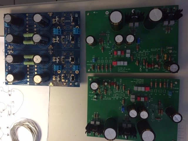

My build progress pictures..
Waiting from Par-Metal enclosures, same ones Jim used, but raw AL.
I left transistor stuffing for last. Decided to go with the PS board...It will take more real estate but it seemed practical

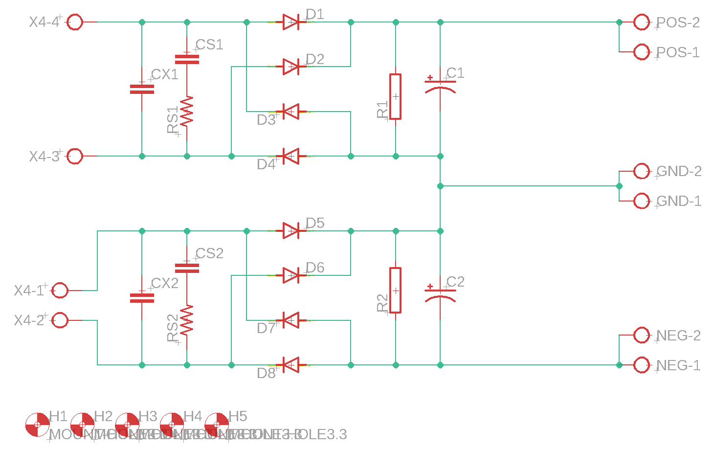

I thought of making this PCB for the Pearl PSU. The width is 98.5mm intended to slide into the Hammond 1455N2202 case and secured with a standoff in the center.
It can alternatively be mounted in a bigger case with the other mount holes.
8x TO-220 rectifiers, 2x 30d snap-in caps with bleeder resistors and CRC snubbers.
Any feedback?
Perhaps if you routed N$1 and N$6 on the red layer instead of the blue, you could double the width of all traces which connect diodes to trafo secondary windings.
Of course there's no need for wide traces to the snubbing components CXn, CSn, RSn since those traces conduct mere milliamps of HF noise, not a dozen amperes of DC.
